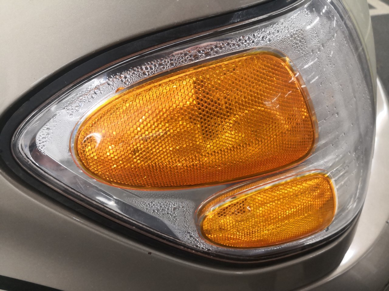

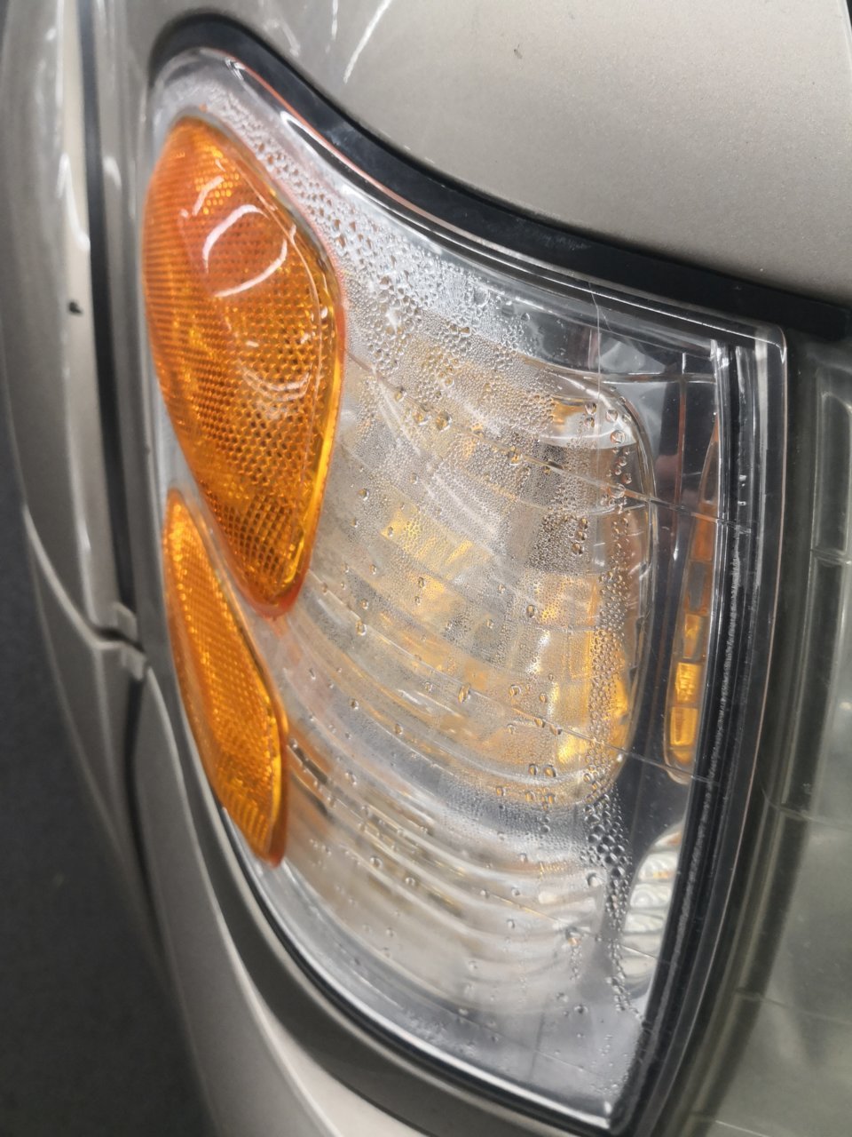

    The light bulb socket my passenger side doesn't have the protective rubber boot. Maybe that caused water to get into my blinker housing. Or I damaged the seal somehow after I pried it off to change out the bulbs. Yes, pried it. I'm not as smart as you guys. But it's not visibly damaged.
    More importantly, how do I get this moisture out?

    Take it apart and leave it in the sun, or the oven as low as it will go. Maybe a hairdryer would work?

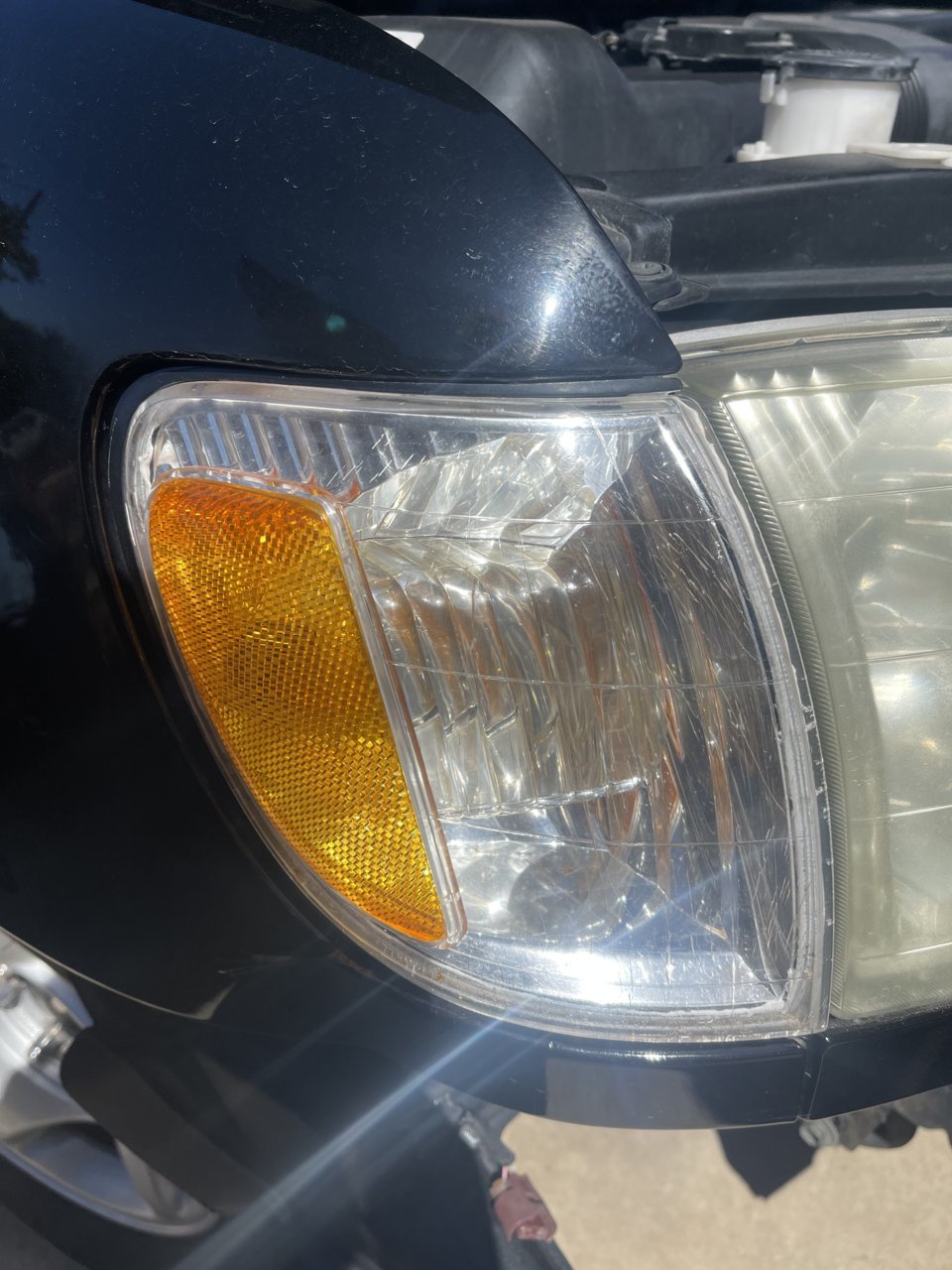

    The glue on my motorcycle light came apart @90*, but the tube of gorilla construction adhesive i had (probably over a year old) has held up well since the deer strike in sept (knocked the lens halfway off, but didnt break any of the mounts, and i peeled it off the rest of the way on an hot day). Before i reglued, it was nice to clean out all the amber lens film that had piled up. I polished on the inside housing, but it doesnt look any different than the driver side.
    i erred on the side of too much glue, and really only have squeeze out on the back corner.

    Had a condensation problem on a headlight on my '06. The real solution is to replace. My solution was to drill a 1/8" hole as close to the bottom as I could (on the back side of the unit, not the lens). It didn't help alleviate condensation more than a smidge, but prevented it collecting in a puddle inside the lens. I'm in North Texas, so YMMV.

    Had the same problem on my left front blinker housing a couple of years ago. I drilled four 1/16 inch holes along the bottom front for drainage and air flow. No problems with corrosion, discoloration, or other since. I believe the small holes prevents any substantial penetration of water, even when blasting from a water hose during washing. And the allowed air access keeps it dried out.
