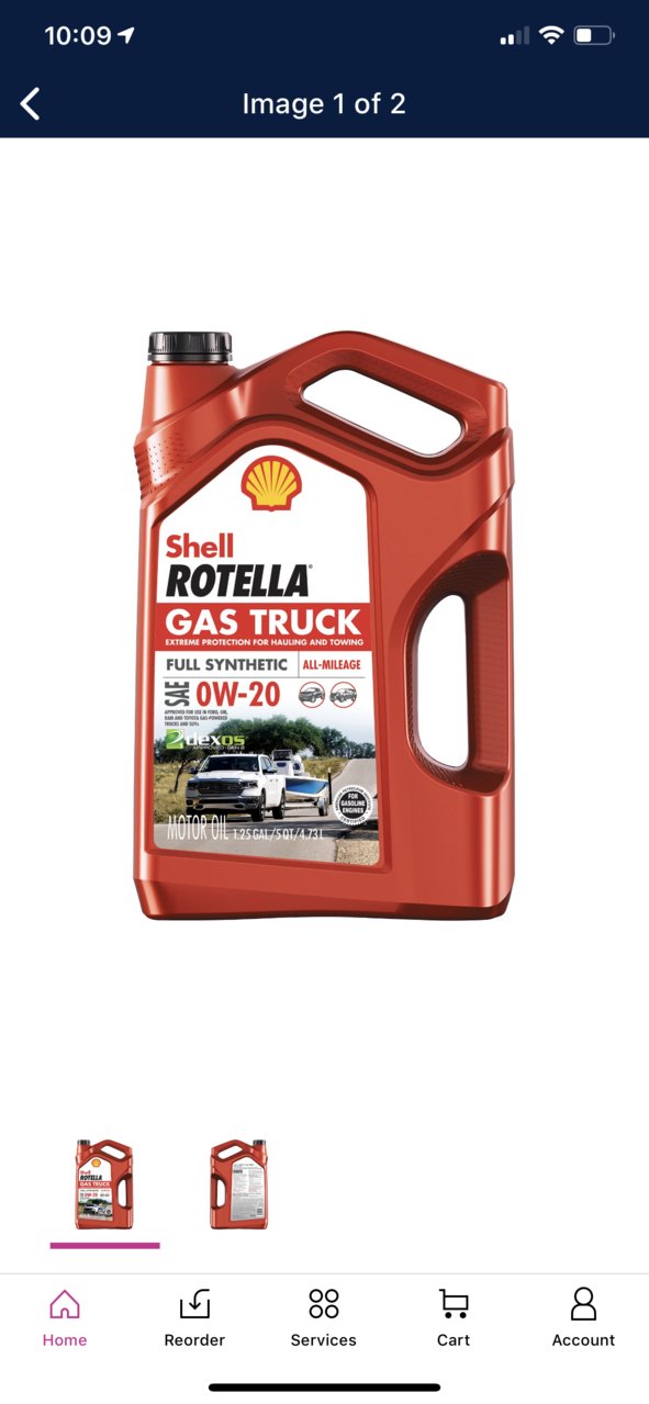

    Where I work now we have 8 DMC 1500 Denali that the project manager and Superintendents drive. We were using an oil distributor that was Mobil so we're using Mobil 1 and Delo in all our equipment. The guys and mechanics were saying the same thing that the trucks were loud. We switched recently to a Shell distributor so we are having Rotella for all the equipment and now brining the new Shell Rotella Gas Truck formulation in quart cases. The mechanic said it has eliminated any of the valve train noise on the ones he has done services in so far. Seems to be a thicker 0w-20.

    Shell is the parent company of Pennzoil and Quaker State. I'm betting it'll be a top shelf oil.
