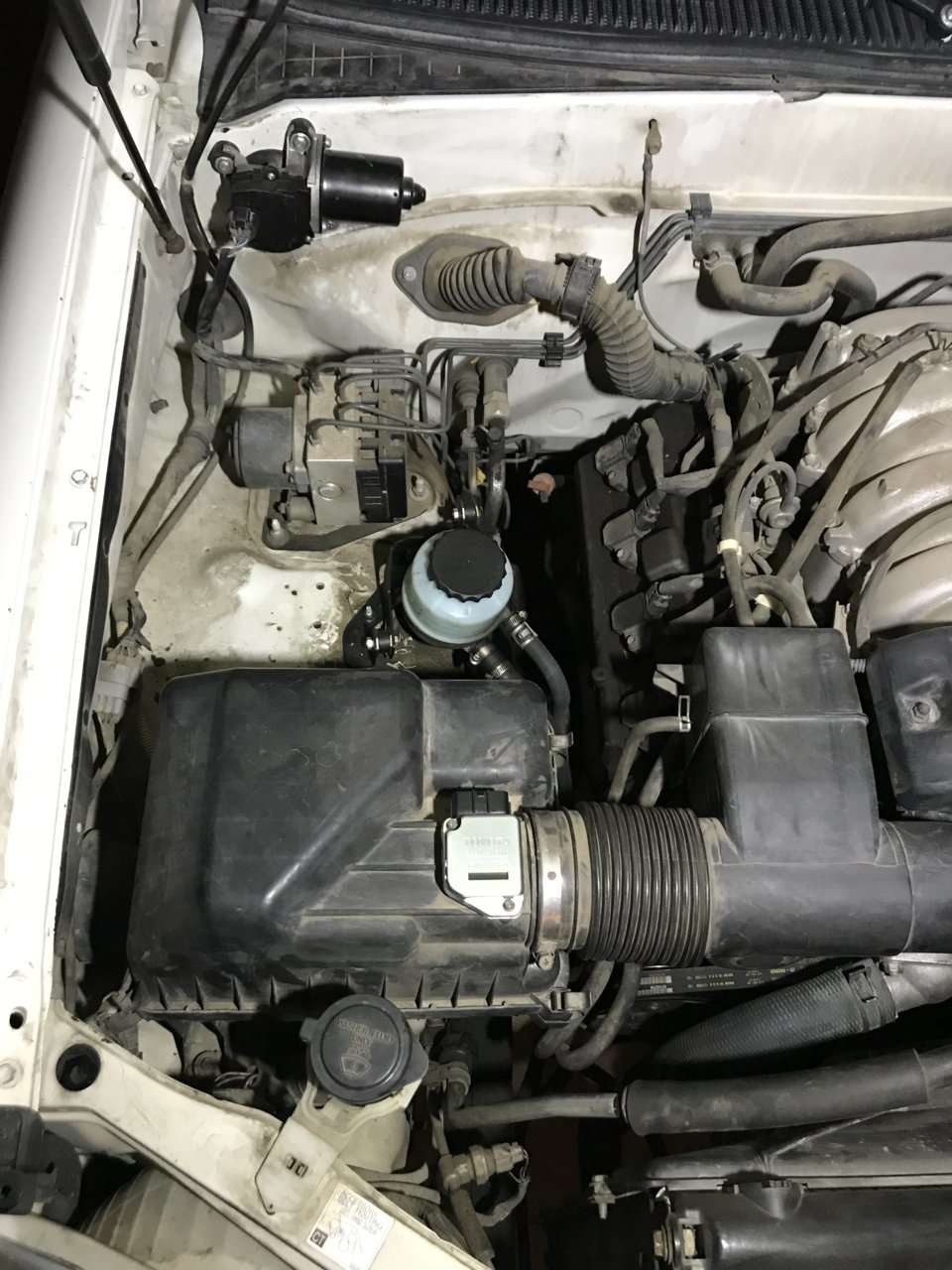

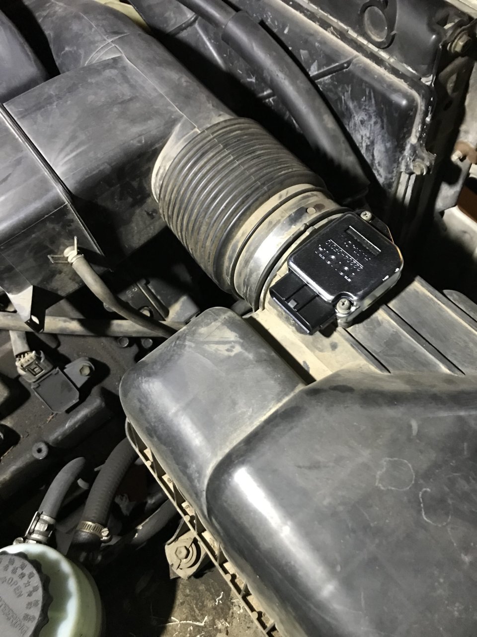

    Just swapped all 4 of my O-2 sensors and the check engine code tells me MAF. I lift the hood to see what’s up and the plug-in is nowhere to be found. Have no idea how this could’ve happened as I only recently started working on the truck myself. Wtf.

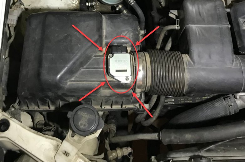

    See that box on the intake tube? Between the accordian section and the throttle body. Check under that. Thats where mine comes from.

    He has a MAF. Got nothing to plug into it......

    Again, not missing the actual sensor, missing the plug in harness for the sensor I believe.

    That MAF looks suspiciously shiny btw. Recently replaced?

    Ordered a new one before I popped the hood thinking it was simply the actual sensor that needed a swap. When I believe my issue is the missing plug-in, that I have yet to find tucked away anywhere.

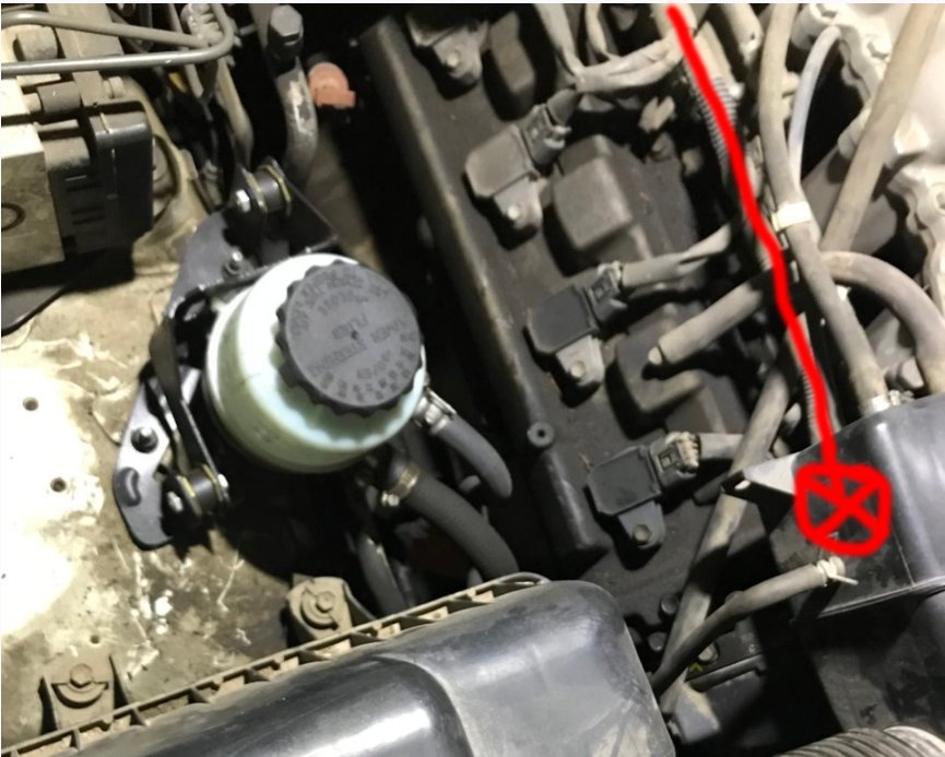

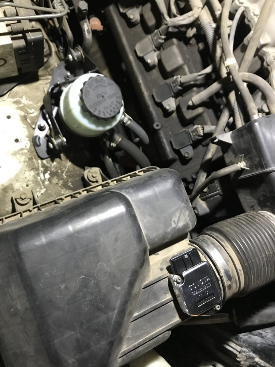

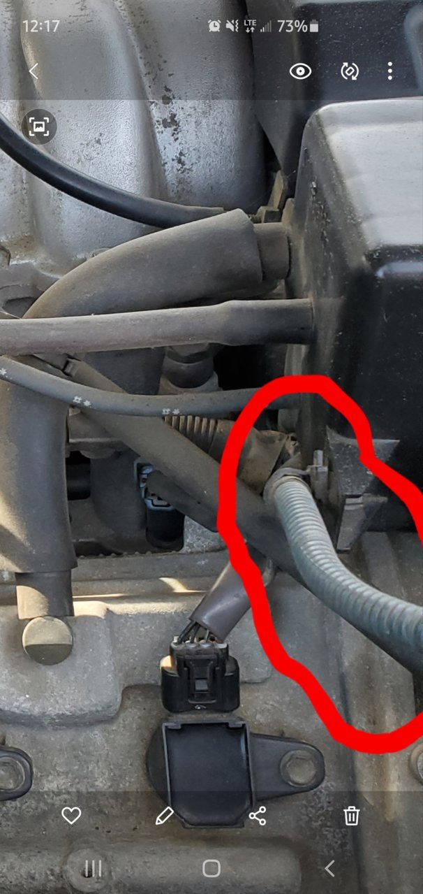

    These are from pictures I already had so not perfect. Looks like the harness goes down into another loom.

    It branches off this loom in your pic. The junction should be right where the X is under the air intake.
