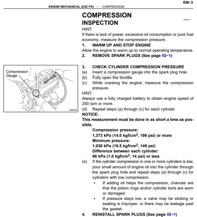

    not a mechanic but have always done how I was taught many years ago which matches the FSM.
