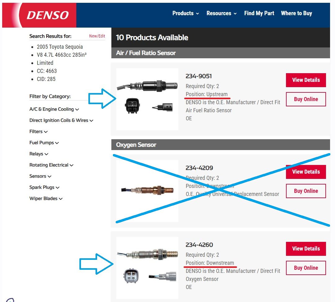

    Oh and here are your parts.
    After looking up the price on the upstream (link) I'll bet you the previous owner went non-OEM because $115/side is pretty hard to swallow. Downstream are much less (link).
    Interesting they went with a wideband O2 sensor on the front! I haven't seen that yet.
