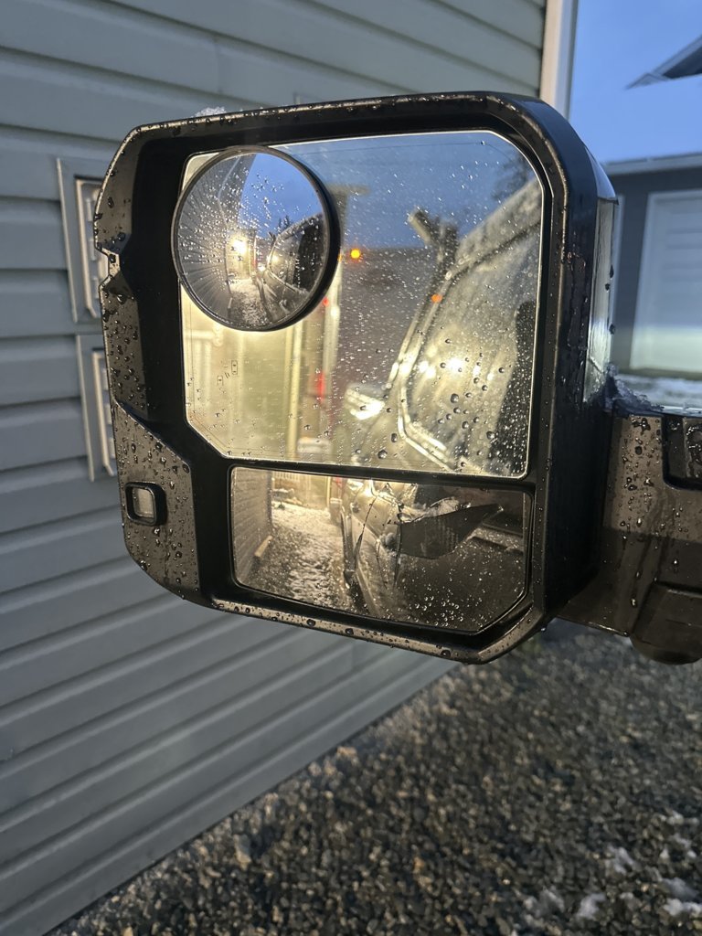

    Anyone have any experience that they can share with the lower glass blind spot replacement on the 23 tundra 1794 crewmax?

    What is the "lower glass blind spot replace"?
    Side view mirror?? If so, just push the glass all the way in toward the window, put fingers on outside edge & pull gently, it should pop right off. Then the new one snaps back on easily. You will have a couple wires to remove as well.

    Thank you Raven67. I will give it a try and see where it takes me. I have the two piece tow mirror, One upper that is power and lower is manual adjust for blind spot and wide view.
