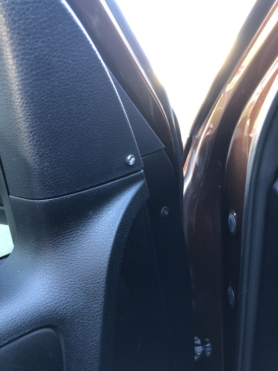

    There is a way to wire in led lights into the sail panels that will function as the bsm lights.
    I did it to mine and it works flawlessly.

    INTERESTING, thanks for the reply.
    yes when you get a chance let me know what is invloved.
    When I turn my BSM switch on, an error message comes up , so it wont currently work.
    is this because the circuit isnt being completed, and the system knows nothing is pluged into that specific jack??

    Yes that’s exactly what it is. The light in the mirror completes the circuit.
    The led mounted in the sail panel takes its place.
