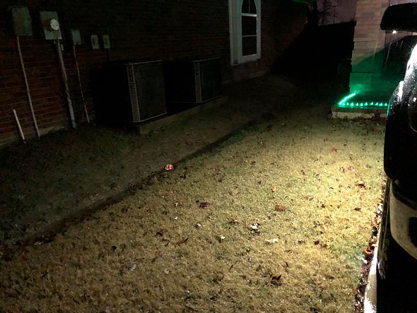

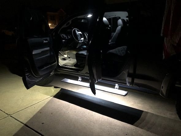

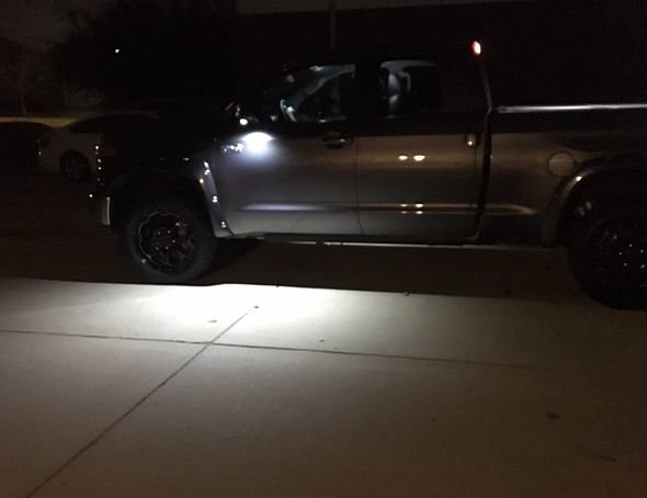

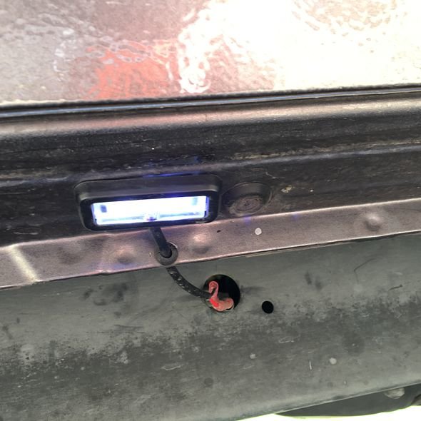

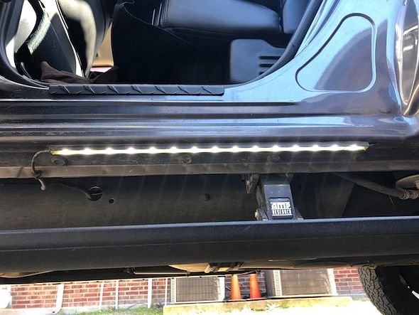

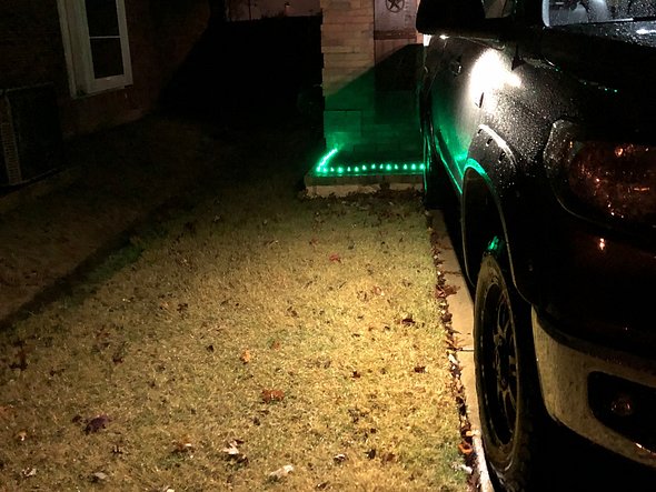

    NO reason not to do this simple upgrade yourself.
    No way I'd pay anyone to do it.
    It is as simple as pulling the door panel, removing the mirror, running the wiring, cutting a hole in the bottom of the mirror, tapping into the tiny floorboard light circut, testing it, and reassembling it.
    If one is worried about triggering an airbag, disconnect the battery before installation.
    521f063b-30b2-473a-84e6-3b6ef870408f_a86442fb6c65a1b8805f5603684729ccf980d952.pngd086a233-6161-4d98-8d48-1594640a213b_060df6b8e24cec515eafdeac7458a2a96d9bb486.png
    The tiny lights that came with my AMP steps were quickly replaced with something usable.
    Perhaps they gave you different lights.
    I replaced them with metal 12" LED bars painted to match..
    I've since removed my AMP steps, got tired of replacing parts.
    VLEDs is the way to go.
    I first tried some other LEDS and none were as bright as VLED.
    Coljohnson09[OP] and JMGmanAZ like this.
