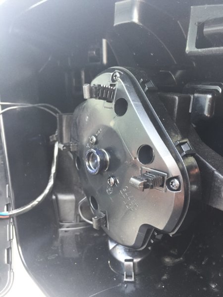

    Mirror side
  5. Mar 6, 2017 at 7:13 AM

    Looks to me like the glass separated from the base that it is glued to.
    Got a picture of just the back side of the glass?

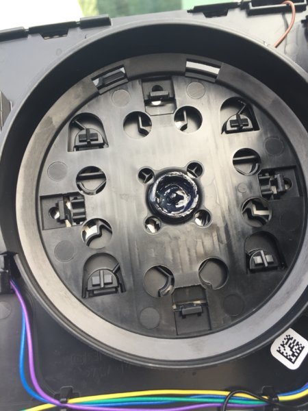

    The first picture is the back of the lens. It is two pieces of plastic that are separated.

    Well, crisis averted. I went home for lunch, and after realizing that glue and other adhesives on hand were not up for a quick fix, I started trying to see if something on the bracket would grab and hold. I guess I hit a new position because with less pressure than earlier the mirror clicked into place. I adjusted it a few times and that worked. Hopefully it is fixed and will still be attached after a few potholes.
