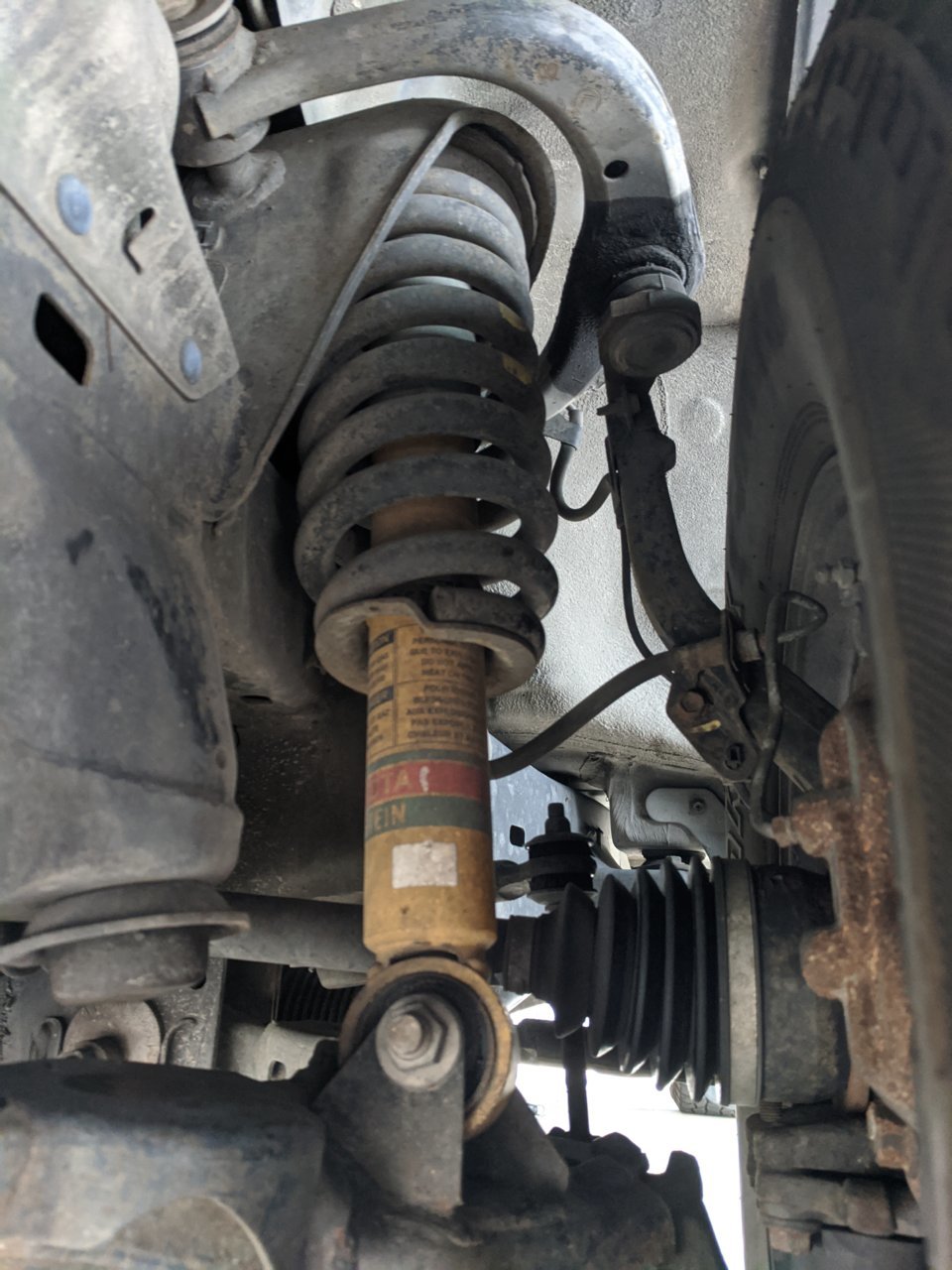

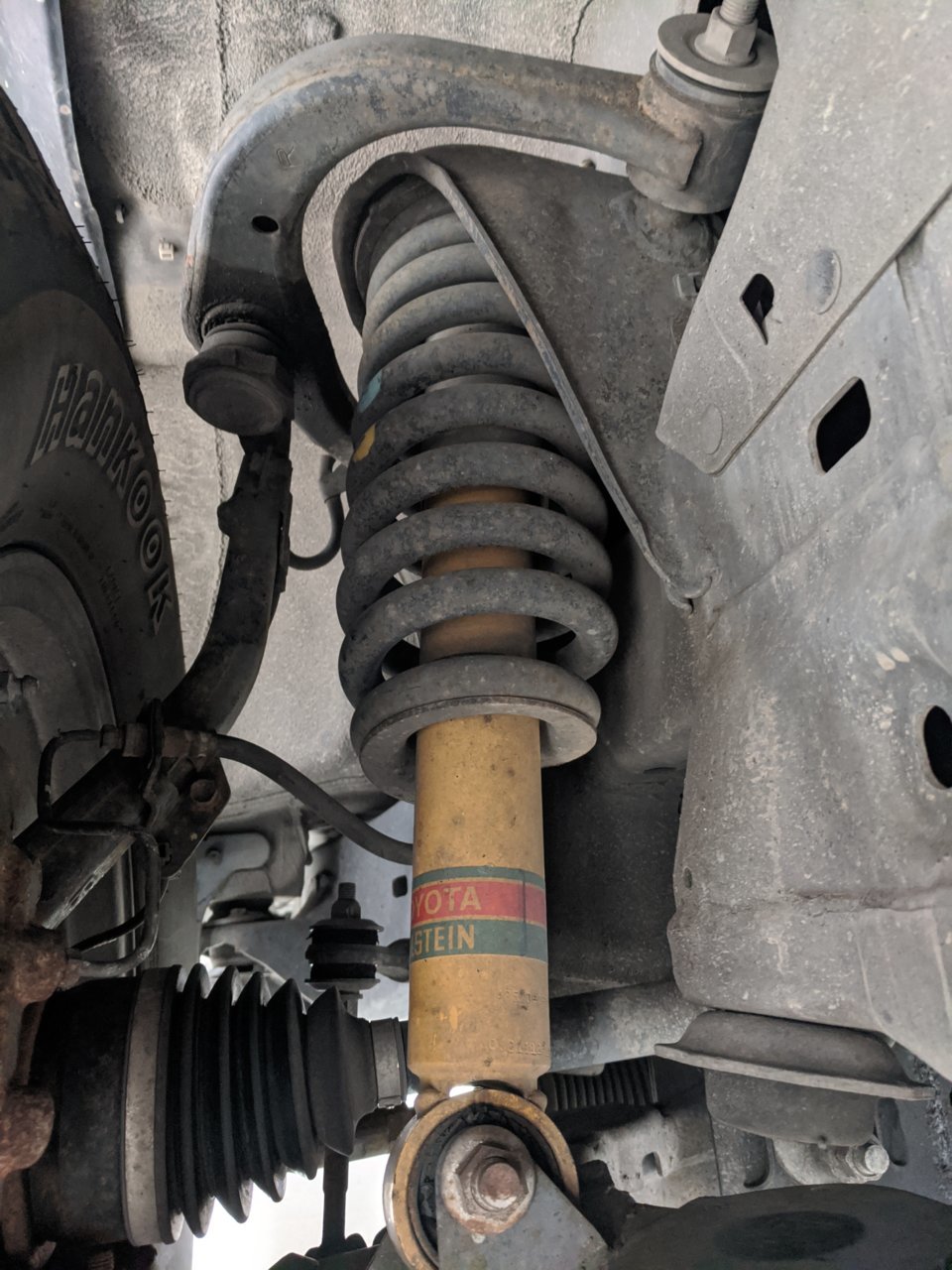

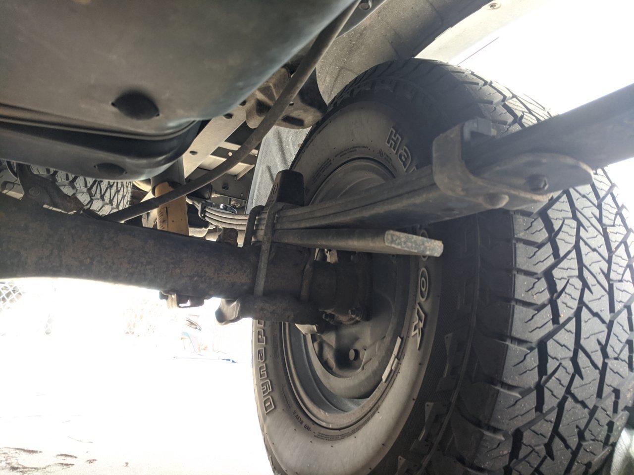

    Mainly camping and off-roading to get to camp spots and fishing spots.Nothing crazy as far as off-roading goes. I'm not sure what to look for regarding the condition of the coils and leafs. I took some photos for you.
    IMG_20211129_145332.jpg IMG_20211129_145311.jpg IMG_20211129_145142.jpg IMG_20211129_145159.jpg

    Heh. That one shock bushing is fecked.
    But really cool you got the OEM Bilsteins on there.

    Coils and leafs look to be in really good shape! For lift options I'd go with new bilstein 5100s up front. They have a little clip on them you can adjust at the time of install to get a higher ride height. Rear Bilstein 5100 and an add a leaf either the 3 piece or a one piece. I'd recommend leaving the overload leaf in to get the full 1.5 lift they advertise.
    Don't know if you've looked around much, but parts are backordered most places right now so you may be waiting a bit

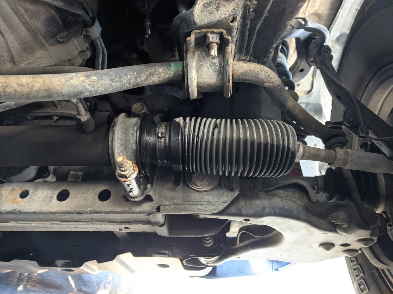

    Meh. Open it up, clean it out, let it dry and see if it does it again fairly quickly or not. Might just be a while of accumulation. At least that's how I'd treat it initially.
    You can use thin zip ties to put the cover back on without the band.

    Toyota racks are expensive ($500) but solid. Reman rack reviews are very hit and miss. Detroit axle makes on that is surprisingly inexpensive, some last years others blow up as soon as you pull it out of the box.

    Thanks for the advice. I'm having my mechanic diagnose the problem as I type this. I'm planning on fixing it but I need to know what to fix first.

    Do you think I'll have to replace the entire rack like my neighbor said? He made it seem like it's something I probably shouldn't do alone. If I have a mechanic do it, what kind of $$ am I looking at?

    Yeah, the rack's not serviceable. I think labor is about $500 depending on where you live. I haven't replaced a rack, but I replaced the bushings on the rack, it's not easy, but not terrible. You could do the rack yourself, the tricky part from what I've seen is keeping the rack aligned and bleeding the power steering fluid.
    There's lots of YouTube videos on it, watch a few and see if you think it's something you can/want to tackle.
    If you do replace the rack, might as well get new inner and outer tire rod ends. I used Moog and they've been fine for the year I've had them in.
    You'll need an alignment after the work.

    Welcome to the community! Check to make sure the bolts on the valve covers are torqued appropriately as there could be engine oil leaking from there as was the case in my scenario. If not, next I would consider removing the dust boot and inspecting the seal. The metal clamps (90080-46271 and 90080-46272) for the dust boots are cheap enough to replace.
    If the leak is coming from the steering rack seal and is extremely minor I wouldn't be immediately too concerned as long as you monitor the reservoir's fluid level and keep a bottle of ATF in the truck.
    A quick search reveals numerous threads on this topic one of which includes PDFs on how to disassemble and reassemble.
    tundra steering rack leak 00-06
    Replacement seals are affordable if you have the time and confidence to replace them with OEM vs buying an entirely new rack assembly or paying someone else to rebuild.
    https://www.toyotapartsdeal.com/pag...ng_gear_link&diagram=&partNumbers=&pnc=45536A
    Keep us posted!

    Mine's had a slow leak going on 7 years now. Hasn't really gotten much worse unless I'm turning a lot in a parking lot.
