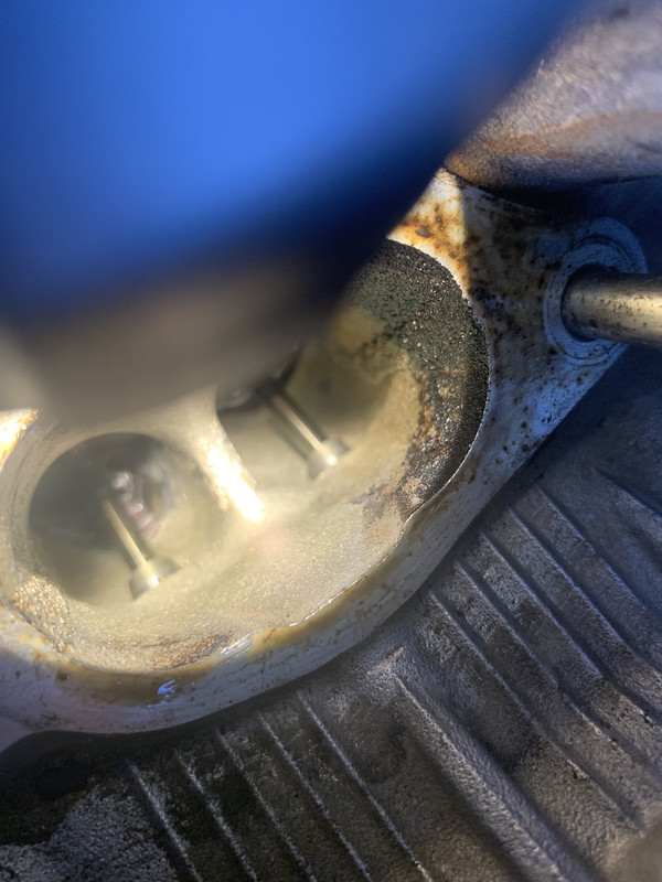

    I dropped a nut in my value and drove it for 2 days hahahahaha, then it started to misfire. It was just bouncing around in there till it finally got wedged. It was so hard to remove. in luckily I just pulled it out and nothing happened
