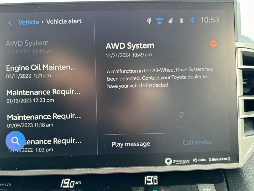

    I drive mine a ton in 4H for winter driving mostly because of icy roads and bad intersection. I’ve ran into some trouble switching into 4H while on ice and I had a malfunction come up but once I parked the truck and came back to it nothing was wrong with it. I do love ripping in the snow go to 4H then MTS and choose sand function it’s like a different truck completely. IMG_7966.jpg

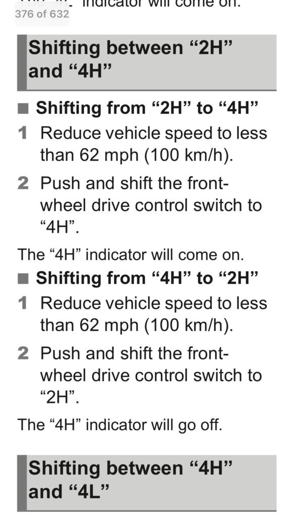

    Is there a speed max that you can drive in 4H?

    I think it's 55 mph max.
    When switching between 2-4. Do ya leave truck in drive and switch between the two? Or go back to park?

    If you need 4Hi, max speed should not be a concern. If you can safely drive 60 mph, then you don't need 4Hi.

    Not certain for the 3rd gens, but previous gen just has a speed restriction on shifting in and out of 4H. However, if the conditions warrant 4WD it'd be pretty stupid to go blasting around at much over 50-55. 4 wheel drive does not mean 4 wheel stop.

    You can switch between 2WD and 4Hi on the fly, but you have to be stationary to go into/out of 4Lo.
