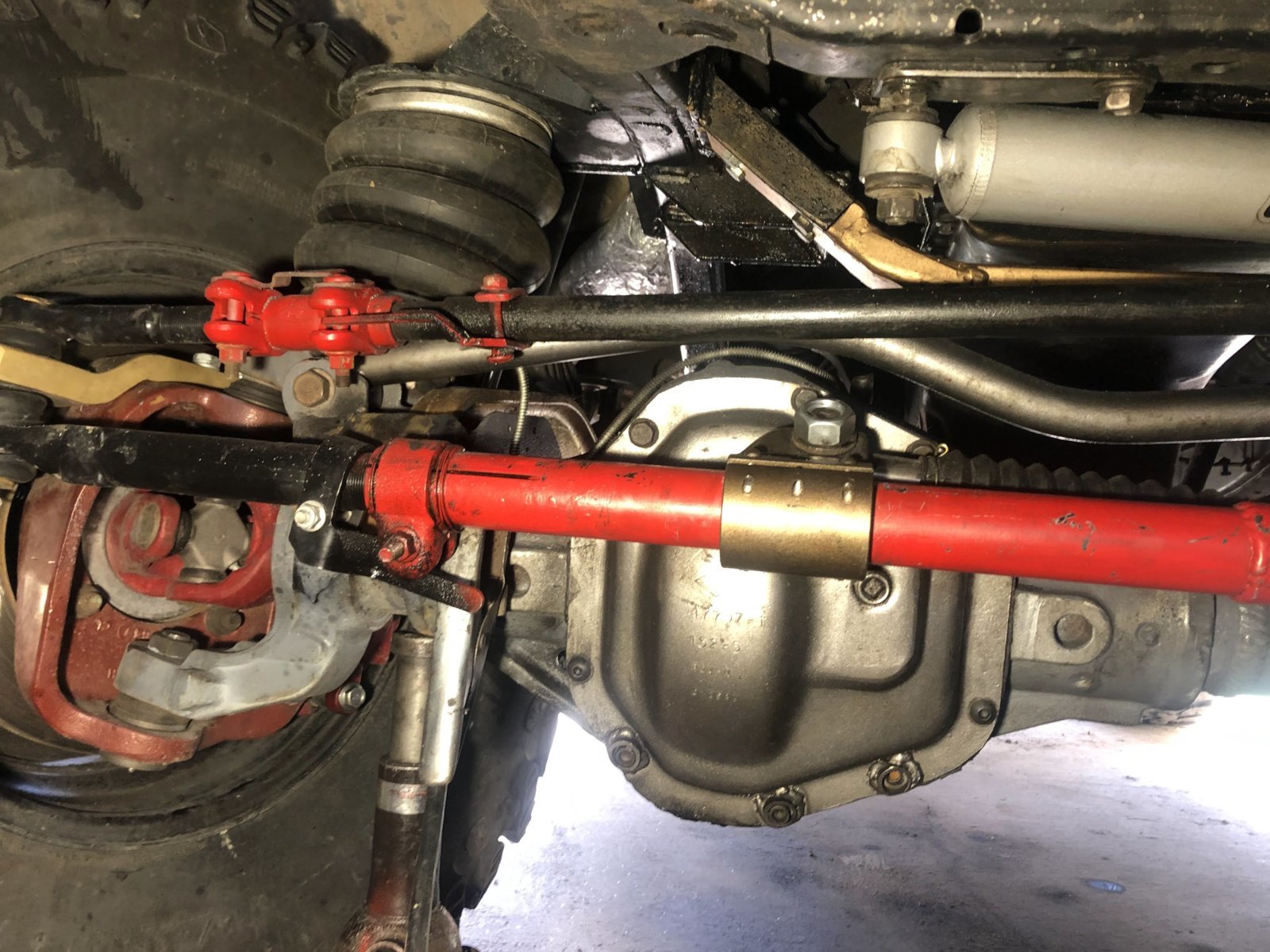

    Here's some pics of the FJ80 I had. Front SD D60, rear 14B disc brake, I feel like I been down the solid axle path for a while and want to f__k with some IFS parts for a bit:
    @snivilous thanks for the input! I think your right about keeping it simple for a bit first. I have some ebay UCA's and spacers for the front, maybe Ill order some HD deaver leaves next month and just play with that for now.
