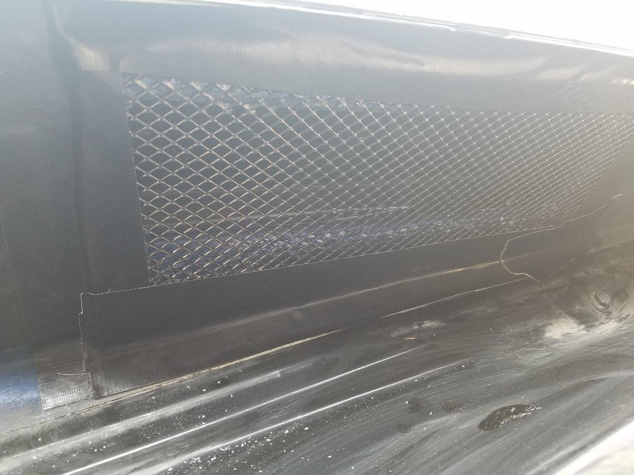

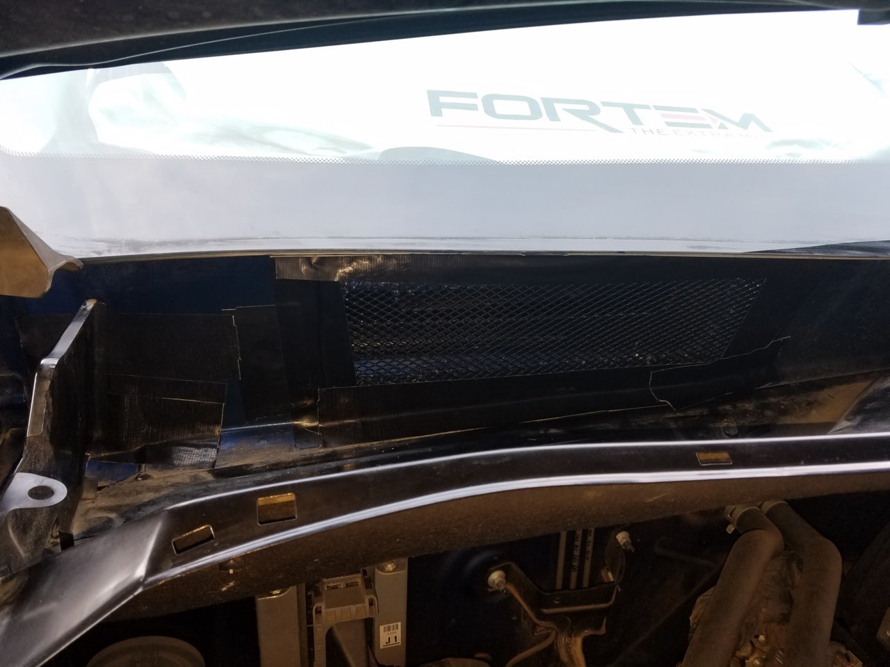

    You can pull off the wiper cowl on passeger side and throw some gutter-guard on the opening for "fresh" air...I had the same issue too many times in a row and installed it...took all of 30 min...I also put a few drops of peppermint or lavender oil on the cabin filter...which is located in the glove box...these are the only photos I have...haven't had an issue since the gutter-guard FWIW
