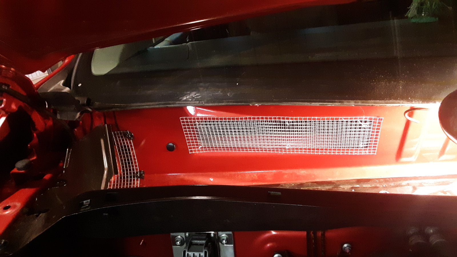

    20220506_094712.jpg Through your cowl vent. Many of us have added screens to prevent entry.

    There's a hole on the driver's side, too. See this thread for details on what some of us have done to keep those bastages out.

    That’s scary! This just happened three days ago l don’t think it is that bad. I installed the metal mesh, put four mice traps last night and didn’t catch any
