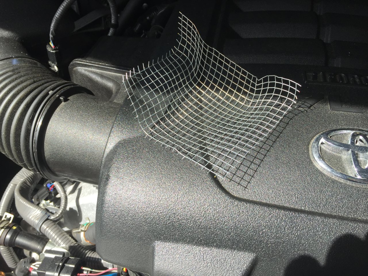

    Hi team - I was swapping out air filters the other day and found the beginnings of a mouse nest under one of the air filters. Anyone have any tricks on keeping these suckers out of the air intake?
    my initial thought is to rig up a barrier with some 1/4 inch hardware cloth that would essentially sit within the air filters housing but wasn’t sure if a) that will cause issues in that particular location or b) would actually work.
    appreciate any thoughts and feedback!

    I've seen people used hardware cloth and worked for them.

    Did mine last year and have no problems since. Just press the wire to conform to the area, then form a line of silicone around the area and press into place. :thumbsup:
