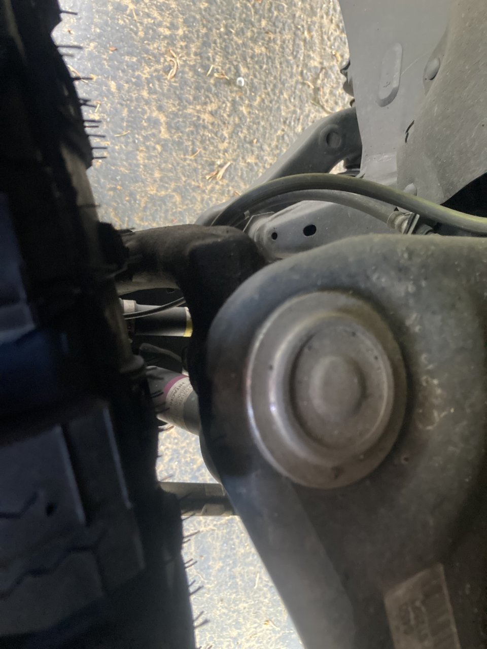

    Interested in the clearance as well.

    I do, I'll post one when the sun comes up. No clearance issues with 3" lift and total chaos UCAs.

    Any pictures?

    Nothing on my end for proof, but I’d think you might clear OEM UCAs with the +35mm offset. That’s an inch more than your factory wheels, ish. The width is 1/2” wider overall, so maybe a little under an inch difference behind the wheel. Should be 3/4” more room.

    I run 315/70r17 (35x12.5r17 equivalent) with 50mm offset wheels (on both oem stock uca and total chaos ucas later) so you should be good to go with 35mm, which is likely the best offset for this generation.
