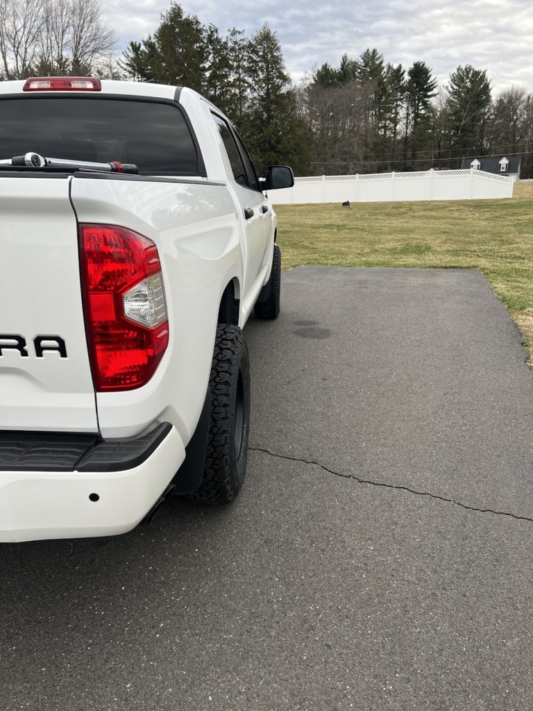

    These will fit your truck with stock size tires but you may still have to pull your front mud flaps for clearance. I did 0 offsets with 285/70/17's at first and they rubbed even with a 2.5" front lift. Had to pull mud flaps and push plastic back at the front of the wheel well. Then your good to go with a 33" tire. Best of luck!

    • Here’s a side shot with the above tires and wheels for reference.67036770992__9BBE7E3C-A26F-4C52-AA2E-BAA4B8CB71D7.jpg
