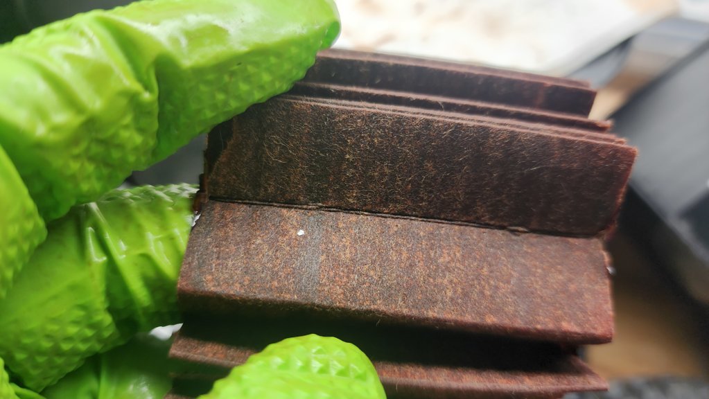

    So how much is too much metal in the oil filter? I just cut open the filter from my 5k oil change and found a few metal specs in there. I have never examined a filter so I’m not even sure if this is normal.

    First change? Totally normal for every engine after break in. You’ll find almost nothing at 10K and should be nothing ever after that. Many here have shown much more significant “glitter” and small fleck shavings than what you have. Specially in the bottom of their oil drain pans. Some where even on their 2nd and 3rd oil changes.

    Yep. Looks like a good one to me. If you still have it, rub a clean magnet over the pleats. Betting that comes out pretty clean.

    That's pretty clean!

    At my recent 5K: I had 2 "significant" sized specks similar to yours, but considerably more micro-glitter.
    I'm waiting on Blackstone results also. Also did my 1st at 1K but didn't do analysis on that one.
    Not worried about mine and I absolutely wouldn't worry about yours.

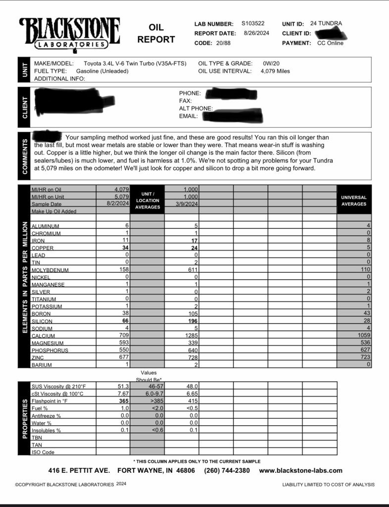

    FYI here is my report

    Your 5K #'s are VERY close to mine, and I had a fair amount more micro-glitter showing in the filter pleats.

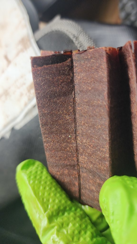

    30k and still pulling flakes this size

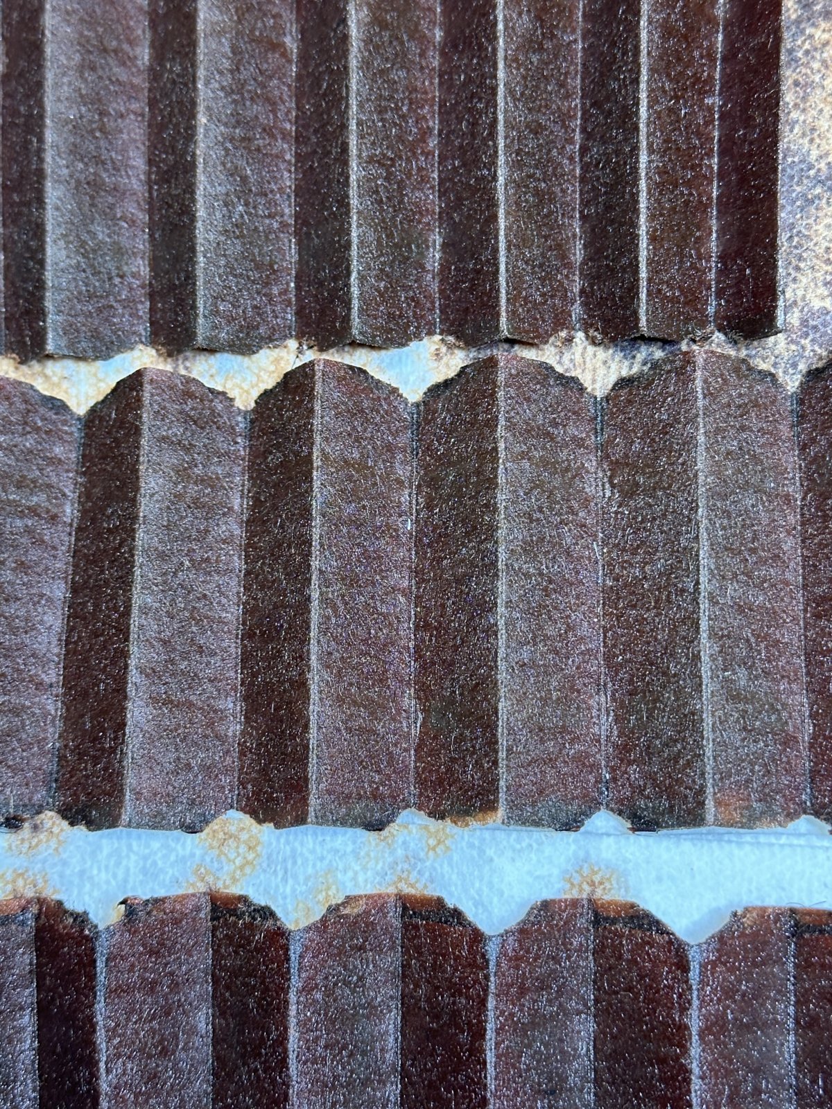

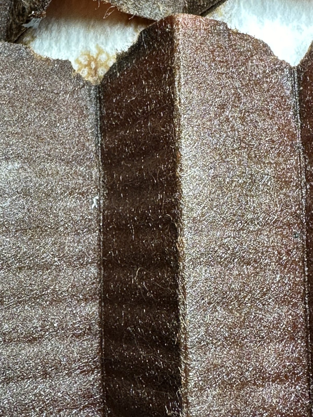

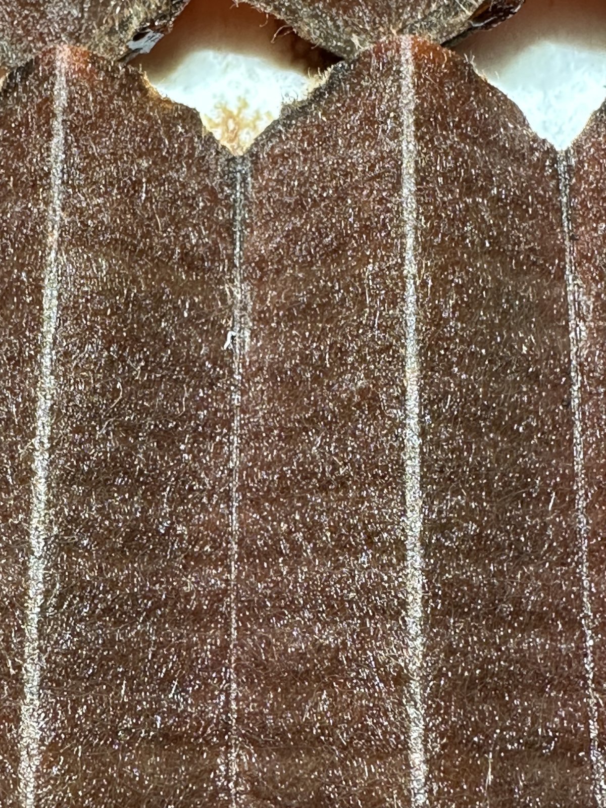

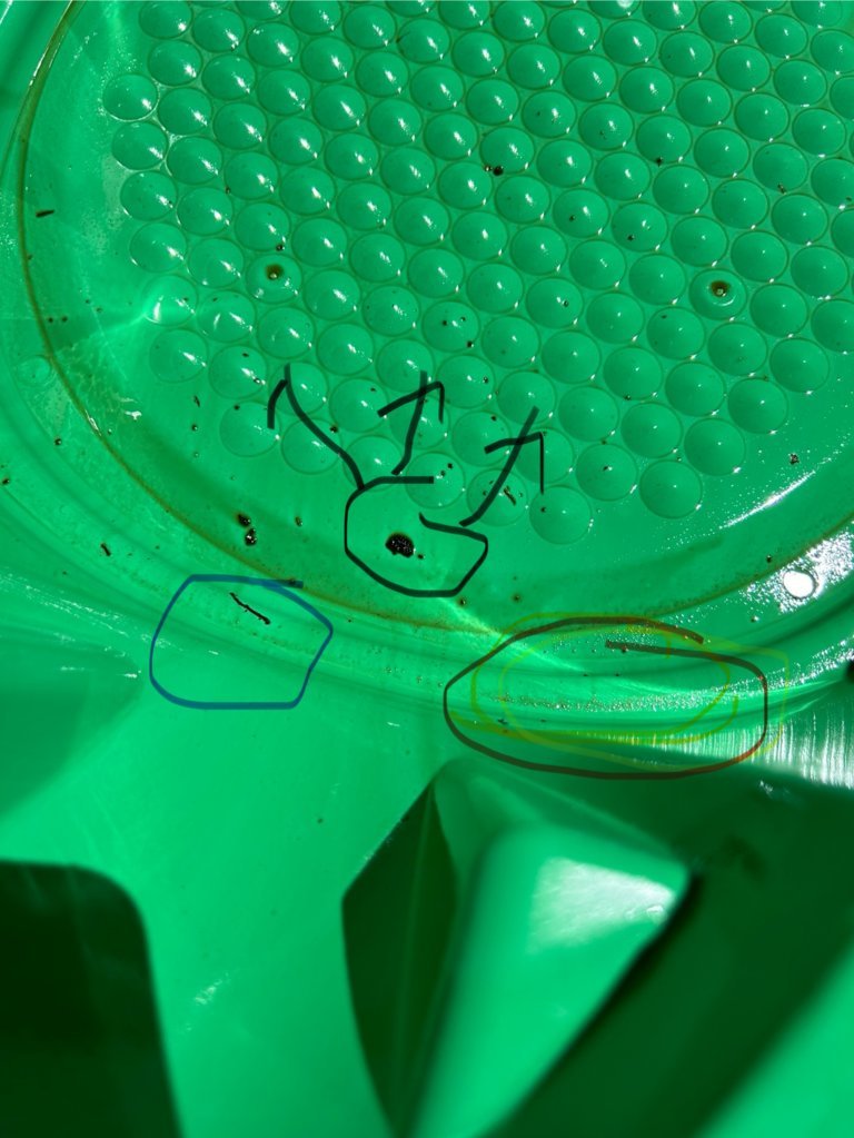

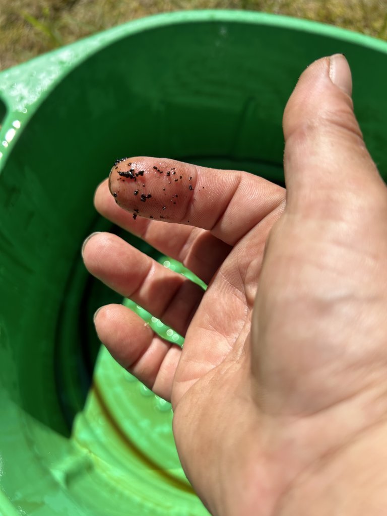

    I just did my first oil change at 3750 miles. 4/24 build date.
    WTF is this!?
    I don’t think it’s metallic. Then, did a baby chipmunk shit in there(blue circle)?
    Zoom you can see a very little and very fine ‘forbidden glitter’(yellow circle). So if the chipmunk shit and gritty stuff is somehow normal/expected from manufacturering the glitter isn’t bad.
    A filter opener will be here tomorrow and I took a sample. I’ll report back on both of those.

    Had the same stuff in my 10/23 build 2024 model. You might get two or three oil changes with that silica or silicon based goo. I had metal flakes and bits and that black stuff.I did a early oil change last week the 4th one less trash but a few flakes and bits in my oil filter at 7800 miles. The first time I had anything in my filter was at 7800 miles go figure.

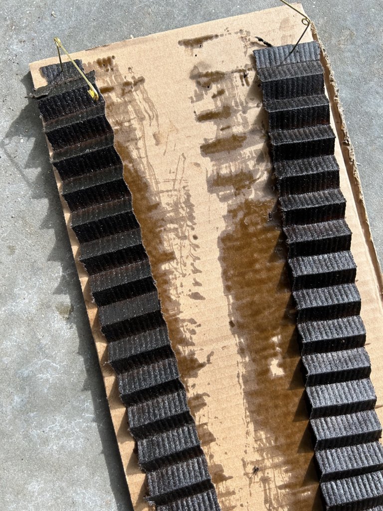

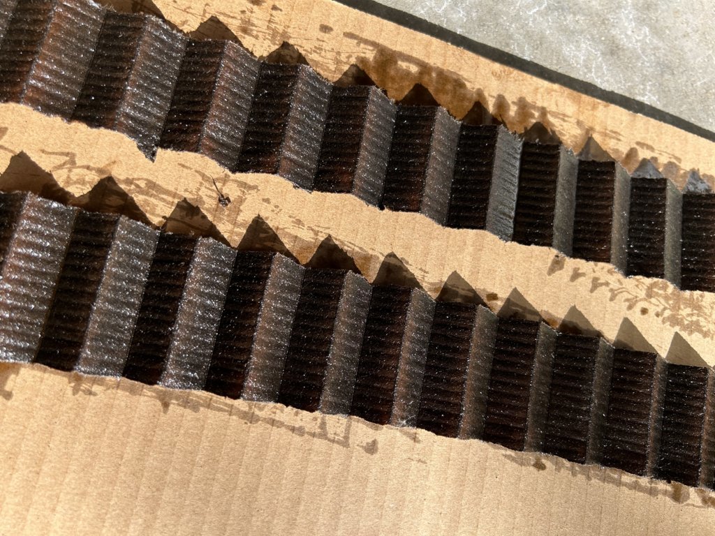

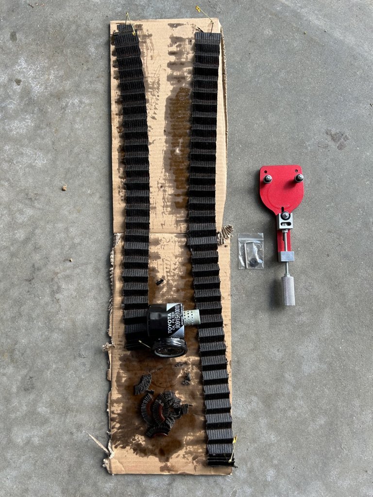

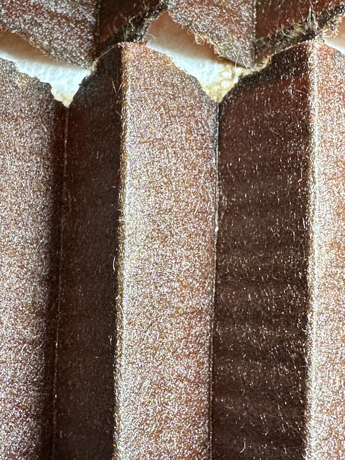

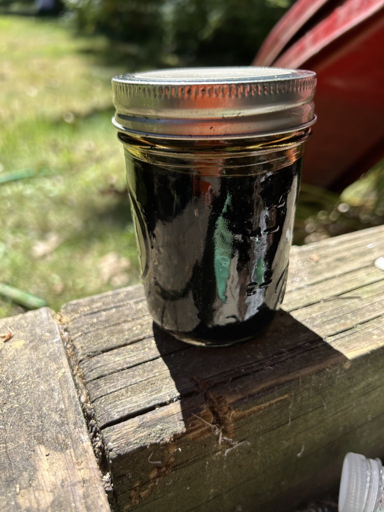

    The opener was in the mailbox so surgery ensued.
    It looks really good, I can see a few super fine specs. First pic is the inside of filter. Second pics is outside of filter. Last pic is from the oil that was in the filter.
    Maple Syrup anyone? (Don’t tell wife I used her jar)

    Probably assembly lube. Most first changes result is high moly ppm
