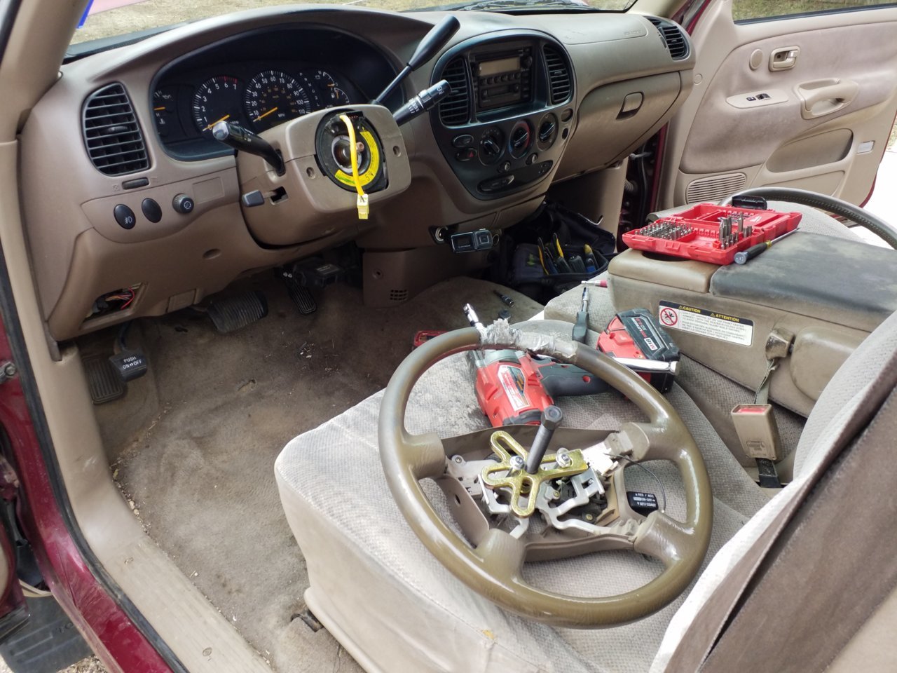

    I’ll open up the portion behind the steering wheel this weekend to see if I pin point where the click comes from.

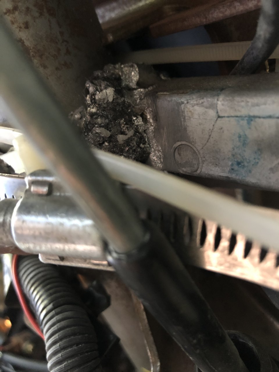

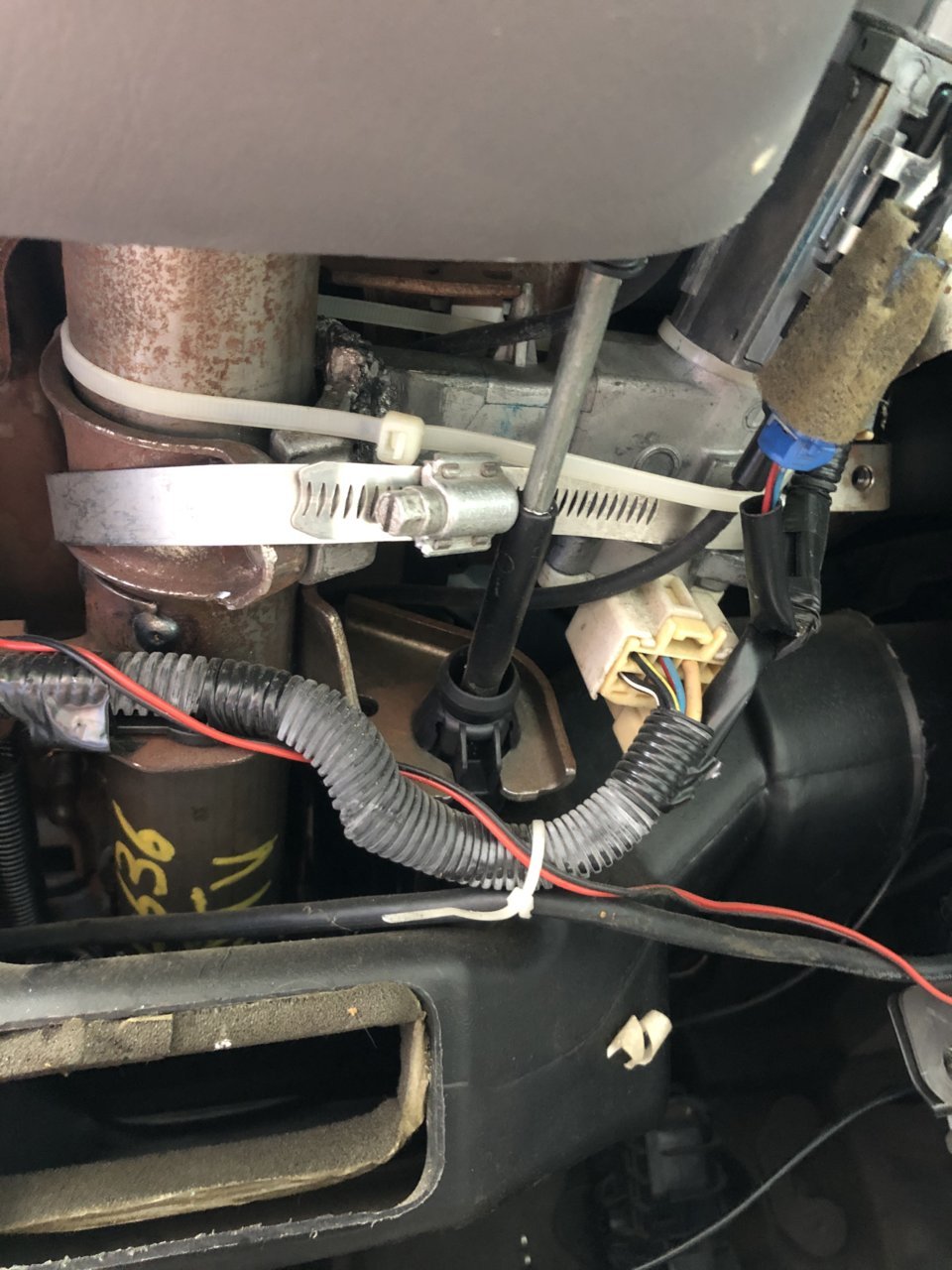

    Found the source. This piece is loose. Not sure about where it goes but guessing it shouldn’t just be dangling on the steering shaft...
    Anyone know what the part is or how I can go about learning how to fix it?

    you need a whole new steering column.. someone threw a different column in and cut the key shit off and band clamped the old one on.. WTF

    They also tried to weld?... or possibly soldered it?...

    yea.. time to go to a junkyard for a whole column THAT HAS ITS KEY. swap the key cylinders and be back in business with a not jury rigged setup

    You can but you have to drill out the old one time use bolts either way, the column is being removed. I would replace the whole thing honestly out of fear there’s an different issue that caused this fuckery in the first place

    How long have you owned tis truck? To the right of those "welds" it looks like stress cracks on that crossmember not sure what that piece is called.
