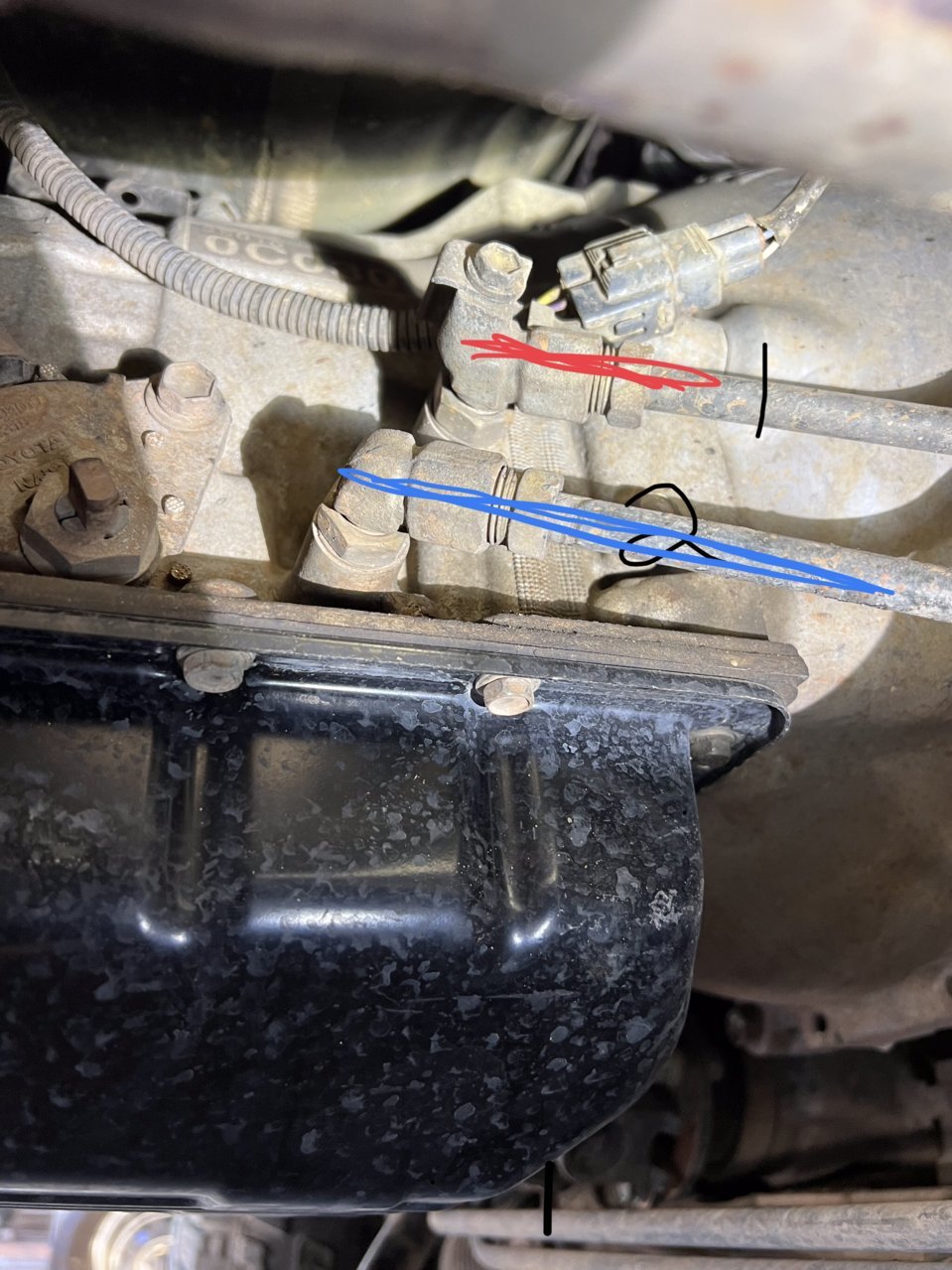

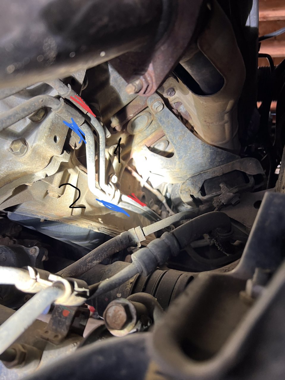

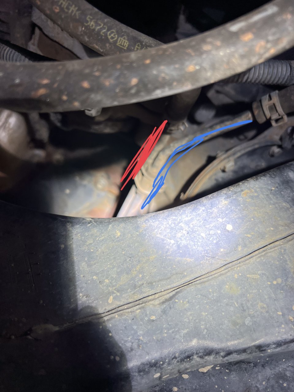

    Hey Guys great resource here . My 06AC 4x did the same as norcalyotaman. Saw some good videos on y tube. Most reference a bipass to drain all AT fluids. My truck doesn’t seem to have that. I see the hoses all the way to the radiator and cooler then back to the transmission. Top hose goes to cooler. Bottom line goes to the radiator. I think if I can figure the direction of the fluid I can pull one of the hoses after the cooler. I’ll post pictures from my laptop in a few minutes.

    Hey @shifty` Im newer here. I have seen you hit up in a bunch of posts. you seem to be a person of immense knowledge. Any help or direction would be truly appreciated.

    '05-'06 have a sealed transmission. Are you looking to drain, fill, flush, or what?

    I might be dumb, maybe it's the meds or the fact I may be dying right now, but I'm not following. Is it just a question of what direction the fluid is going? Or did he take his lines off and can't figure out which goes to which? That's kinda where I'm lost here.
    It's also my understanding these circled connections are where the trans passes fluid through the radiator for cooling; when these seals go out, this is how folks end up with pink milkshake and dead transmissions from not changing out their radiator. I'm not sure what the red-marked line is, though, unless OP has the extra trans cooler w/tow pkg in front, smaller finned in front of the radiator/condensor, and that's bypassing up to that cooler:
