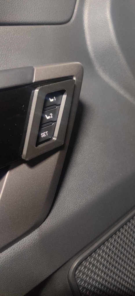

    Hey Everyone! I'm new to the group and just got a 2025 Limited. Love it! First Toyota truck ever owned. Wish I would gotten one long time ago!
    Only issue and seeing if other have the same problem, every time I drive, my left knee keeps hitting the memory seat button! Drives me nuts! lol Anyone else have this problem too? I am an engineer by trade and thinking of 3d printing a little cover to prevent my knee constantly hitting those damn buttons. :monocle:

    When I'm driving constantly hitting them with my knee and it beeps. I'm not huge guy or something. My knee lines up perfectly with those buttons. I wear jeans alot its like the fold of the jeans at the knee acts like a finger.

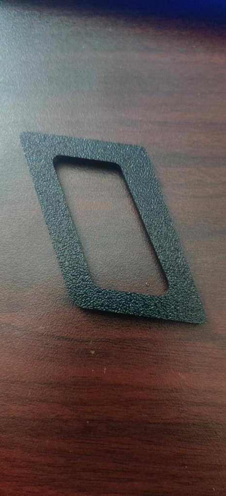

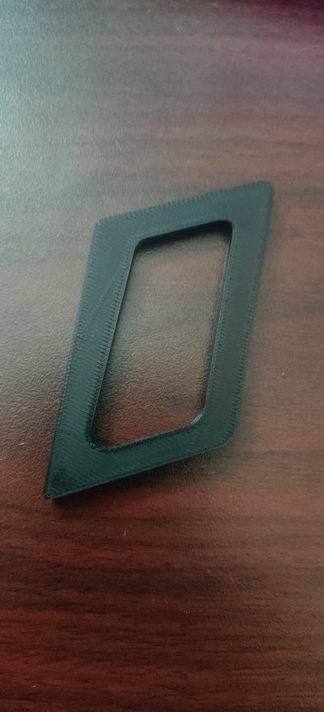

    I've been having the same issue ever since purchasing my 2025 Tundra. My driving position makes it so my knee is sitting right on top of the memory buttons. I programmed both settings to my drive position so my seat doesn't change positions when I hit the buttons with my knee while driving.
    To combat this issue, I designed a plate that bezels around the buttons. I didn't want to design a cover though but I have to say that it still works. Measurements are not perfect as this was a quick design. I 3D printed the design and just superglued the frame onto the panel. Thickness of print is approximately 5mm.
    Things to note: I used a textured plate so the frame prints out with the textured face shown outwards. If you want the smoother side to be shown, I recommend flipping the design. Sorry I was too lazy to flip it in the file. Better yet, just use a smooth plate.
    Please reference the pictures and stl file.

    love it! Great idea!! I'll try this out tonight on my bambu printer. I appreciate the file man! :cheers:

    I'm 6'3". I don't want to raise the seat in any form. I created the printed part now and it seems to work fine for me.
