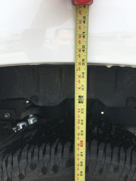

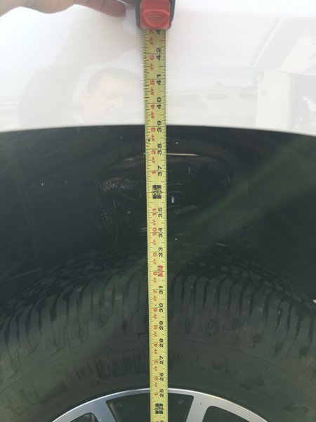

    dude riddle me this, how on earth am I sitting at 42 inches in the rear and 38 in the front, on a 2.5 inch suspension lift?

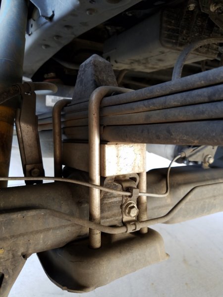

    Did they put ANYTHING on the rear?? Seems like shackles or a 3" block?
    The front sounds about right (should be closer to 39.5) but not the rear at all.

    rear has a 1.5 block

    Then the rear is right....has to be the front. Should be up 1.5" more than it sits now

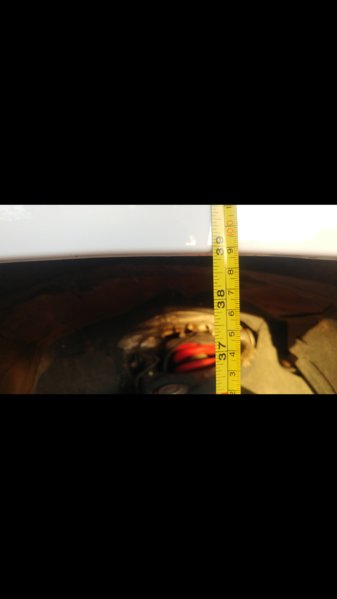

    Just measured mine. 40.25 front and 41.5 rear on 3" BOSS setup and 1" block
    And 275/70r18 (33") tires so yours should be at least 39.5 in front
