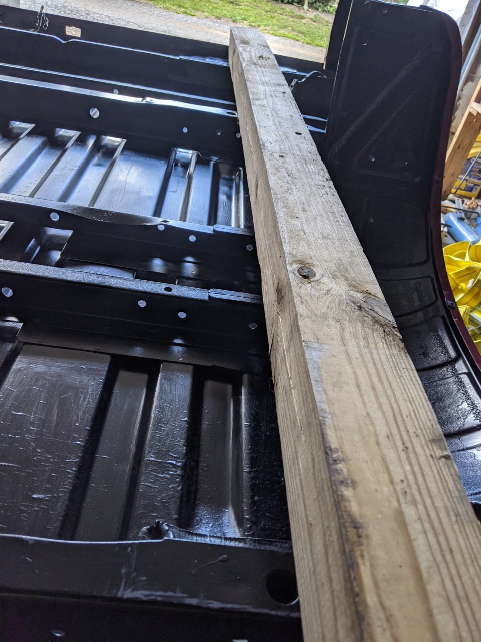

    Eventually sourced a bed for an exorbitant amount of 4k... It's rust free from Arizona and it's in my color.
    Borrowed my neighbors truck and a friend's trailer to pick it up in central PA.

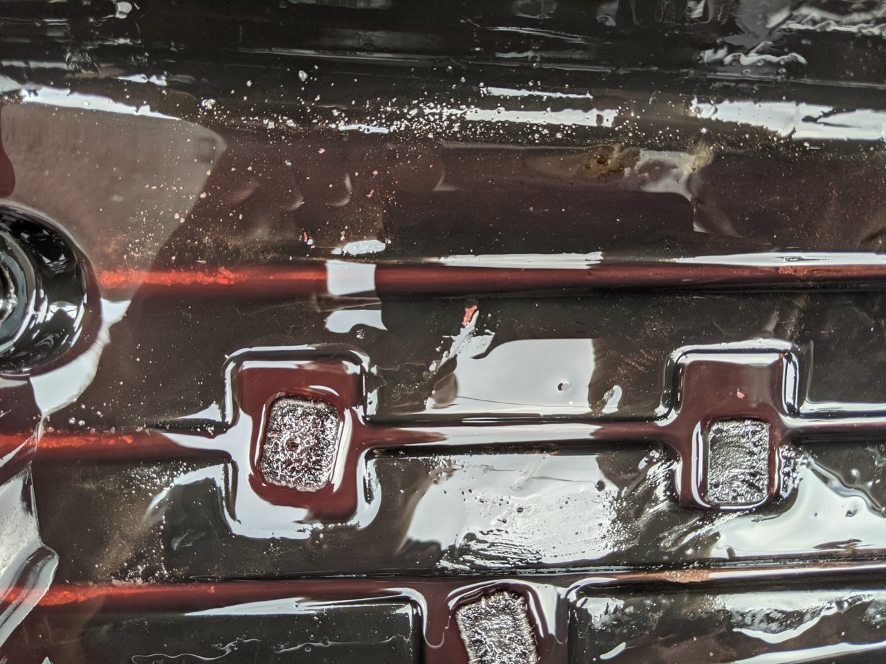

    Cleaned and painted the bottom of the bed. Sprayed it all down with cosmoline.

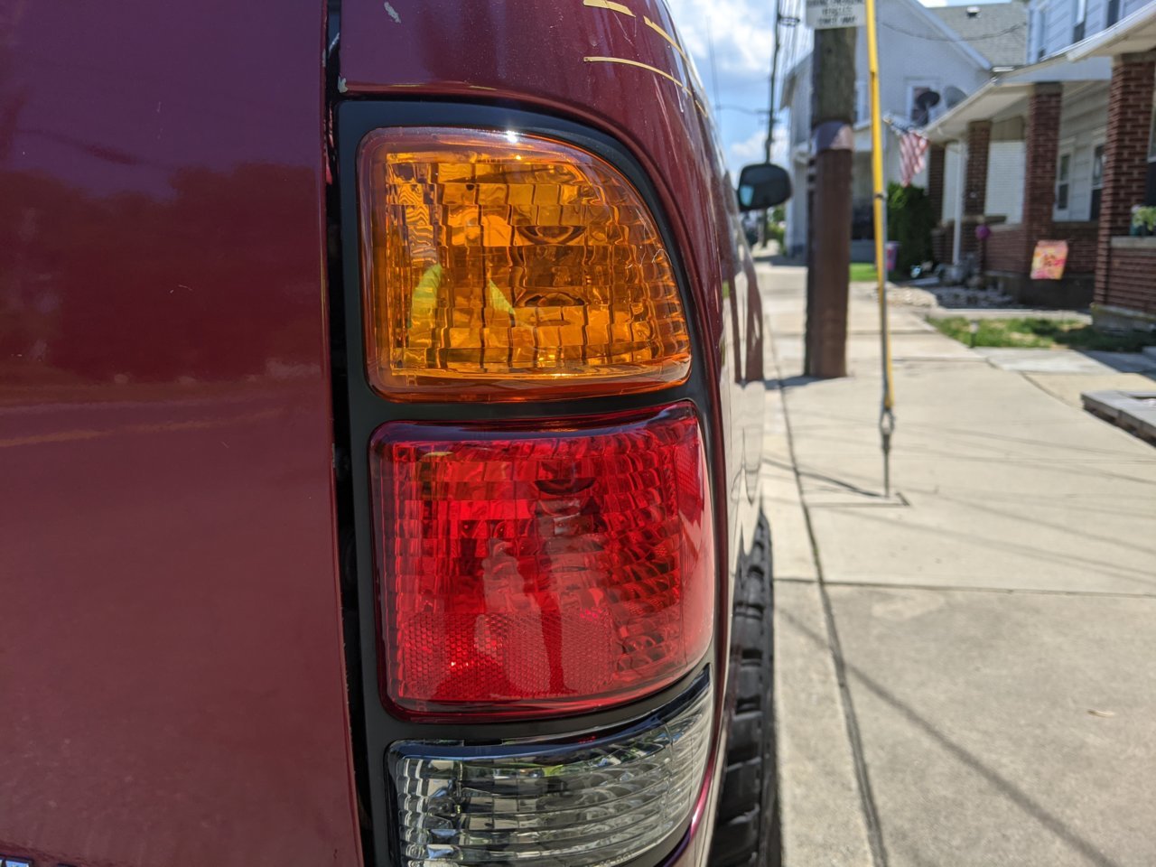

    Got it on the frame and installed some Amazon tail lamps. Are these slightly smaller than factory?

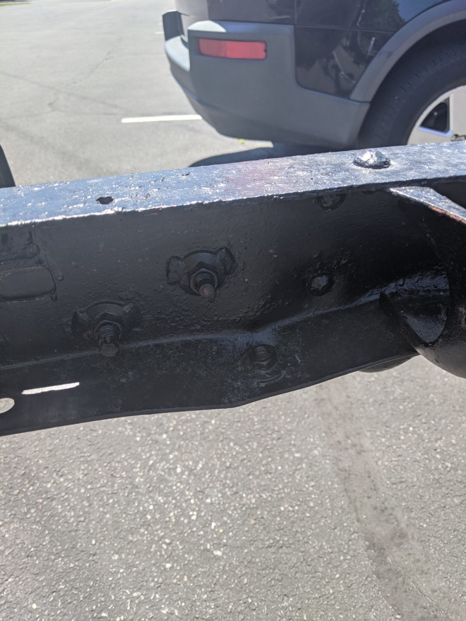

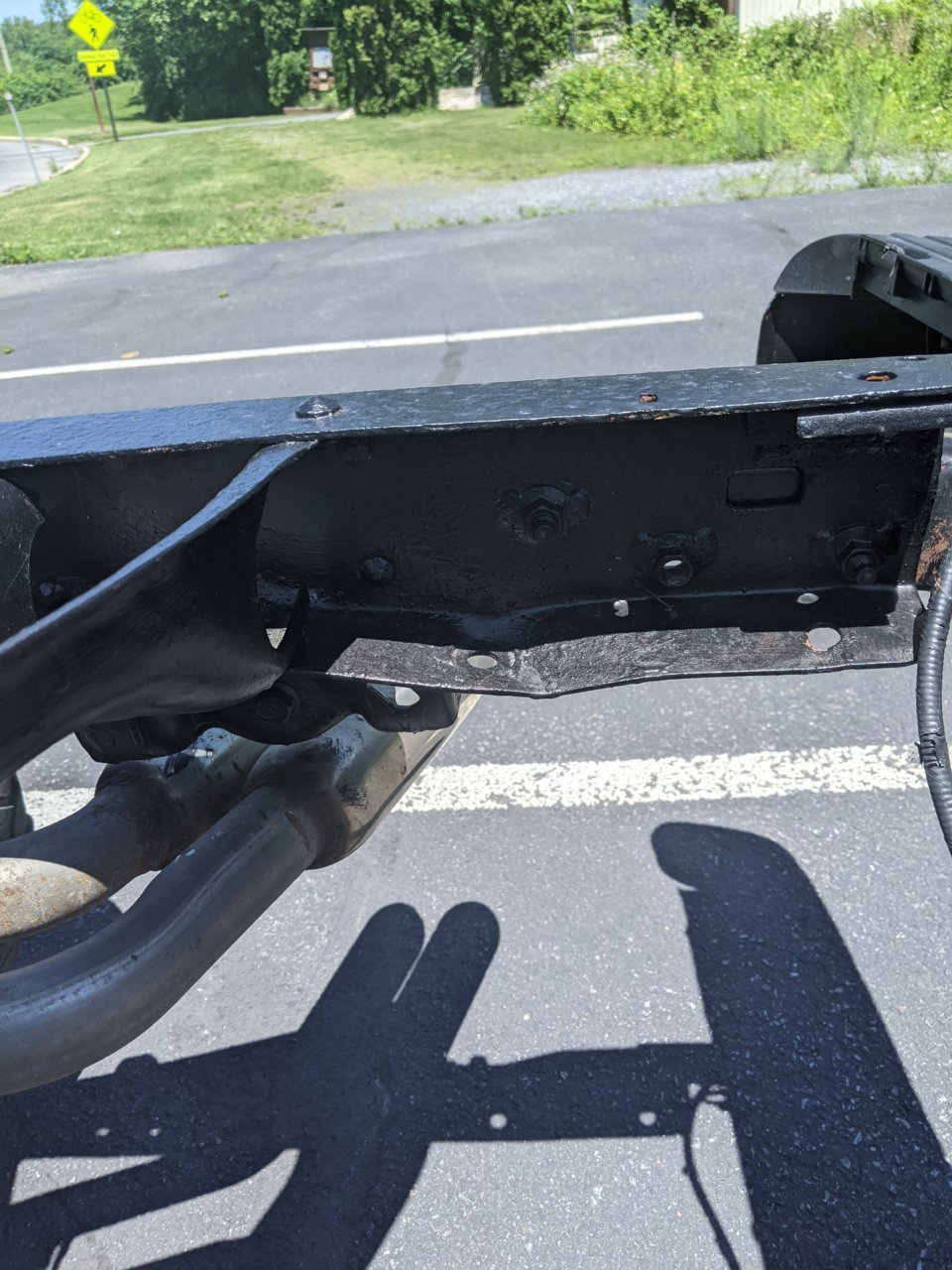

    Drove it to southern Jersey to pick up a bed liner, and as an added bonus found a factory hitch. It was super rusted and the powder coat was gone. Had a local guy sand blast it and primer it.
    [PIC]
    Will paint later.

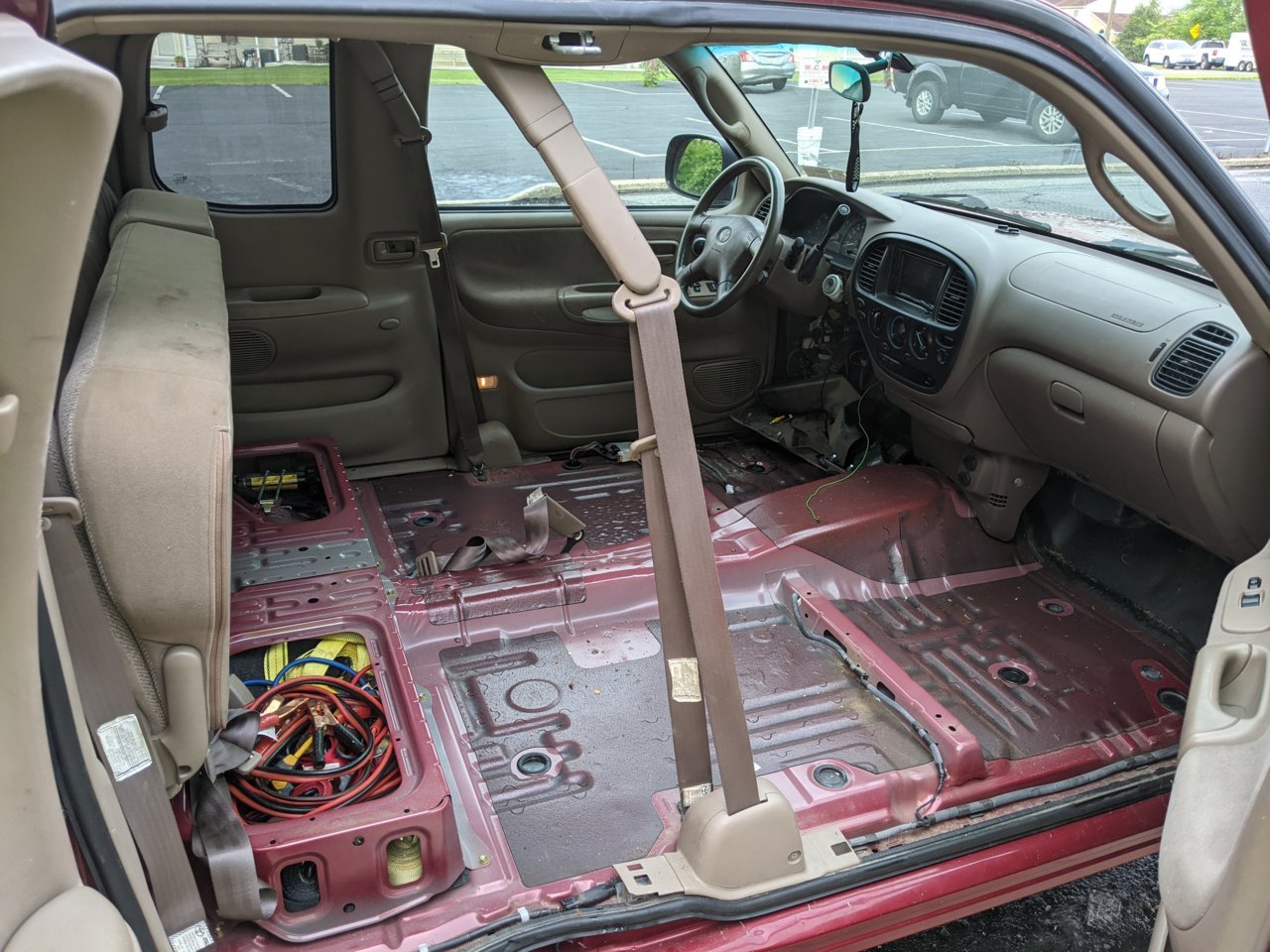

    Pulled seats and carpet out to shampoo.

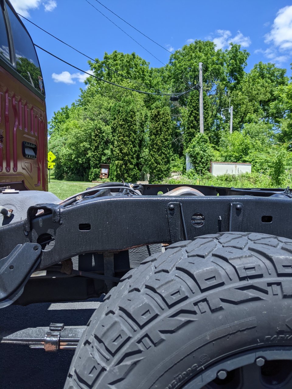

    Attacked the rear end and front end work.

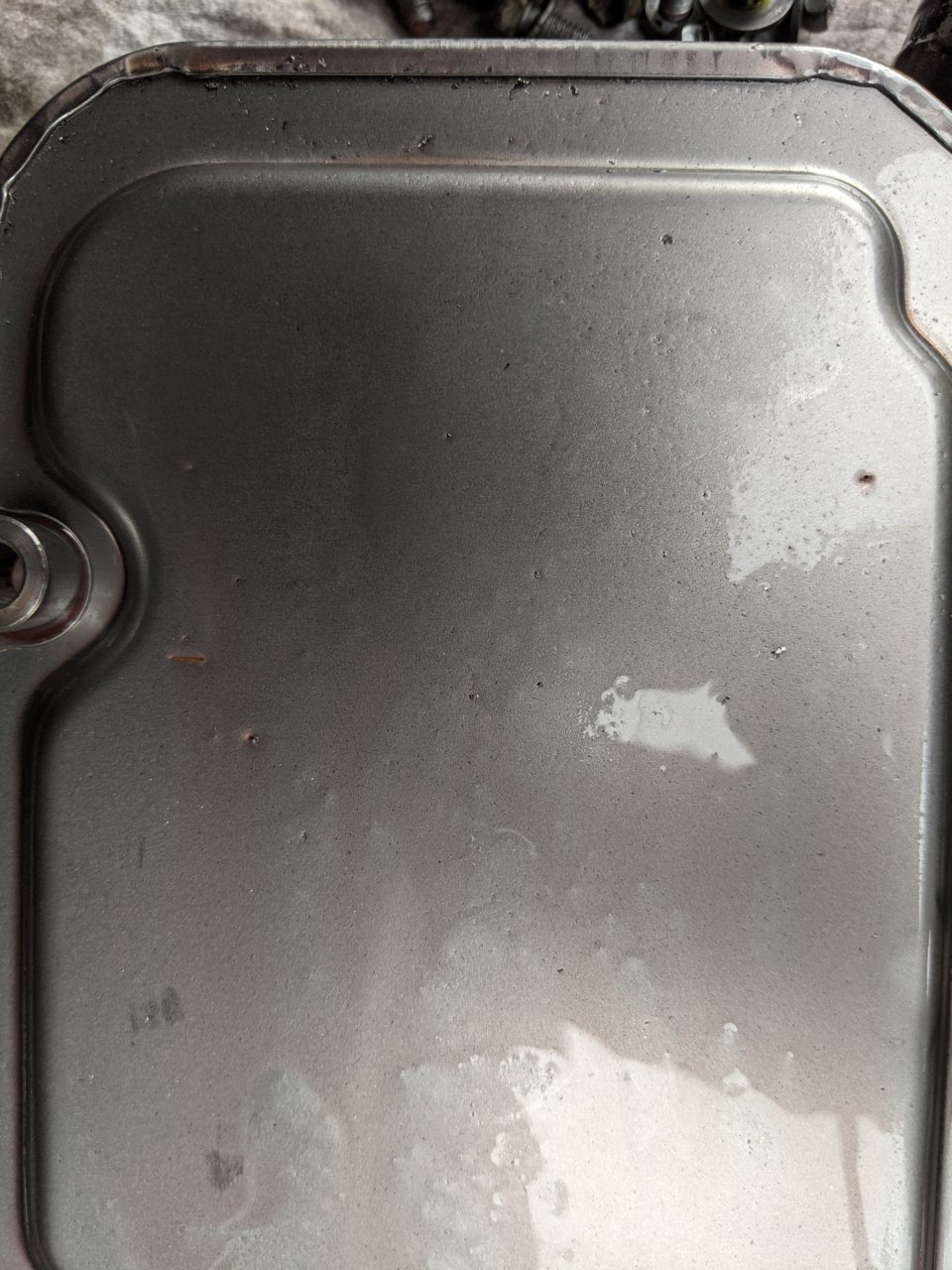

    So like I mentioned in another thread, my trans is shot. Flushed 9 gallons through after I was running a mixture of Dex III and coolant for thousands of miles. It ran great after the flush and then started to get worse.
    Here is the pan contents after less that 1k miles.

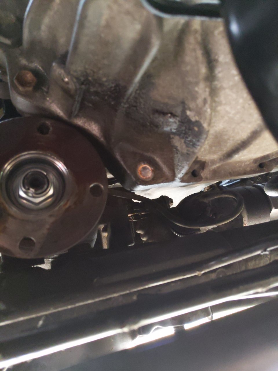

    Son of a...

    Yep. That sucks. You got any reverse-thread ez-outs?
  10. Sep 14, 2021 at 6:27 PM
    assassin10000
    assassin10000 New Member
    Oct 27, 2020
    #54157
    2,202
    Andrew
    Northern CA
    '05 SR5 AC
    Head broke off. Just pull the trans far enough back and it'll slide off.
    Worry about it after the trans is out. Penetrating oil and lots of heat.

    Heat all you want but with no head, you still gotta drill the shaft and coax it out. :D

    In all seriousness though, you're 100% correct. Once the tranny comes out, there's be 1/2" shaft to work with. Penetrating oil and heat, maybe two thin nuts locked to one another to back that out. If all else fails, drill and ez-out. Ex-out kits at most auto parts stores for under $15. @ OP just be careful, you don't want to snap off hardened steel in the hole you drill. Work slow, work careful when using them.

    I don't think it's tight in the threads. The shank of the bolt is stuck in the bell housing with oxidation.

    Yup. Fusion between the iron and alloy. Happens with vintage bike stems and seat posts often.
    Heat cycles are the best way to break it free IMO.
