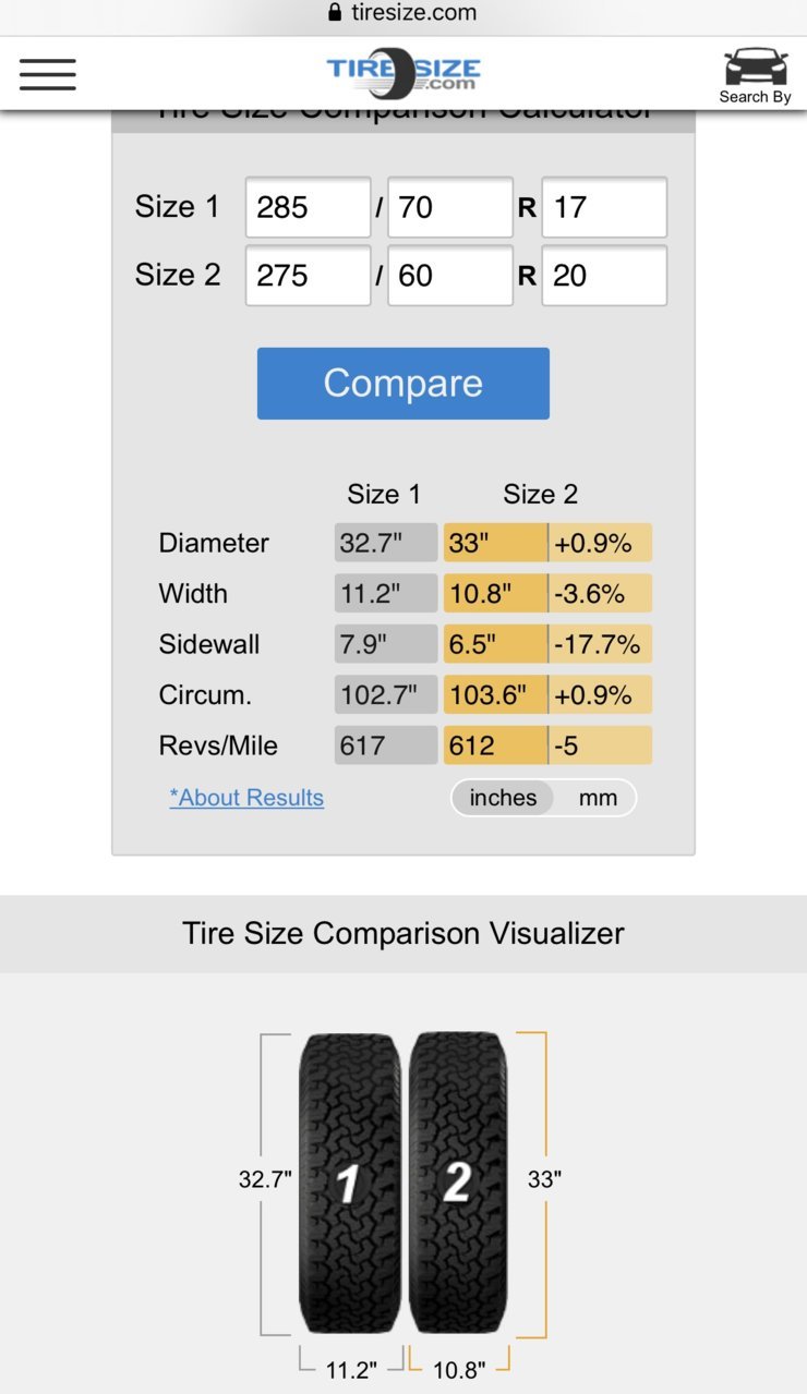

    Just bought mayhem warrior 20x9 0 offset wheels. I would like to buy 275/60/20 tires. Can I get by with just leveling or will I need to lift front and back? Any recommendations would help!

    Those tires should fit fine. They are only 1/4” taller and slightly narrower than the stock Rock Warrior tires.

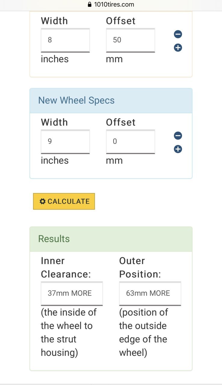

    Wasn’t sure if the 0 offset would affect it?

    Good point. If I’m not mistaken, your 0 offset wheels will stick out 2.5” more than the stock RW wheels.
