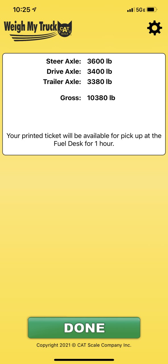

    How am I basically maxed out the GVWR of 7200 with a rpod 190? Makes no sense. So by this measurement, I’m 200 from being maxed? Even with a 3500 lb rv?

    No. Only the tongue weight goes to your total GVWR.

    Is your truck modified? New floor mats? Bed liner? Tonneau cover? WDH? Several passengers? It all adds up.

    Add his two axle weights and he is at 7000 lbs. That's 200 shy of the GVWR. He is correct.

    Yup. I’m basically getting ripped apart in a FB group, they are all saying who cares what the payload is as long as your under the tow capacity. These guys are all towing 38’ 9000lb trailers. It’s quite cringey. I really want to tow legally. So I’m clarifying, looks like I can go up a trailer of about +200 tongue of what I currently am.

    Yup, GVWR is how heavy it can be. GVWR of a Tundra is ~7200 lbs. His steer (front) axle is at 3600 lbs. His drive (rear) axle is at 3400. Ignore the trailer axle and his truck, with the tongue weight is 3600+3400=7000. GVWR minus the actual truck weight 7200-7000=200.
    He is 200 lbs. shy of his GVWR. Not sure how you are missing that or how you think showing me the definition of GVWR is going to alter the math. :crazy:
    Tundras have low payloads and it's not hard to hit the GVWR.

    Was that with all your gear and passengers in your truck?
    The Tundra ratings generally restrict it to lightweight travel trailers under the 20-22 foot length. You'll find a few exceptions, but if you are planning to tow a big trailer AND stay within payload...well, the Tundra might be the wrong truck for the job.

    Yes all the gear and wife/dogs, full tank of gas. We found a slightly larger rv, mainly the floorplan is bigger. So we are upgrading to that. The hitch weight is about 500, and dry is 5000. So now I’m really bumping up to the payload cap. But I think it’ll stay under if I continue with the WDH, and correct loading of the rv.
    the above weights are also with basically
    Full black/grey tanks. So I’m sure that weighed on the hitch about 50lbs.
