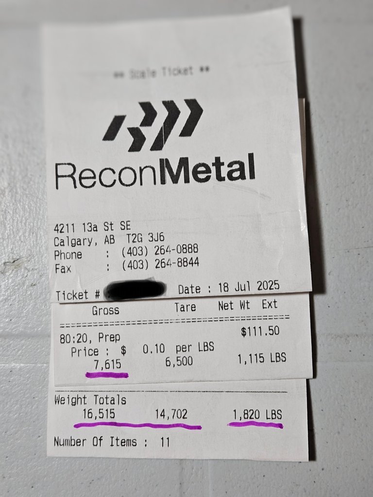

    Hi
    I have a 2007 double cab long bed 4x4, with 4.7 liter. User manual says Max weight is 1220 lbs.
    Recently I loaded some scrap metal to the metal recycler after cleaning the garage.
    I was very surprised after seeing the total weight of metal shown on the receipt: 1820 lbs, plus my weight and 1/4 tank of gas, I can safely say the total load was ~2000 lbs.
    I did not notice any sagging or driveability issues on the way to the recycler.
    I think I overloaded the truck by a big margin.
    Cheers

    Your curb weight is calculated with a full tank of gas.
