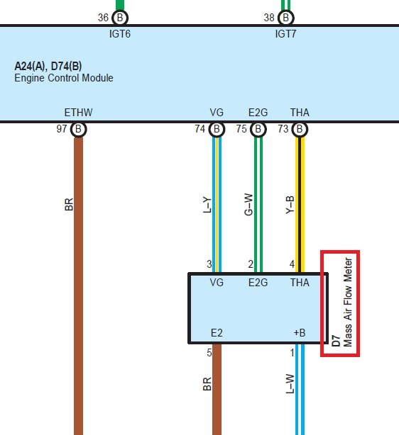

    I have a 2014 Toyota tundra. Sr5 tss, 5.7 v8 .. does anyone have the color coded diagram for the mass airflow sensor five wires flex fuel

    BubbaW
    Aug 19, 2019
    #34845
    4,084
    Bubba
    Where Eagles Nest
    04 DC LTD 4X4 4.7 V8
    T150 Lover

    Its a flex fuel will that change anything

    Not as far as Mass Air Flow goes for a 3UR-FE/5.7.
    You can double check if you wish in the EWD I linked to in 1st post.
