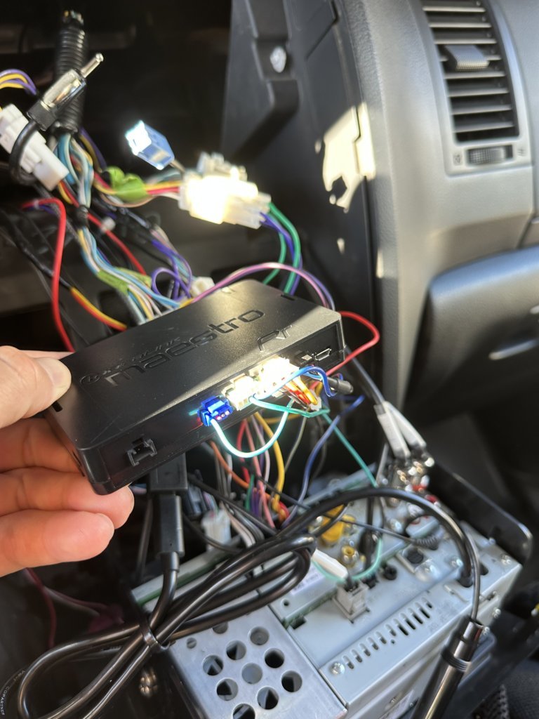

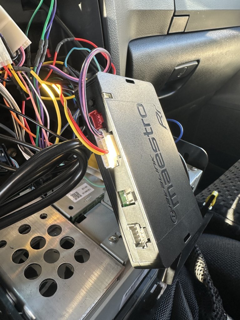

    Hello I have a 2013 Toyota tundra double cab non-JBL non-navigation. I installed a maestro RR with a Kenwood DMX 958 XR and none of my OBD are reading. It recognizes that the door doors are open and closed and that’s about all. Maestro can’t help me and I haven’t seen anything on the forums that fixed my problem. I got all my harness equipment from. https://www.autoharnesshouse.com/

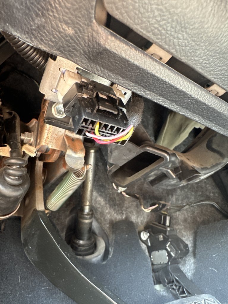

    Pic of the OBD signal wire plugged into your harness?

    The OBD plug for the Maestro RR is fully seated on both ends. It has been reflashed and reset multiple times. Head unit has been initialized multiple times as well. I did not see any settings to “turn on” OBD feature in my kenwood.

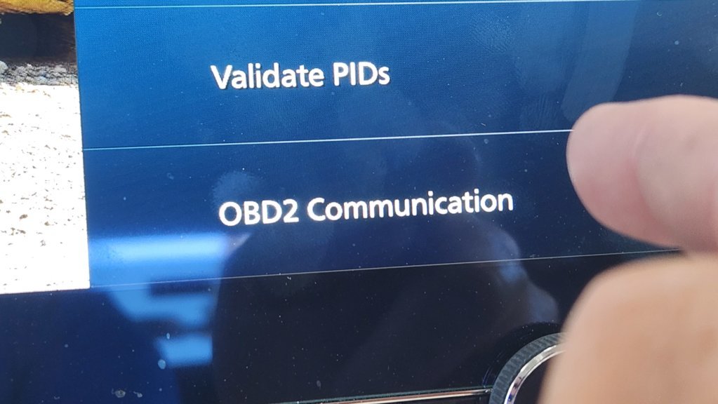

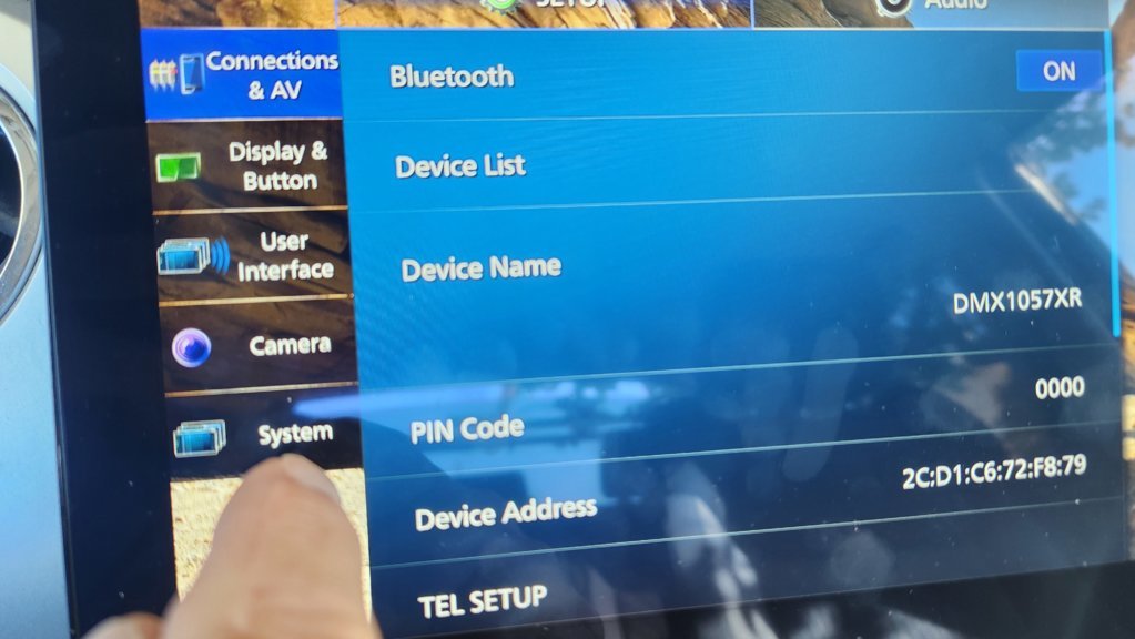

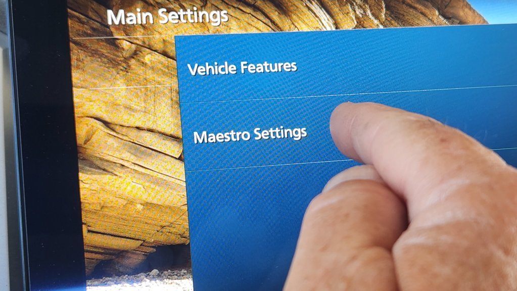

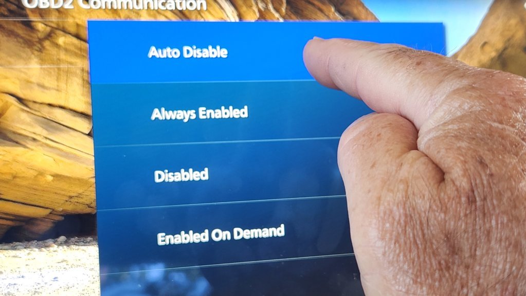

    Okay, that took me a minute.
    Don't know that this will fix anything but it's worth checking.

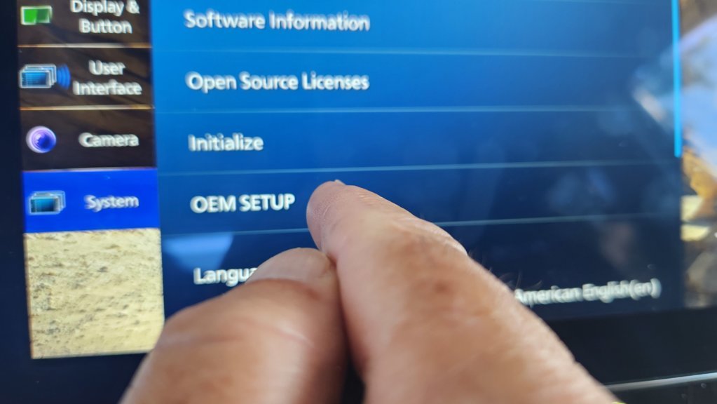

    Settings (Gear icon)
    System
    OEM Setup
    Maestro Settings
    Gauges
    OBD2 Communication
    Mine is set to "Auto Disable "
    Good luck, hope you get it figured out.
    stolentricycle[OP] and bulldog93 like this.

    Unfortunately that did not work, but it was disabled so I enabled it. I thought for sure that was going to be the culprit. Thank you for the insight though.

    The guy I spoke with on the phone asked what color the 18 pin plug color was that is plugged into the Maestro. Mine is white and he said it should be “black”. From there he said he will no longer be able to help me because it wasn’t a harness supplied from Maestro brand.

    Yeah, that stands to reason.
    Sounds like that harness might be your prime suspect. That would explain why the harness guy isn't very responsive either.
    I wonder how much the Maestro brand harness is.
