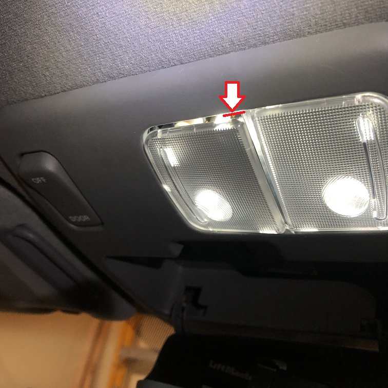

    As @alb1k says, give it a little tug downward. After screws are removed, it's held in place with the 2 clips shown in red below.

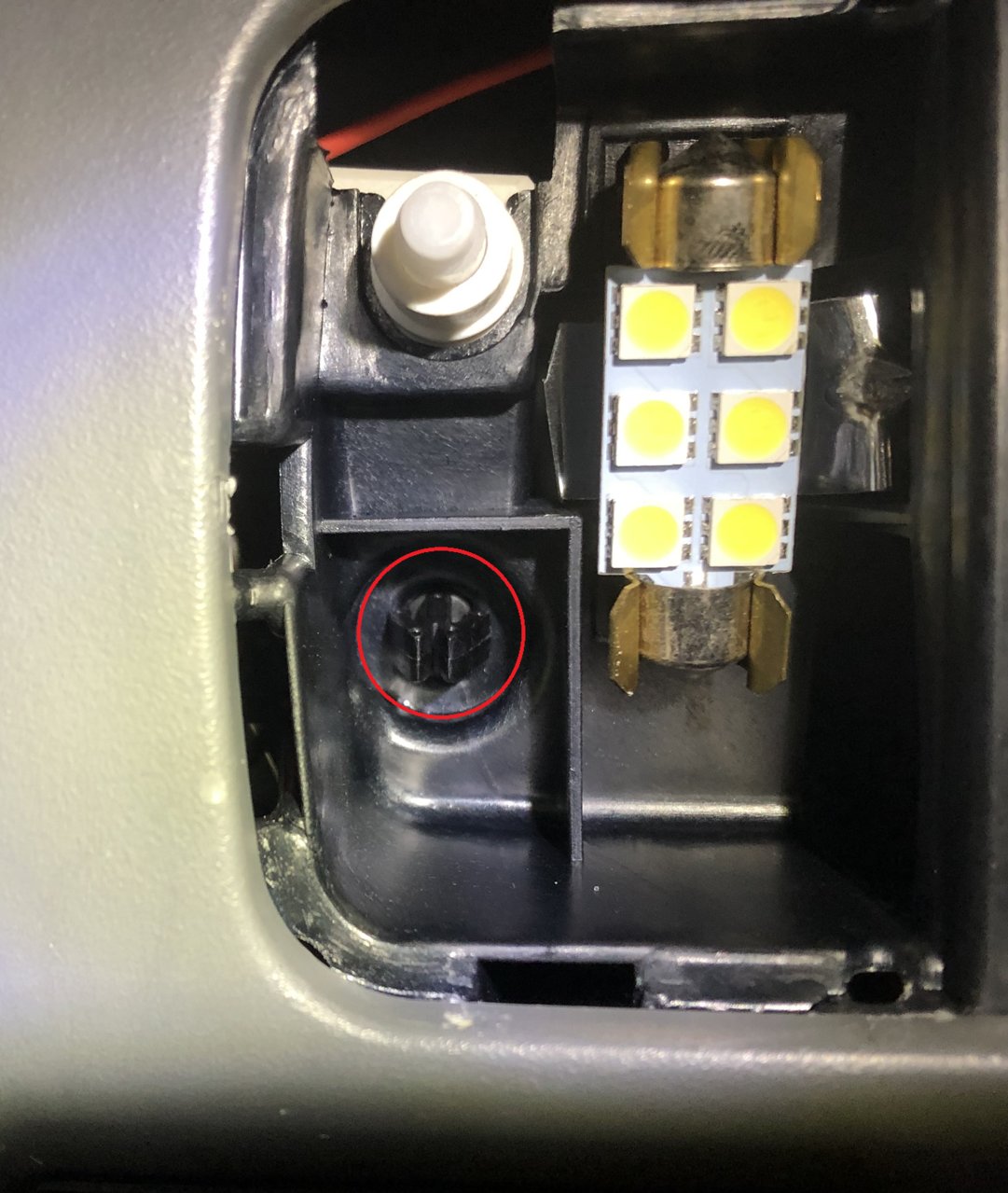

    NO NO NO NO. That's not correct @BubbaW and @alb1k :rofl:
    For OP's Access Cab, there's a little clip you need to squeeze together, and to access it you need to pop off the map light cover on the driver's side. If you try to pull it down without doing that, you WILL break the housing clip, we aren't as lucky as you double cab owners, your process would have us breaking shit.
    Let me go out to the truck and take some pics. I'll be right back.

    Start by opening the compartment, then remove these two:
    Next, you need to pop off the driver side light cover. Do this by taking something thin and plastic to slide into the seam here, and bump out the lens' pivot point.
    If you turn the switch on above to "OFF" so you can see back in there, the light will stop blinding you and you'll see the fastener you need to squeeze together, and the housing will drop down. It's almost like an arrow-shaped barb.
