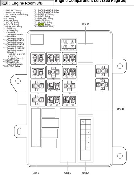

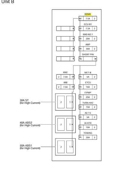

    On my 2014 it is the dome fuse in the underhood fuse box.

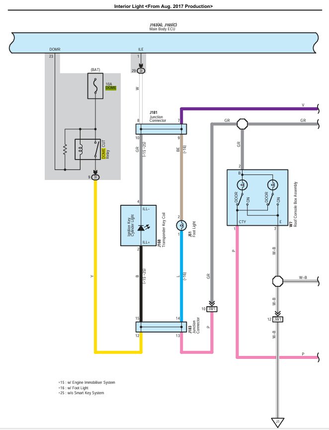

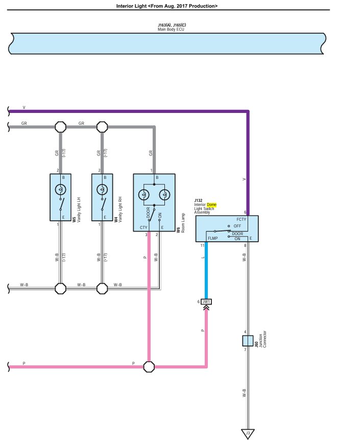

    Screenshot_2024-09-21_145556_5c8bb9d798a8517a3cec8a18c59763f91cad733a.pngScreenshot_2024-09-21_145650_63250d7983eba164a7457d12bff74ff9b414d543.png

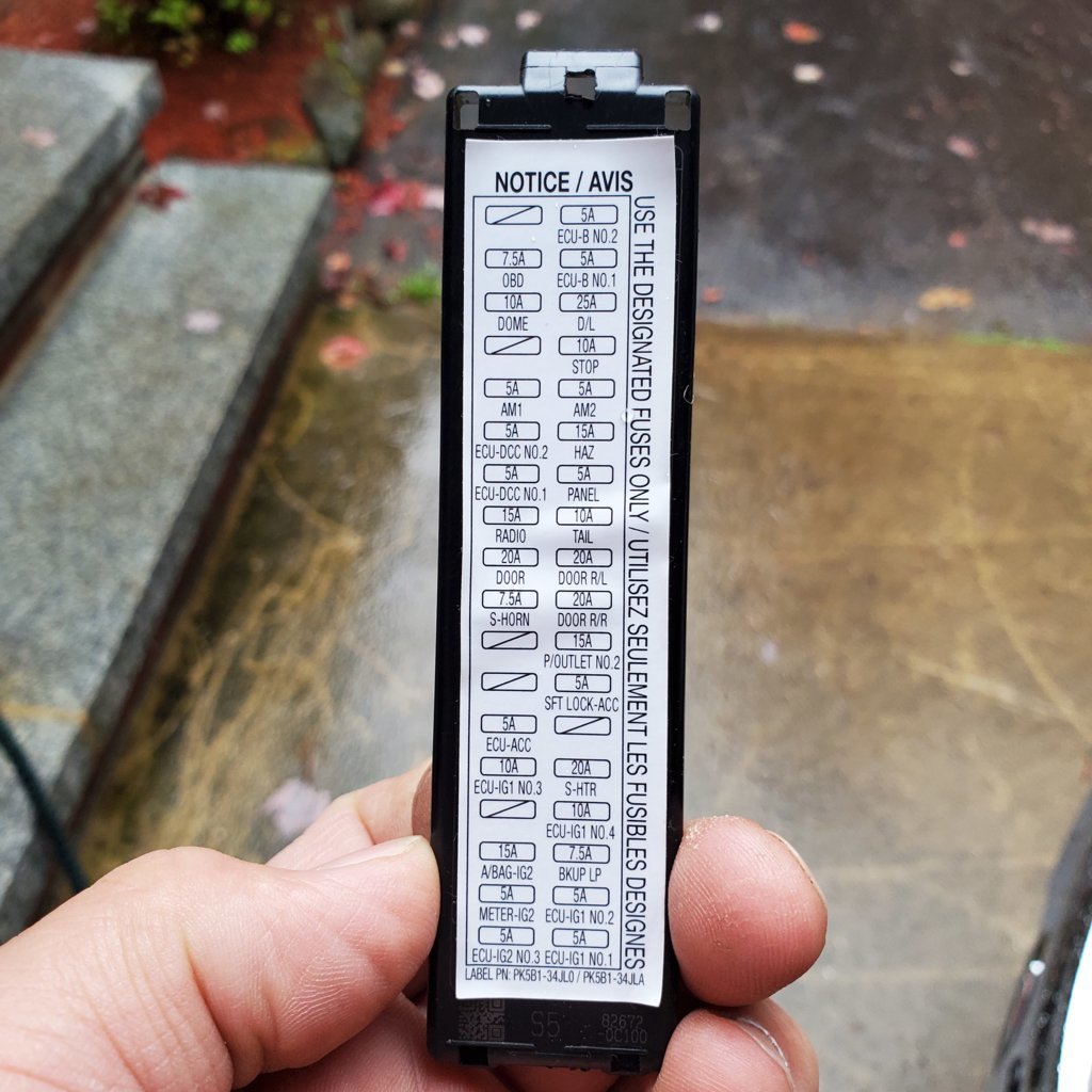

    The truck is a '18. The under hood fuses check out. My dome lights do work.

    Here are my in-cab options.

    They are all on the same circuit..
    Roof console (Map lights), foot light, and room (Dome) lamp..
    If one works, they all should work..:confused:
    Do the mirror vanity lights work?
    Did you recently install LED bulbs in the map lights?
    Some of them have to be installed with the correct polarity.
    And unless you have after-market, I think there is only one tiny little footwell light on the driver's side.
