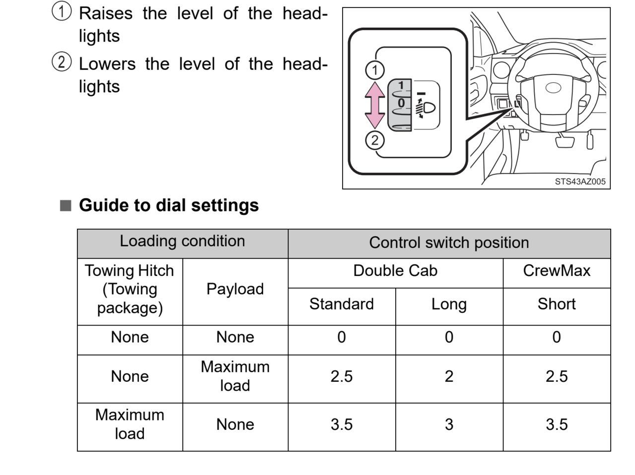

    Does the truck have a leveling kit on it? Often times, folks install one and fail to adjust the static aim on the headlights (regardless of brand of truck) and end up with them set correctly.
    With regard to the dial setting, here's what is recommended in the manual for my 2021:
