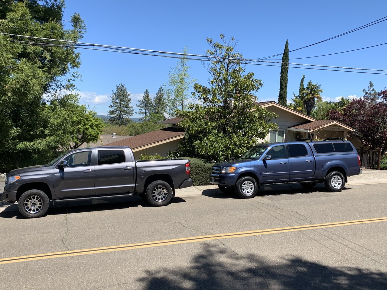

    Okay. When I purchased the truck it had a coil spacer installed and SuperSprings helper springs in the rear (small travel trailer was towed by original owner).
    Truck seems nose high but measurements were exact at all 4 corners as level.
    I have since added a decked system, A.R.E shell, and RTT. Now I'm definitely nose high by about 1 1/8". Crazy it seems like more but the tape doesn't lie.
    Once in a while load out weight will change and also winter removal of RTT. I want to upgrade suspension to level it out, but don't want to do anything that will limit future upgrades.
    I was thinking (as suggested on this forum) of Firestone ride rite's. I'll have to remove helper spring to add Airbags. I'm hoping this will level it with current setup. But not limit me if I add different leaf springs later on and/or 6112/5160's.
    Just trying to do the simplest mod possible with least amount of negatives, like ride quality, axle wrap, etc. I'll also eventually get rid of this tire/wheel combo for some 18's and a more narrower profile than the 20" 305's that are on it now.
    Use will be camping, some fire roads and low amount of off-roading. Not Rubicon stuff.
    Anything I am overlooking or missing here??
    Prior to shell,Decked, RTT
    Serious lean now.
    Thanks in advance.
