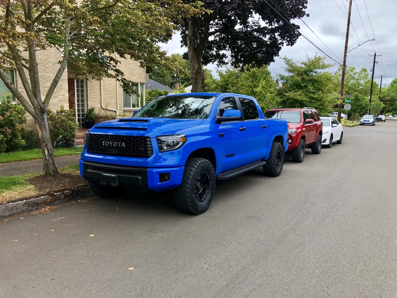

    Speaking from experience, get a +25 offset. So either Icons or a few of the Method wheels. Remove the mud flap and either push the front fender liner forward, remove it, or buy the coachbuilder bumper spacers.
    Lift isn't necessary, but it'll look pretty squatted with the front at the stock height. Lifts don't prevent rub on our trucks unless your talking 4"+, otherwise you keep the same range of motion and as soon as you compress the suspension you'll rub if the offset is too aggressive.
    Pro with +25 and 315s (2" front lift), didnt need CMC, did remove the front bumper liner.
    SR5 with 0 offset and 315s, have had it as low as 2" of lift and currently at 2.5" of lift. Changing height did not affect the rub, only moving the bumper and CMC. CMC done, bumper moved forward with a spacer, bumper liner removed.

    831
