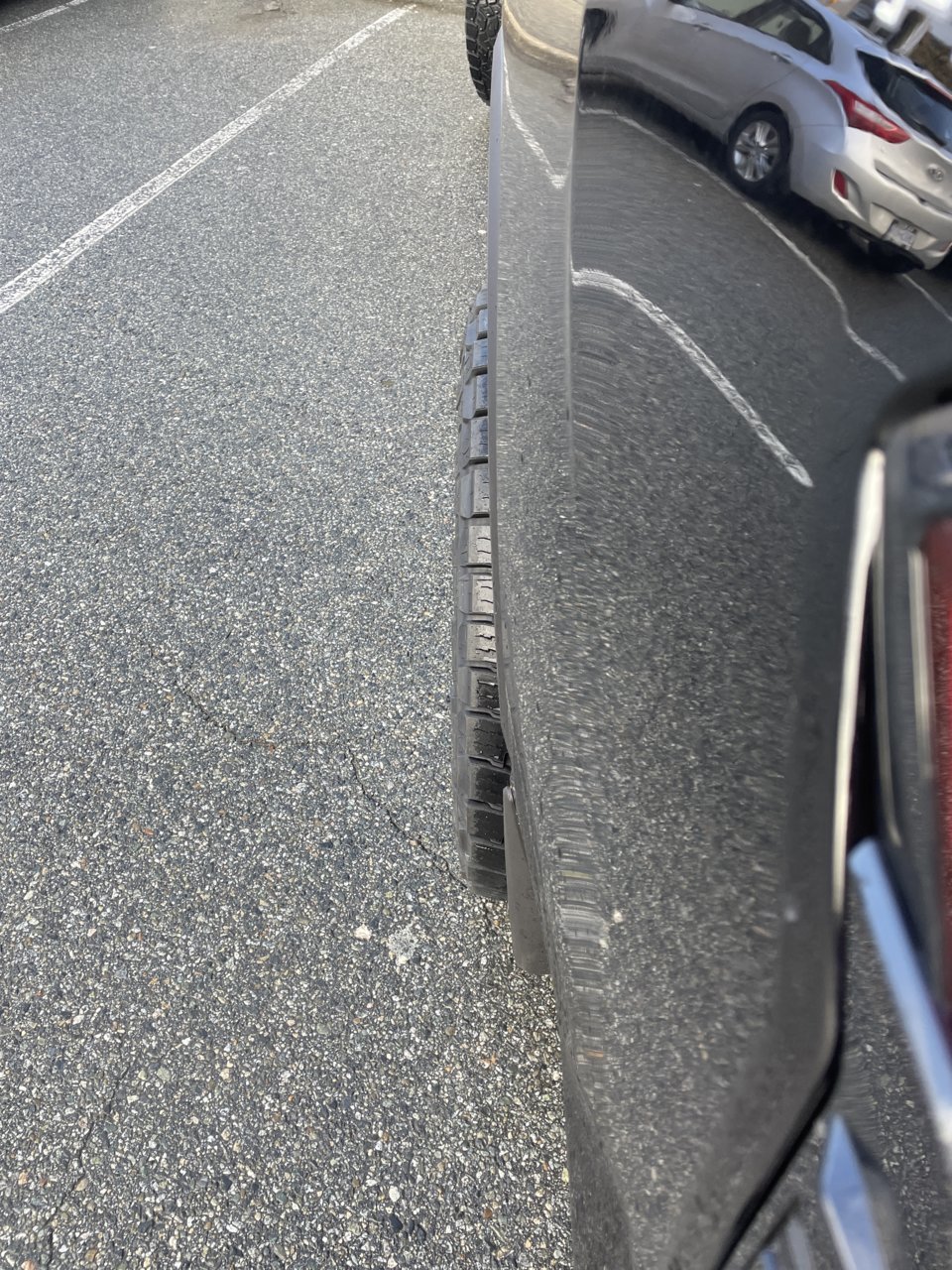

    So I have method wheels and 12.5 tires. They poke out way more than I’d like them to and my paint job is taking a beating because of it. If you never leave pavement than not a big issue. For my next tire I’ll be going to a narrower tire. Just know that with 12.5 tires you’ll be pushing the tire outside of the wheel well if you add enough offset to fix your rubbing. So a little rubbing or a little poke…. Pick your pleasure haha.

    Actually these are 11.5 (285 65 18) on +18 method 705’s and they still poke quite a bit. I love the aggressive sidewall on my MT Baja bosses but adds to the issues of having a tire poke out past the wheel wells.

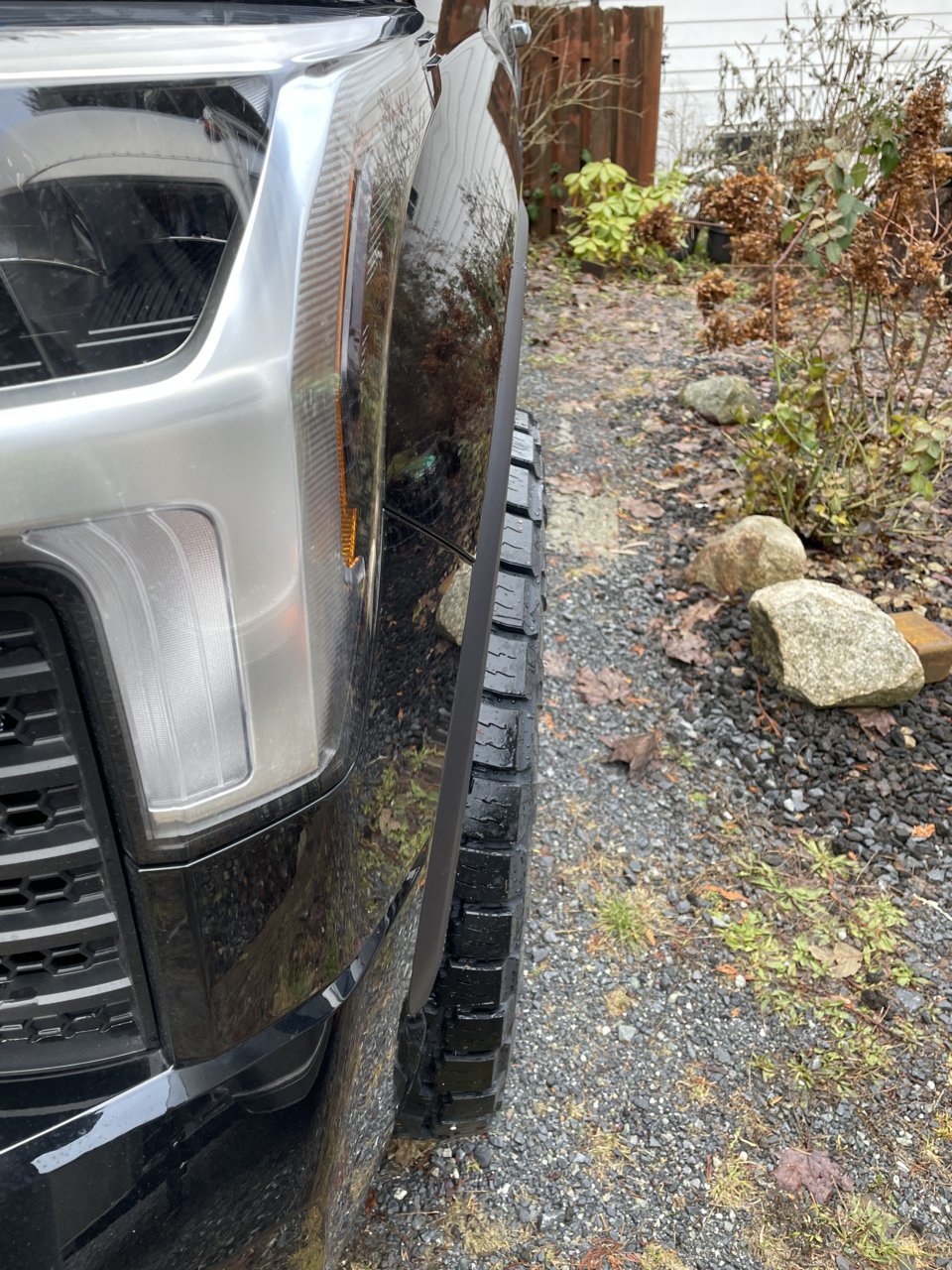

    Well, as mentioned in the other thread, have the kit being installed currently and took recommendation from dealer parts guy on tires - which were the Nitto 35 x 12.5 Ridge Grapplers - and I felt good on that seeing that is what they were on the SEMA truck. I have them doing the TRD skid plate at the same time with the instructions on how to do it properly so the sway bar hidden.
    Will let you know if they tell me there is a rub issue as I will ask prior to having it picked up.

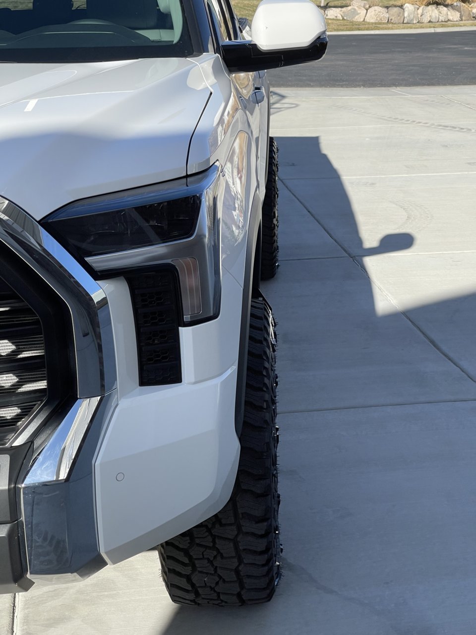

  21. Jan 1, 2023 at 10:52 AM
    bcj001
    bcj001 New Member
    Apr 13, 2022
    #77145
    39
    Brad
    Oregon
    22' Tundra Limited
    I am running 35x11.5R20 Nitto's on my stock 20" TRD wheels, no lift... no poke, no rubbing... the 12.5 is pretty wide for the stock wheels
