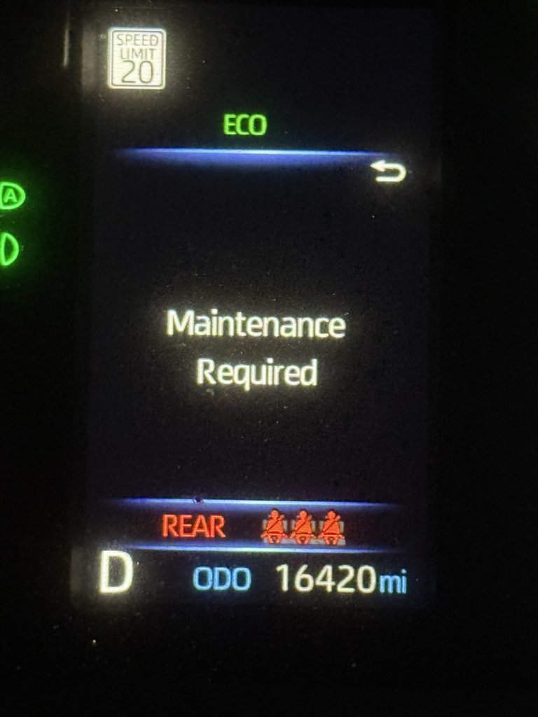

    2023 Toyota Tundra SR5 CrewMax 4x4 6.5' Bed. Not subject recall (yet).
    This "Maintenance Required" message recently appeared. I'm fully up-to-date, even ahead of all scheduled maintenance. The sticker says I have 2,000 more miles until my next oil change.
    Can I get further info on this message without visiting the dealer?
    Do I need a OBD scanner and Carista to see detailed info?
    Thanks for any insight.

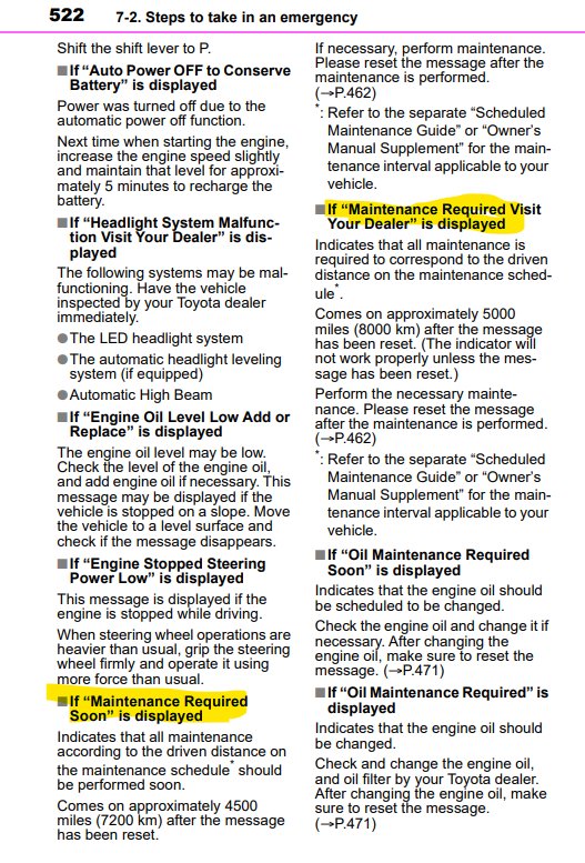

    These are the only mentions of the phrase "Maintenance Required" in the manual and they don't match the message appearing in my cluster.
    My message is different and I was wondering why.
    After reading the manual and looking for more clarification I came to the Tundra's forum since it's been a great community of resources in the past.

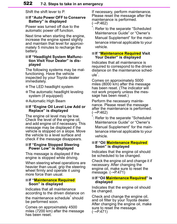

    maint soon light is set to come on 4500 miles after last reset, maint req'd is set to 5000 miles.
    its mostly tied to the rotate tires in the maint manual booklet that comes with the vehicle since the maint manual suggestion rotate tires every 5000 miles.
    the maint manual booklet tells you at every mileage breakpoint what needs to be inspected or replace as needed.
    if you are looking in the owners manual you are looking in the wrong manual.

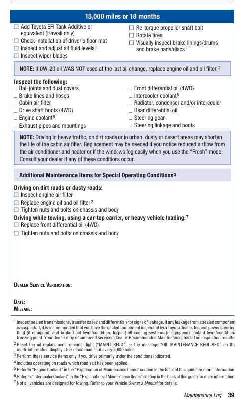

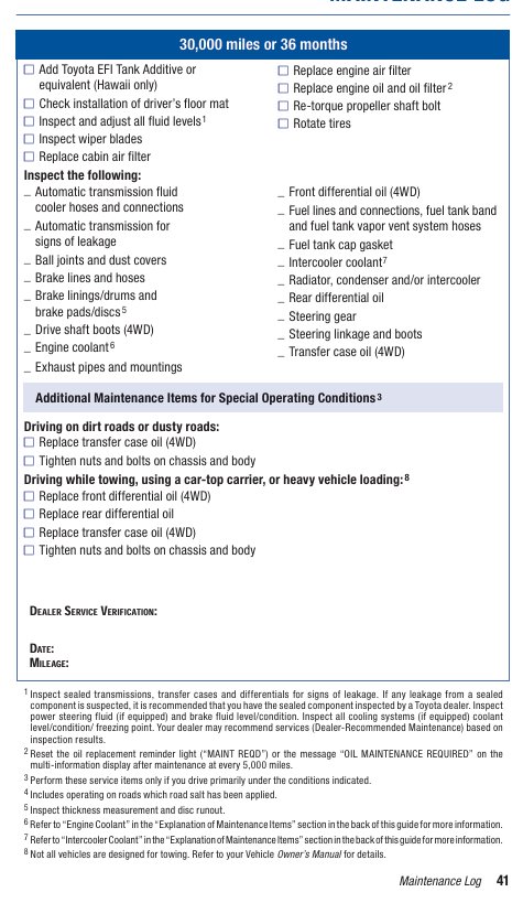

    Your maintenance schedule.
    T-MMS-23Tundra.pdf
    upload_2025-3-13_11-24-21.pngupload_2025-3-13_11-24-49.pngupload_2025-3-13_11-25-4.pngupload_2025-3-13_11-25-23.pngupload_2025-3-13_11-25-38.pngupload_2025-3-13_11-25-56.png
    Etc....................:thumbsup:

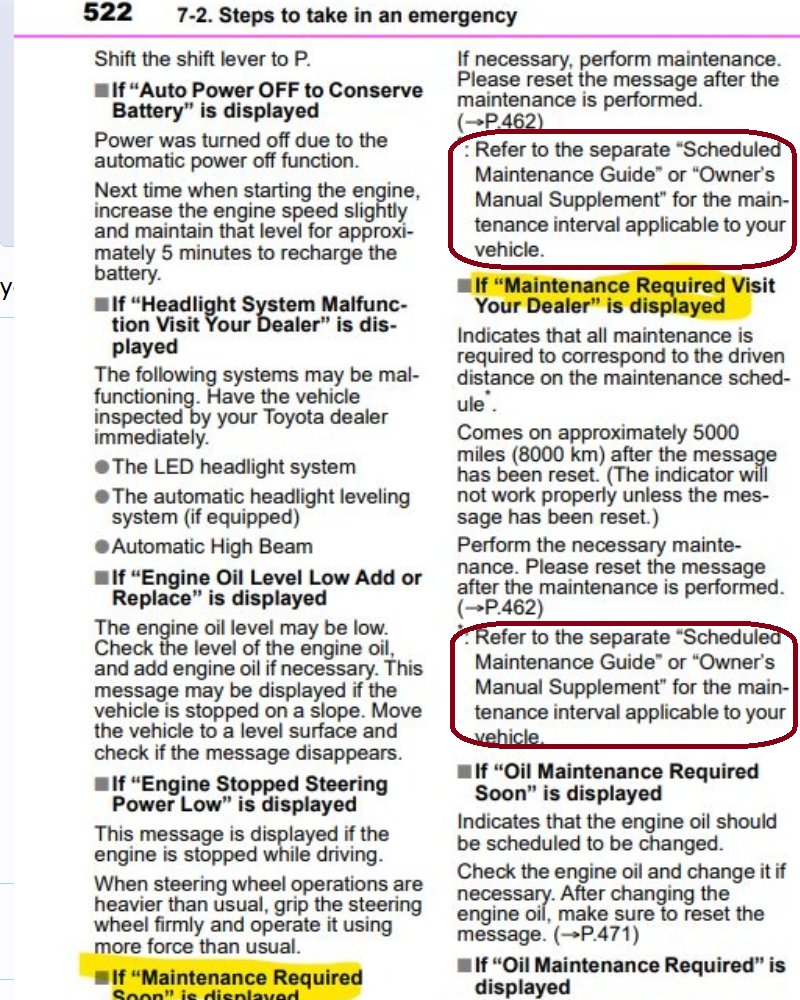

    you only highlighted what you wanted to read.
    see the paragraphs you completely ignored (i circled in red) in the owners manual that points you to the maint manual twice after the maint req'd soon you highlighted and the maint req'd you highlighted
    Raven67 and 1lowlife like this.

    OM0C051U.pdf
