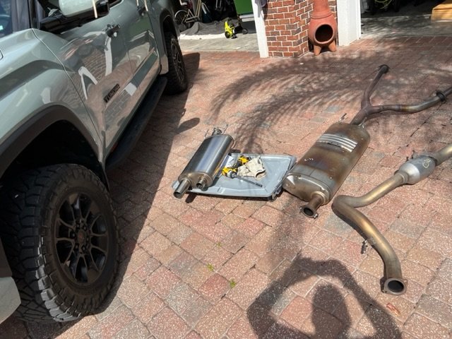

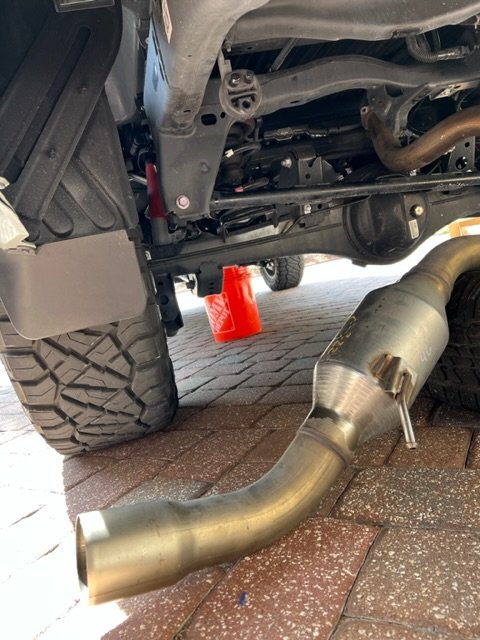

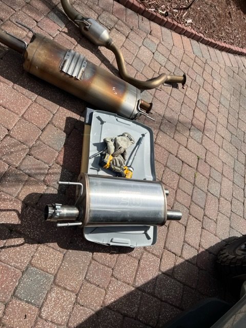

    Highly recommending this super easy exhaust kit install for big gains in throttle responsiveness and a few extra HP…sounds damn good when you lay into it…without any annoying Highway Drone. . Did all the work solo…followed the video from Real Truck on the Carven install as it’s super similar and has a crap ton of great details to follow/reference:
    https://youtu.be/6fYU92AuRNc?feature=shared
    I used a 5 gal bucket and a couple flattened boxes to prop up the muffler & pipes while attaching new components. Definitely drop your spare tire to remove the rear pipes of the OEM exhaust…and get a floor Jack if your rig isn’t lifted at all for the clearance space over your rear axle. Only really need an impact drill, a 14mm, a 15mm, some penetrating oil spray to remove/reinstall via isolator hangers and a few cold beers for afterwards. Cranked her up with with open headers between systems and damn that sounded good but wife 100% disagreed! Check out the sound here: https://youtube.com/shorts/-6AMI8CQoFk?si=bzbYmPEXceOfqiOu
    Final install pics and sound clip coming up next along with K&N install and thoughts on that…thinking the combo will work to get a few more HP/Torque gains and sound pretty good via turbos. Looking to switch to TRD Pro OEM grill, marker lights and Rave Off-road LED bar soon as well.
