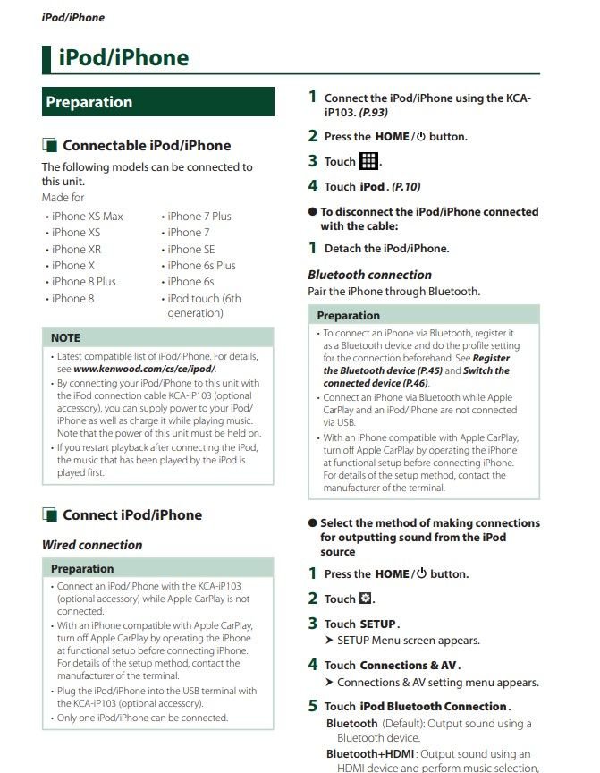

    Did you try turning off Carplay on the phone to use it plugged in with a wired connection (as in the wired connection preparation below)?
    Pretty sure a KCA-IP103 is just a long standard phone cable.
    Did you go to the menu and select ipod?

    Thanks! You helped me figure it out, USB will not work if you are already connected via Android Auto/Apple Carplay, as soon as I unpaired my phone it worked perfectly through USB. I will probably use wireless AA 99.9% of time, but it's nice to know all features work flawlessly. Could not be more happier with this radio and Audison speakers/amp combo.

    You can’t use wireless CarPlay and send data like audio through the cable at the same time. That’s why it’s only charging. It’s an iOS thing that will only let you do one or the other.
