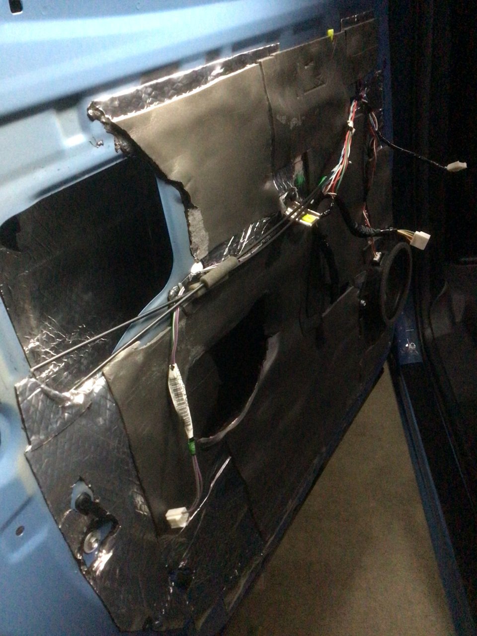

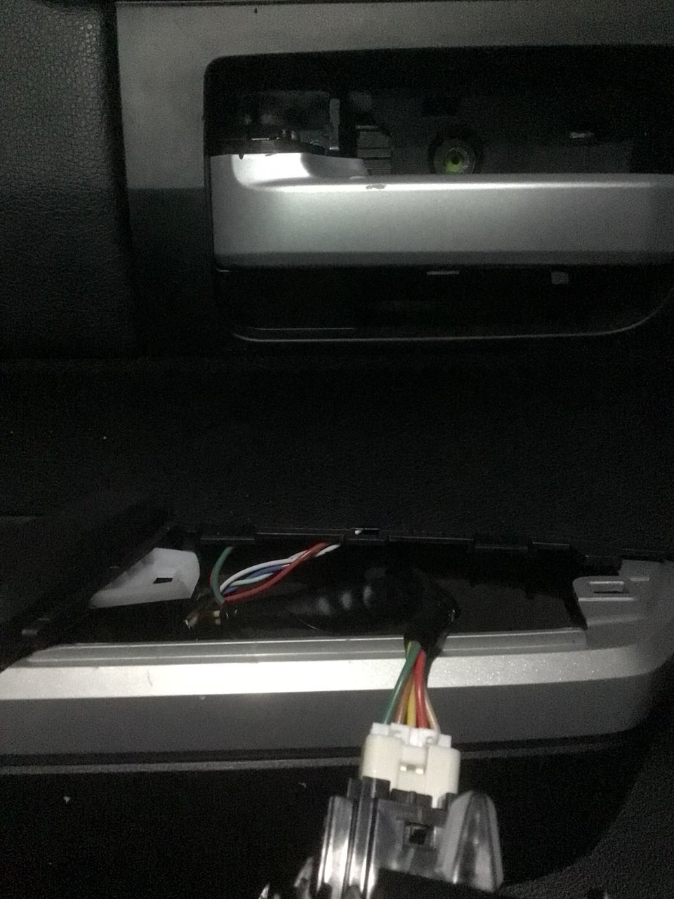

    Made a little progress. I cut the lock out without messing anything up. I was able to access the door cable. Unfortunately it wouldn’t open the door no matter how hard I pulled the cable. So I think the handle is holding it locked with the lock cable attached. I will try to cut the handle out tomorrow and try to free the lock cable from the handle. I should be able to open it from the outside at that point I would think. Hope!

    Why won't it open from the outside?
    I remember putting the inside cables on the wrong things on my 2014 front doors.
    But the outside latch still worked..

    Can you pull the window switch assembly from the door, then get your hand in there to disconnect the two cables? Or at least pull on the lock cable.
    whup, just saw your current pics.

    Negative there is a plug with the wires and a flat part under the handle of the door panel obstructing that route.
    The door handle replacement was only $33 and I’ve already cut the shit up so I’ll continue with the handle. Hopefully save the door panel. I’ll report back tomorrow

    Can’t figure it out. My only thought is it’s in the locked position due to the cable being stretched by the handle.
    I started thinking I accidentally hit the child lock but it should still open from the outside.

    Theres something odd going on than the cables. If you pull the outside door handle it pushes a bar downward and that operates the door latch. Has nothing to do with the cables. Did you mess with the door internals when you were doing this?

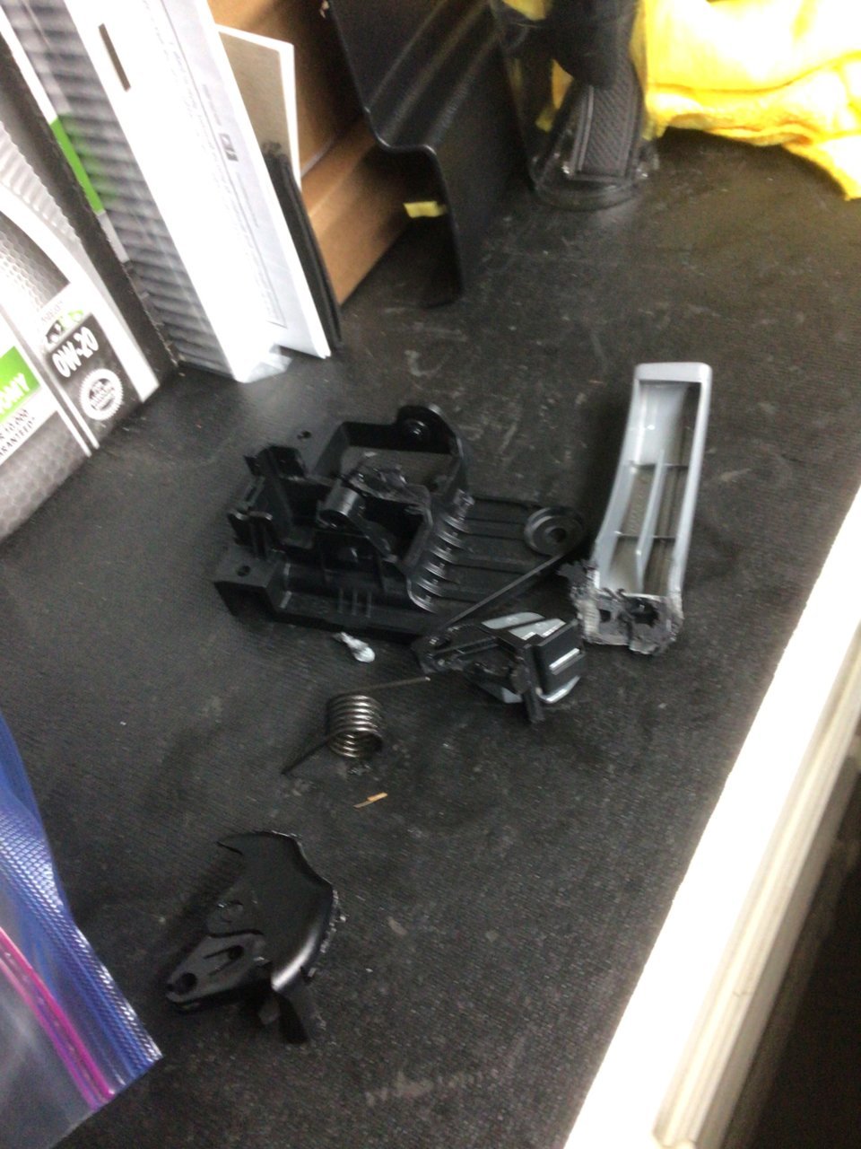

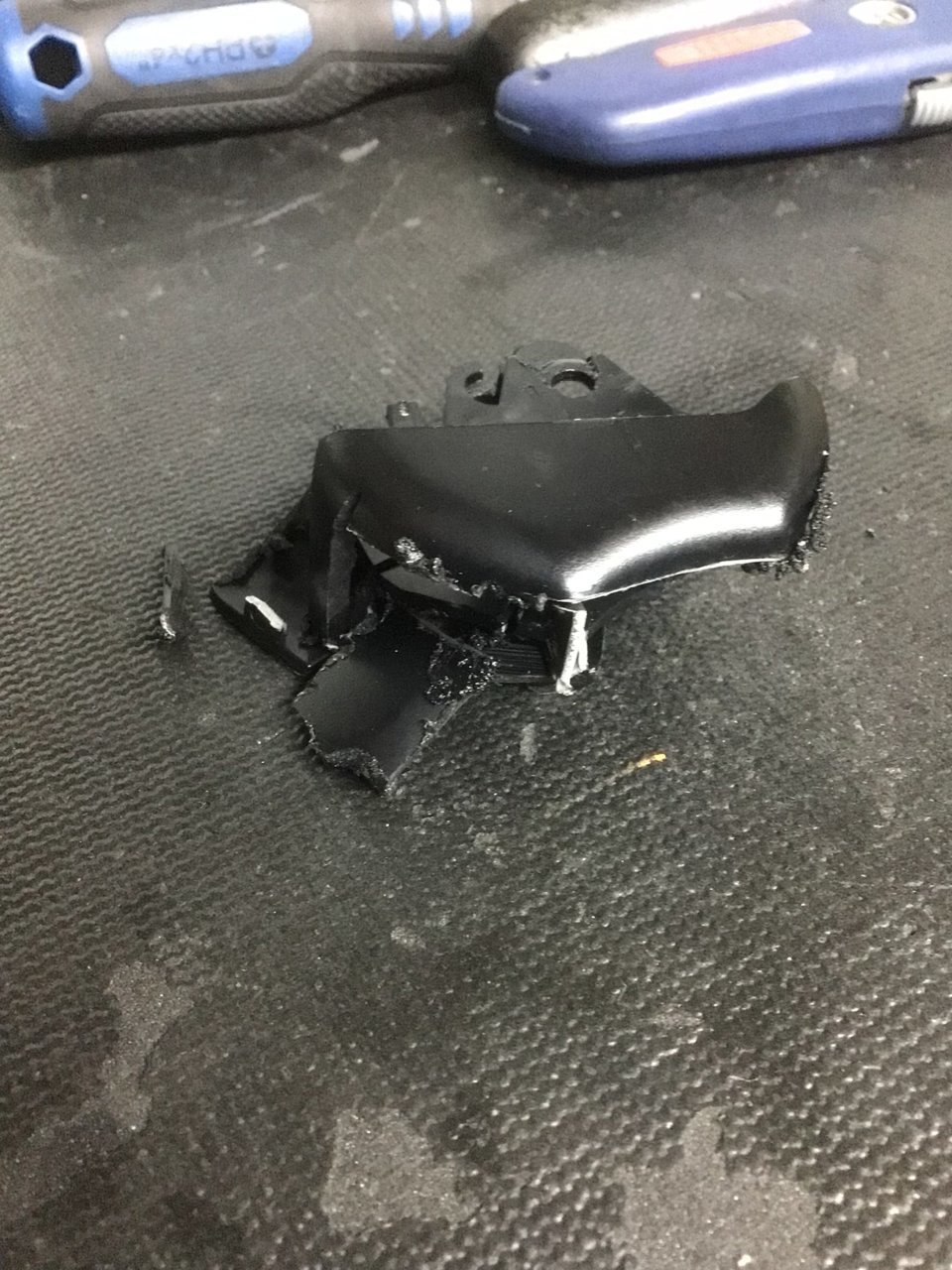

    Reporting success!!
    I very carefully cut the door handle off. Took some time as I wanted to preserve the door panel. Finally got it off the cable and both cables were free. For a few mins it still would still not open. After messing with it some it opened!!
    Like @Rubberdown said there was something else going on. The cables were not working properly. So my neighbor took the whole lock assembly out.
    We found that the lock cable came out of the track on the lock end and was stuck in the lock position. We got it back together and everything seems good for now. I’m waiting til my new handle comes in and make sure everything is good before I reinstall the door panel.
    I’ll report back when I get the handle
