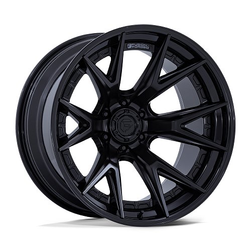

    Could you please recommend lug nuts and TPMS sensors to be used with Fuel Off Road Catalyst rims? Also, would you recommend the locking lug nuts? A link to the product would be appreciated. Want to purchase online and bring to the local shop.

    Heads up... each tire shop will have a preference on TPMS brand they sell and the programming tool is usually proprietary to the brand of sensors (usually).
    14X1.5 ET (extended thread) lug nuts - https://www.amazon.com/dp/B08L75GQS3
    Hub centric rings - https://a.co/d/5RqQ9Th
    TPMS - https://www.amazon.com/dp/B07CZRJX5F (have the shop you choose clone your factory sensors for seamless integration)
