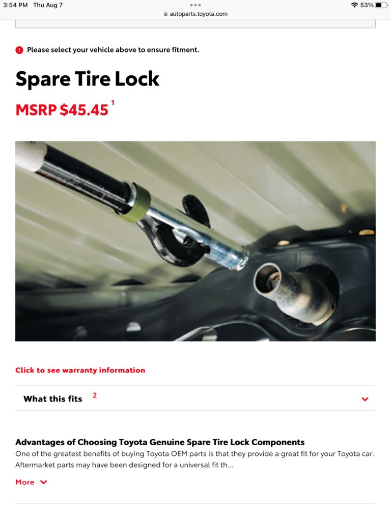

    I remember a thread where someone mentioned the Toyota factory spare tire lock might be a solution.

    I wish I could like this 100X Thank you
    EDIT: I looked this up to order and this one says it's for a 2007-2009. This one says it's for the rest of the models up to 2024
    https://parts.conicellitoyotaofconshohocken.com/oem-parts/toyota-2010-2024-toyota-tundra-tacoma-spare-tire-lock-pt27634071?c=Zz1leHRlcmlvciZzPWxpZ2h0aW5nJmw9MSZuPVNlYXJjaCBSZXN1bHRzJmE9dG95b3RhJm89dHVuZHJhJnk9MjAyMiZ0PWxpbWl0ZWQmZT0zLTVsLXY2LWdhcw==

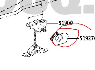

    I hope they changed it. My 3rd gen 4Runner was solid. A square end that funneled right into the mechanism. My 2022 has the flat hook that goes into a slot loosely. No guides. Nothing to hold it in place. When you turn the the tool it wants to slide out of the slot. If the 2025 is different, I would buy the entire thing if it were to bolt up somehow
    EDIT SO, I looked up the parts diagram. The guide is not on mine. Identified as 51927A. If I'm reading this right, that piece is not on the 2022. The guide part# is
    519270C010
    Carrier part # on 2025 is
    5190034070
    Carrier part # on the 2022 is
    5190034060

    US
    2025 Platinum Windchill Pearl with AVS
    51927A is the part i have on 2025 which guides the tool in.

    I literally just uploaded that picture. Mine doesn't have that and the guide just slips right out Fing frustrating

    Why just not to buy part # 51927A and be done with it?
