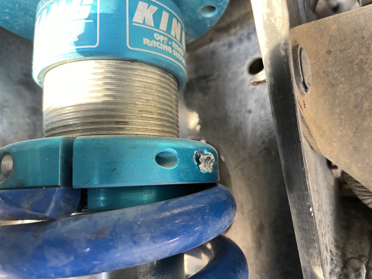

    What’s the lowest I can crank down these shocks? I was leveled but I’ll be towing so I want to lower them for natural rake in the back. Has anyone brought them back down to stock height or close to?

    Doesn't look like you have much room left to lower but hard to see from that angle.

    That’s how it looks leveled, it’s just the angle. I just wanted to see who has done it cuz I have read people say you can’t take them down to no lift but I’ve read people say you can because they are from king for 0 to 3 inch lift.

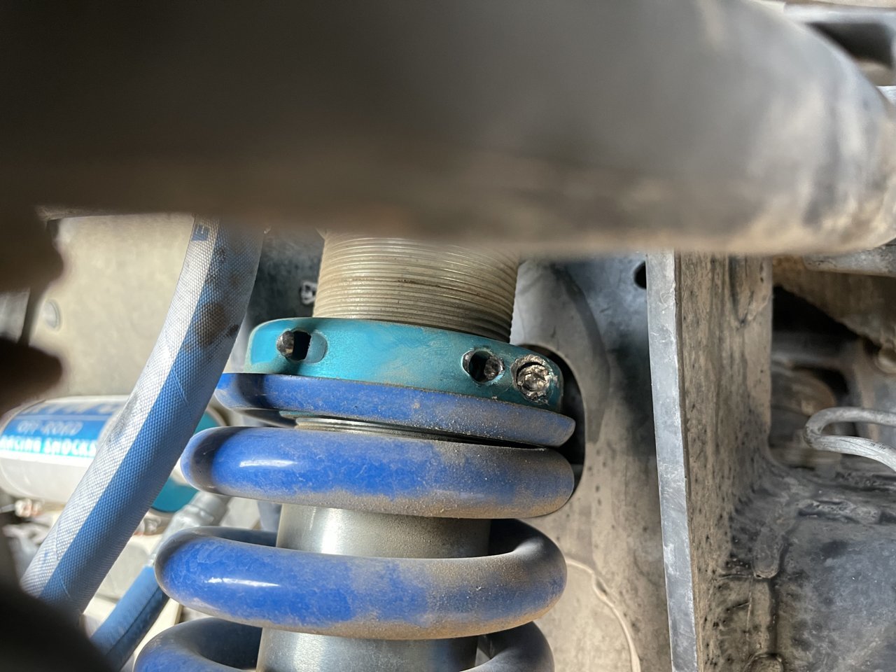

    Thank you @AccuTune Offroad, unfortunately a shop I thought was good recently did some work on my truck and this is what they did. I should have lowered the shocks myself. Both D and P side shocks the nut where you loosen to turn the collar is shot, smh. For those in CA, the shop is in Hesperia called Aztecha Revolution Offroad, don’t go there. They told me they would order me new collars for both shocks, until that order is received and they fix my shocks I will change my view but as of right now I will tell people don’t go there. The tech should have said something about it, I did my own inspection and found the problem, poor customer service, they never said sorry too or felt bad about their screw up.

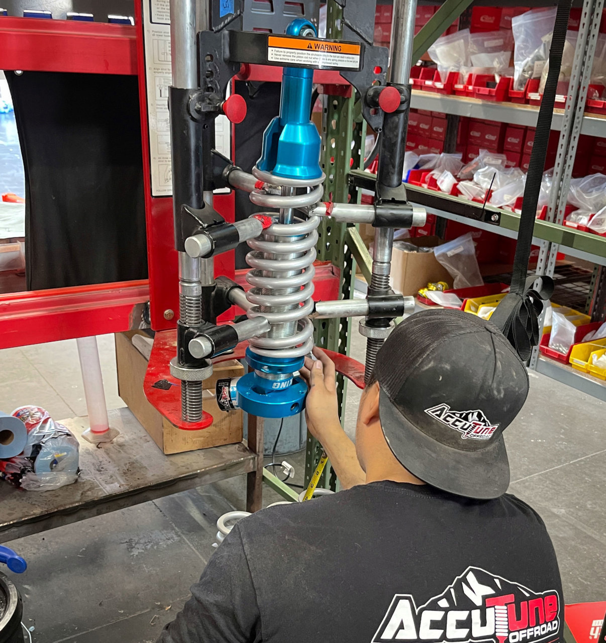

    Ouch! That coilover was definitely adjusted while on the truck. This is one of many reason we suggest removing the coilover and putting it in a spring compressor. I would encourage you to have them replace those preload nuts if they are able to, which is also a concern. Replacing those is not easy, and requires to the shock to disassembled pretty extensively. Shoot us a message if you have questions about the specifics. Below is a photo of the spring compressor we use in the shop just about every 30 minutes, every day of the week.

    ouch...yep..they adjusted it like a Tacoma...and that doesn't cut it for a Tundra. Best is to remove the coilover as recommended by accutune
    might as well get a tune from Accutune if you send the Kings to them ;)
