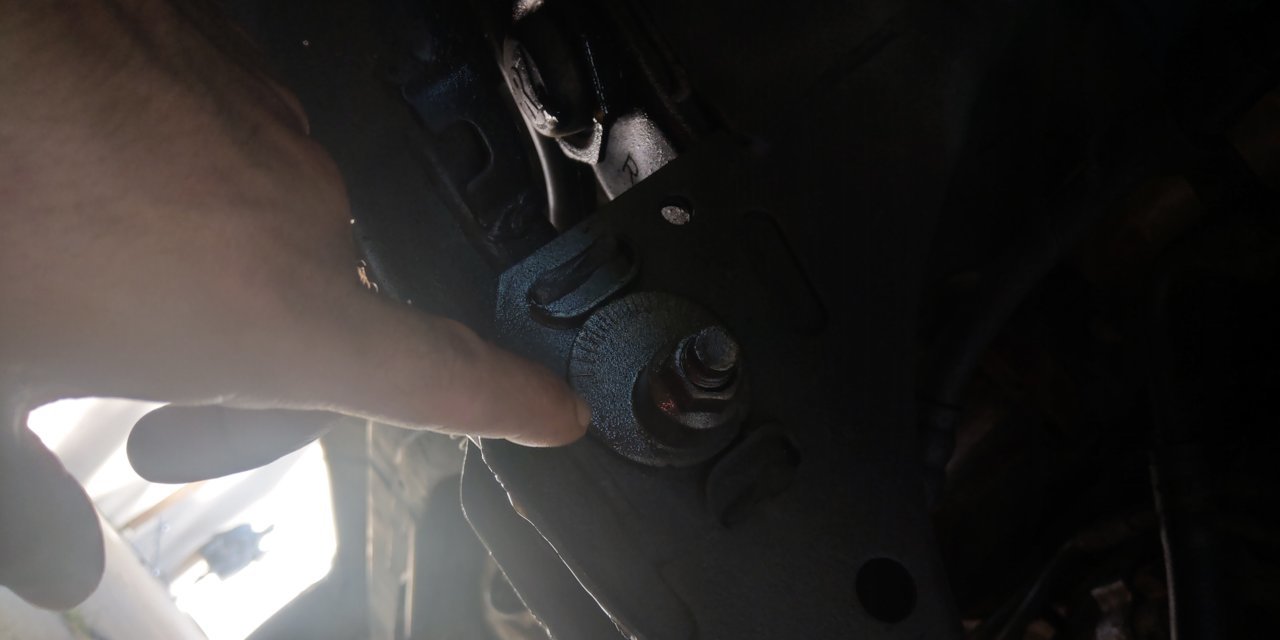

    Ok this bolt?

    That screw is not budging

    The other side of that, yes.
    That side in the picture is the cam plate. It turns the whole cam as one piece. The bolt is on the other side and screws into the plate.

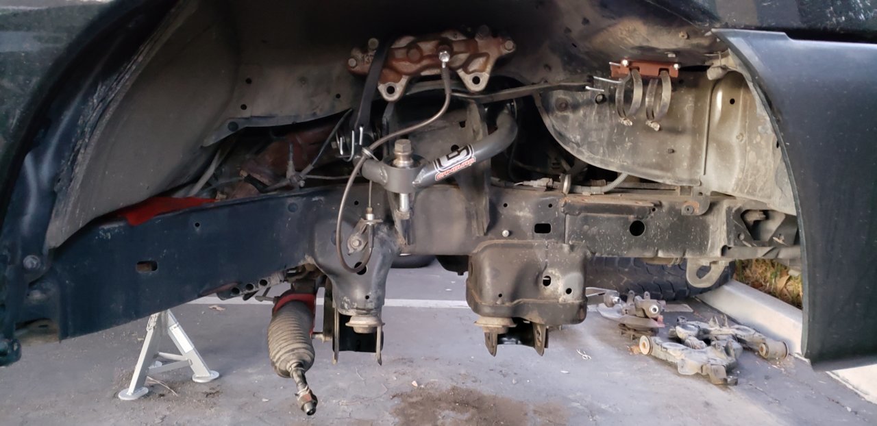

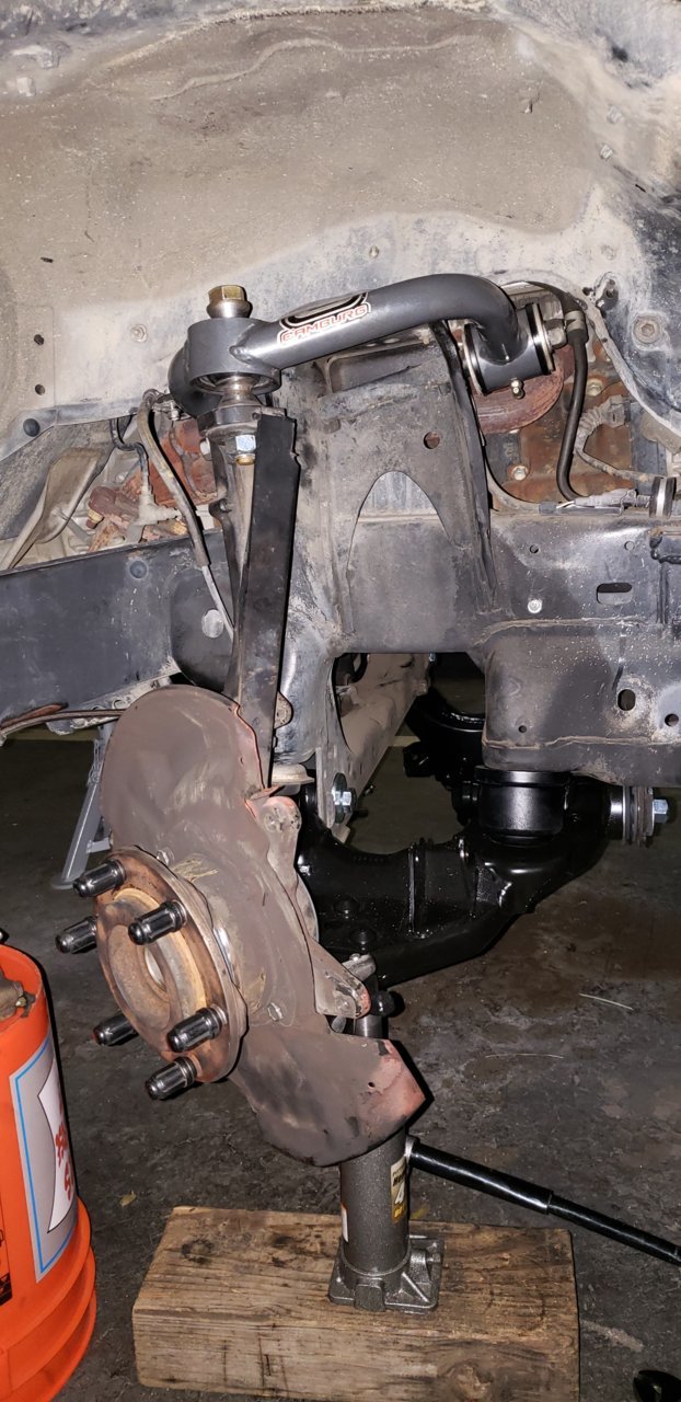

    Depends on a few things. When I replaced mine I bought aftermarket lower arms that had new bushings in them. It wasn't too bad but does include taking just about every suspension part off the front end. If you live where rust is a thing it can require cutting the cam bolts off, worst case scenario.
    It is a great time to replace lower ball joints. Its hard to get them disconnected from the lower arm without destroying them. Outer tie rods have to be disconnected. If cam bolts are damaged and cannot be reused, add them to the shopping list. A company called SPC makes a budget set of alignment bolts. Your parts cost will depends what you get and what brand you get. I think I paid around $120 each for Beck Arnley brand lower arms.
    Here I had removed everything but the upper arms.
    Here it is put back on, minus the coilovers, brakes, and swaybar
