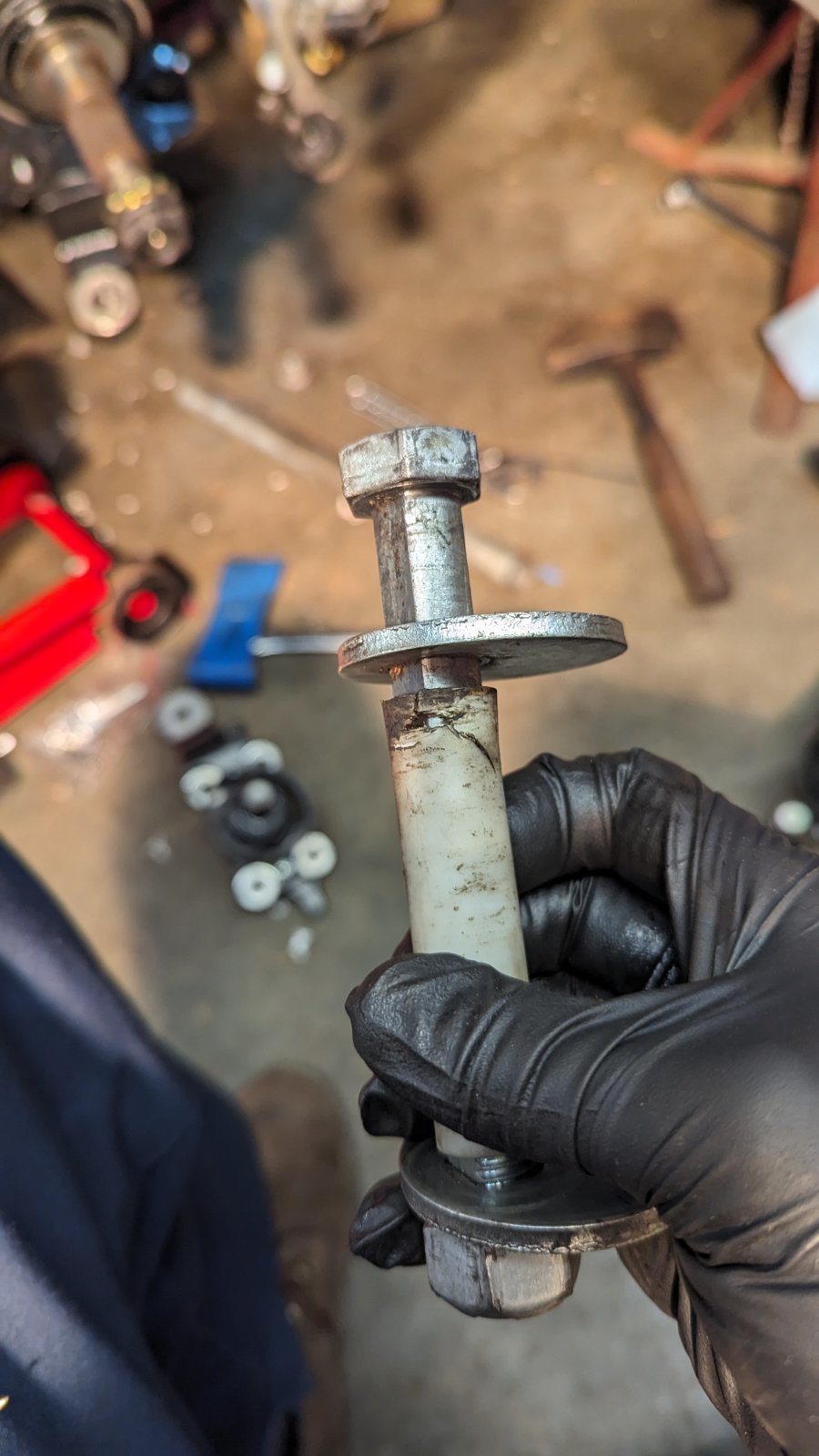

  11. Mar 6, 2024 at 7:54 AM
    Pnwtundy
    Pnwtundy New Member
    Sep 17, 2023
    #104046
    101
    04 DC SR5 TRD, V8/4WD + LSD/Tow
    Please heed the advice of these guys and spend the extra money for OEM. The previous owner of my truck did not. I'm not sure how long they were installed, but the bolts were still in very good condition so I'll assume not very long. OEM sleeves will never do this!
