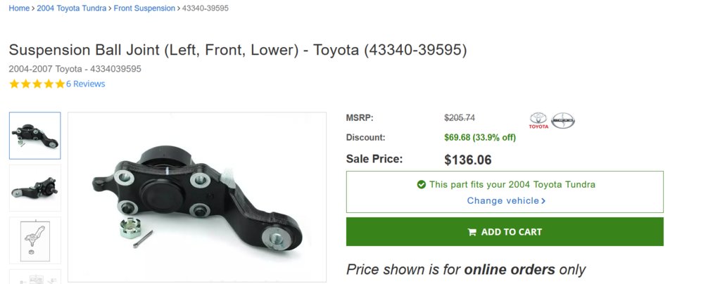

    Put this into Google.
    43340-39595
    Though I would replace them in pairs.
    43330-39825 is the right hand one.
    That should give you several dealers. Ignore Amazon. Of course, verify the part with the dealer.
    ETA Don't forget to ask them for the bolts too. 4 per LBJ. Also ask if it comes with a replacement castle nut and cotter pin (Mine did with those part numbers)

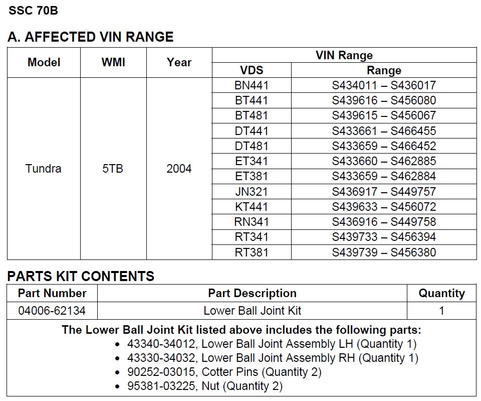

    *** 2004 owners that are within the below VIN Range follow SSC 70B for parts ***

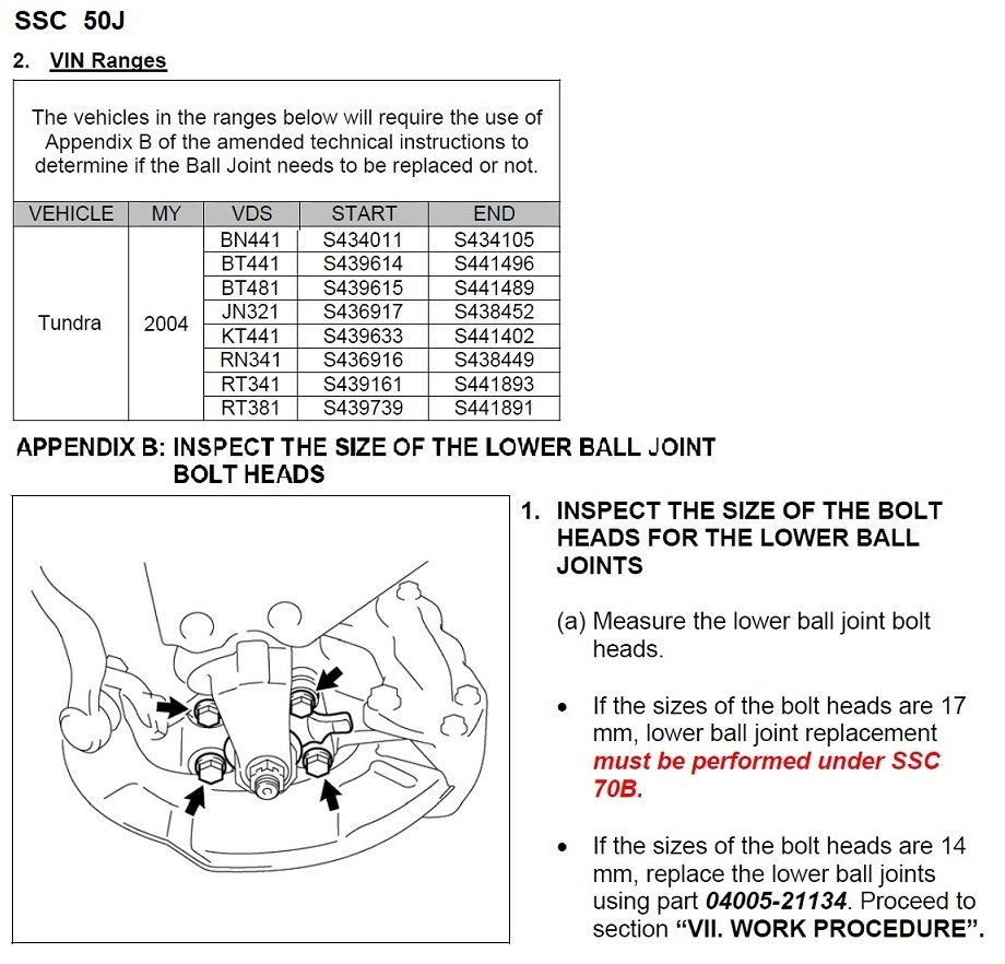

    *** 2004 owners that are within the below VIN Range follow SSC 50J for parts ***
    which is where the 14mm and 17mm come into play.
