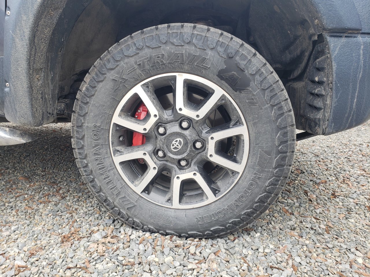

    My new (to me) 2009 came with a new set of brakes and tires. I am assuming that the valves are not pressure sensor valves and thus, the light. Any way of turning it off?

    Toyotas TPMS are valve stem, easy verification. Valve stems silver or black?
    Otherwise, try resetting. Driver lower right knee panel.

    You have a rubber stem in the picture. They likely removed the TP sensors, if my sight serves me. I think* the only way to have the light shut off permanently is through the dealer, unfortunately.
