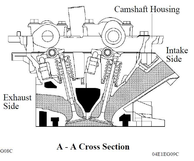

    On the 5.7, the rocker pivots are hydraulically compensated, no adjustment.
    On the 4.7, shim under bucket requiring camshaft removal to adjust clearances to spec. My 2006 with 4.7 had 225,000 miles on it and never needed adjustment (thankfully).
    Cross section of 5.7 cylinder head:
