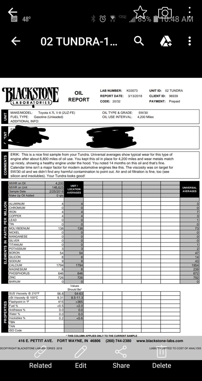

    I asked Blackstone labs this exact question when I sent in my oil sample. They said time is not an issue like it was in the past. That's an old school myth at this point.
    That being said, I probably wouldn't go much longer than a year.
