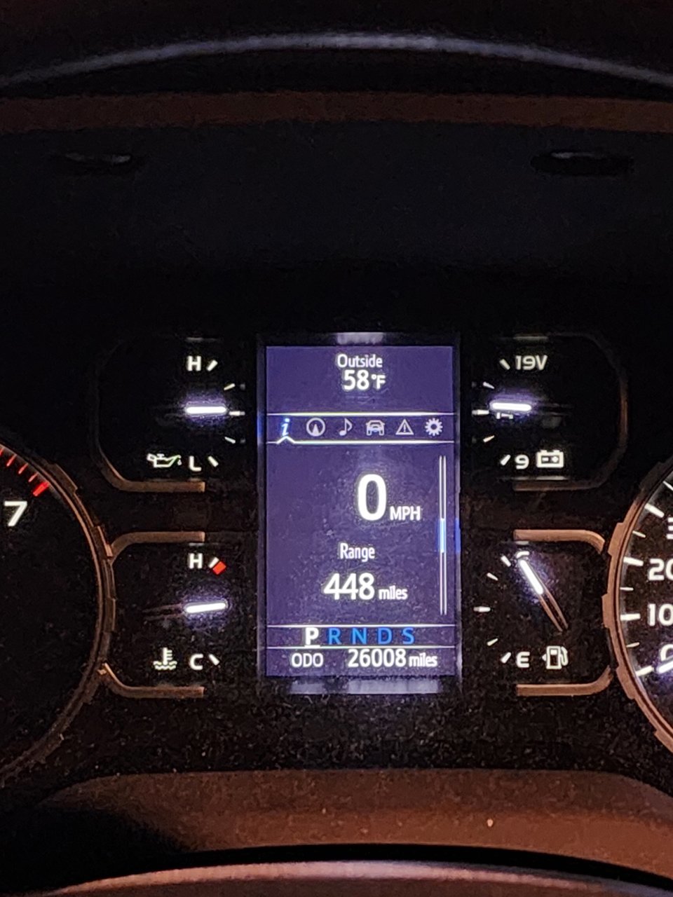

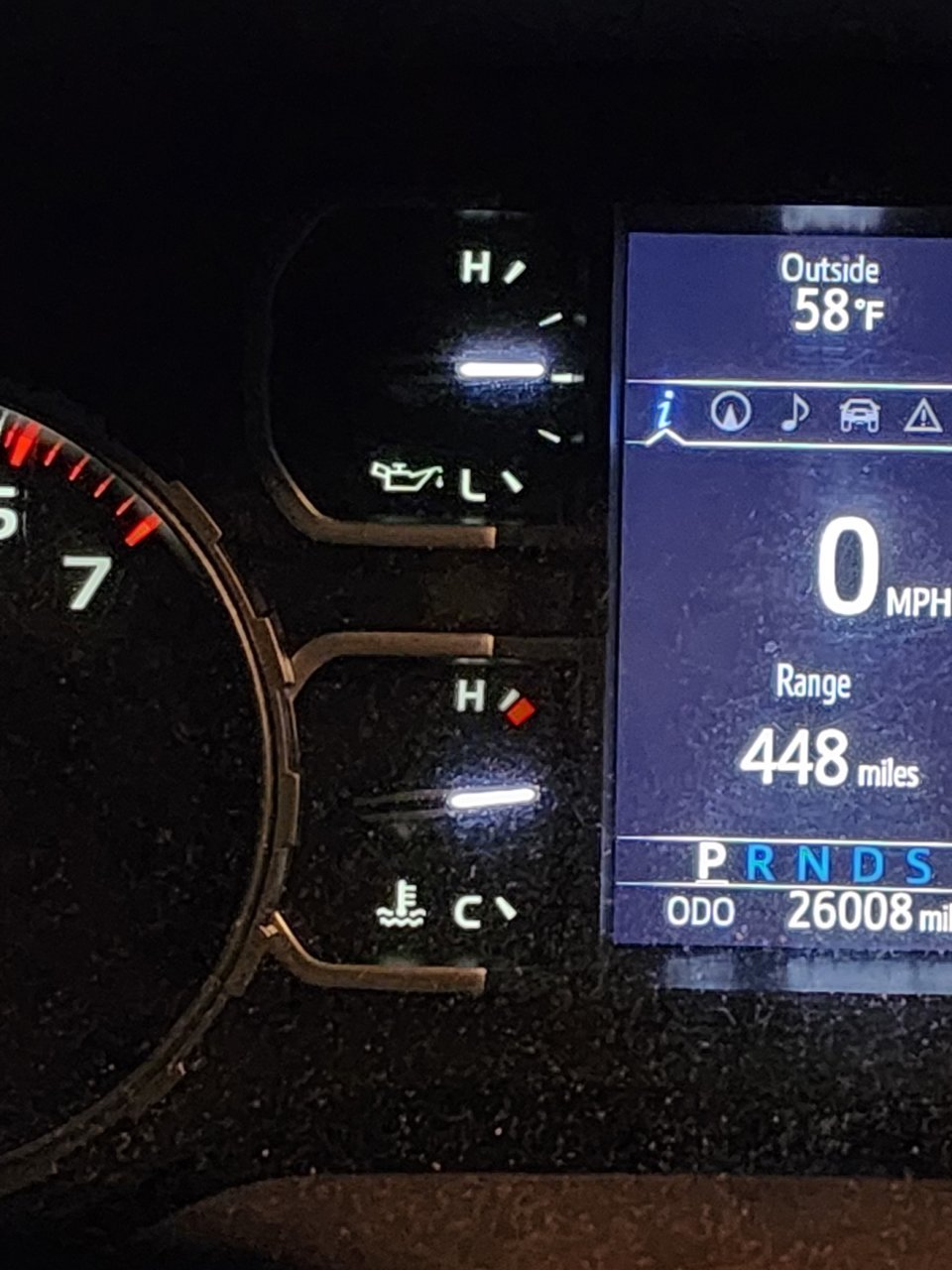

    Ok so I just noticed this but my coolant temp gauge is slightly above the halfway mark. I could have sworn it was always at half before. I noticed this before I drained and filled with new coolant but it's still at the same spot after the drain and fill. I drove it around town and hit the highway for about 25 minutes and the temp gauge stayed at the same spot. It's not like 3/4 of the way up and it's not spiking or anything just slightly above halfway.

    Weird. Your oil pressure and voltage are a bit high too. I'm usually showing a bit under half for oil pressure once warmed up and at speed. I've never seen more than 14 volts.
    Then, of course, who ever has a full tank??!!
    Might be worthwhile to get an OBDII reader to see what your actual coolant temp is. I'm usually around 185-195F and just under half on the gauge. If your motor is that hot, i would figure that fan would be howling unless you have an air pocket in the system.

    Did you burp your coolant after the service? Air pockets will cause low flow and you will run hot

    I burped it for like 45 minutes with the heat on max and the radiator fans were definitely going. Squeezed both radiator hoses after revving it up to 3k rpm for 10 seconds every couple minutes. It was at this level before I did the drain and fill too so I'm not sure what it could be. The a/c and heat work fine too.

    I feel like this may be a dumb question but does it start at the bottom when the engine is completely cold?

    Yes it starts at the bottom and goes up as the engine gets to operating temps. It gets to a little past half and stays there once it gets up to temp.

    Gotcha. Just ruling it out that it was a faulty gauge.
