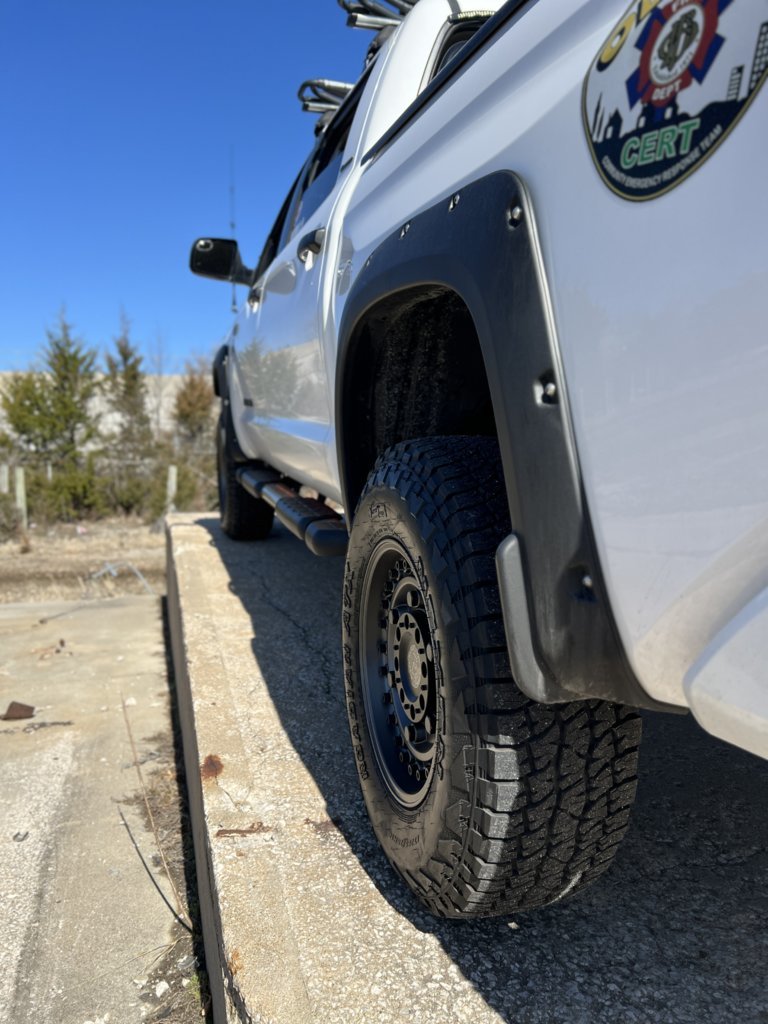

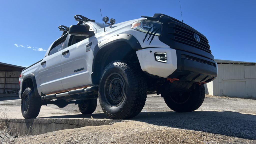

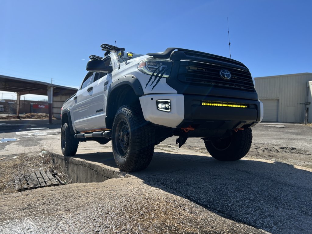

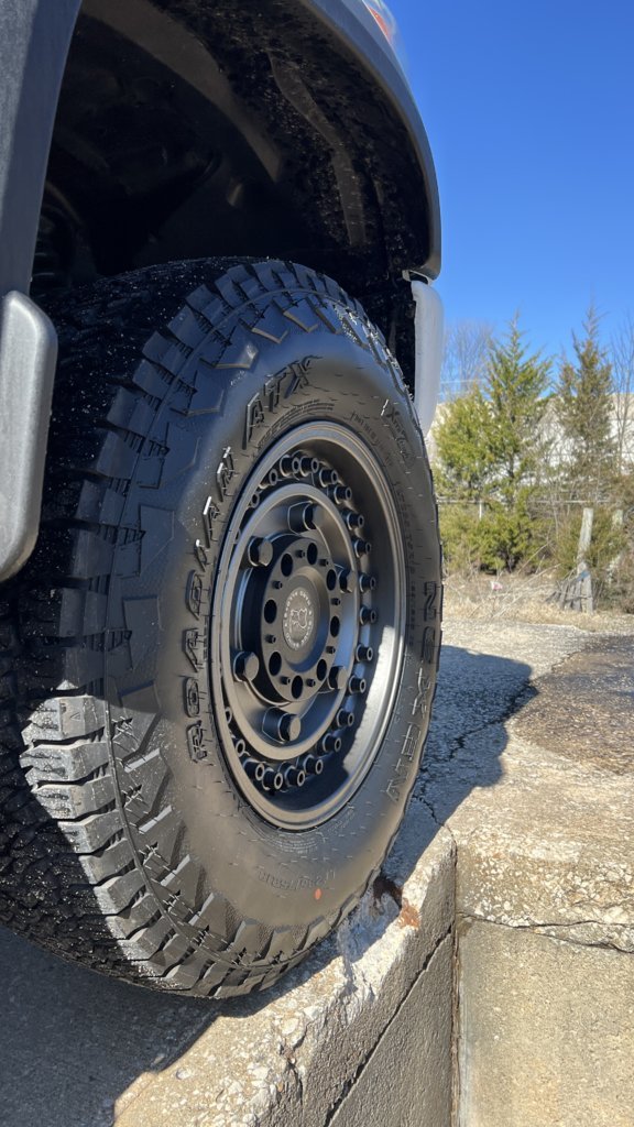

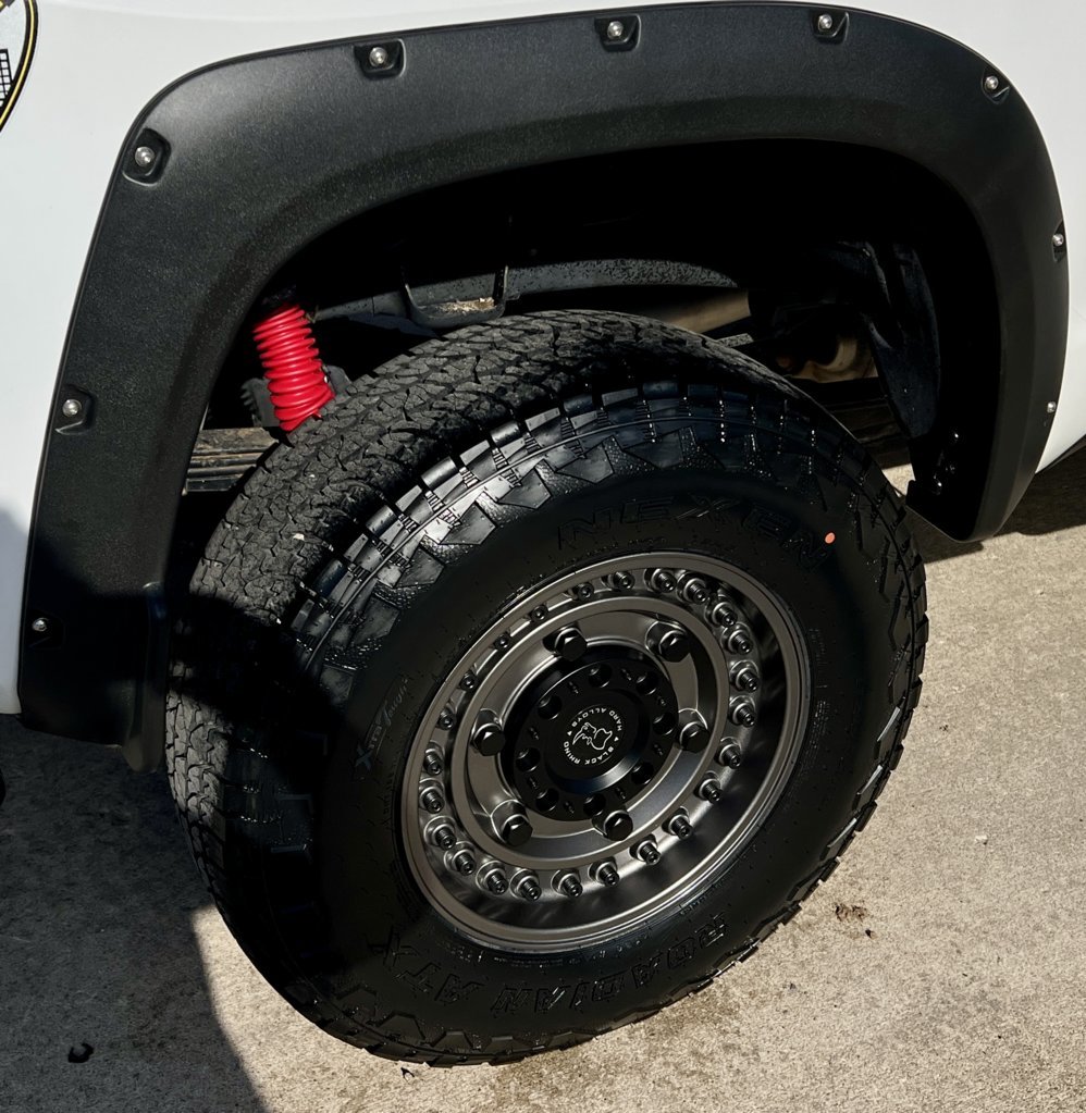

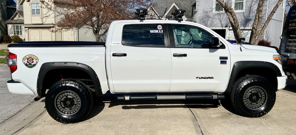

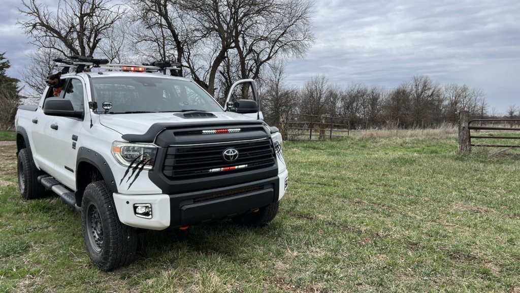

    I have had some cool vehicles, but never splurged on fancy wheels… until now.
    BUT as I explained to my wife…
    I NEEDED THEM…
    and the 35” tires.
    I volunteer time as a K9 SAR handler, which takes me off road, through ravines, plowing thru muddy pastures, splashing into creeks, over embankments, across dams and all the nasty places in between.
    I wanted (needed) LOW maintenance; no chrome to polish and no shiny gloss to polish…
    I have a motorcycle for that nonsense.
    The Tactical-Military look is, IMHO, just simply BAD A$$ looking. However, very limited to what will fit a 110mm hub and 5x150 lug pattern.
    That left me with the Black Rhino Armory in their Tactical lineup.
    Ditching my OEM 20” blahhhhh wheels for smaller 18” wheels with perfect fitting LT285/75R18 Nexen Roadian ATX tires on a positive 6mm offset set them big rubber sidewalls exactly inline with my 2.75” Tyger Fender Flares.
    Today I washed them good, applied Chem Bros. Ceramic finish and Chem Bros. Tire treatment and them rims and rubber look pretty fine!
    THANKS TO THE PLETHORA OF INFORMATION provided by guys/gals just like YOU!

    Looks good.

    Don't you need a bed mounted 50-cal to run those wheels?
    j/k, they look good on your truck. :thumbsup:

    Love those wheels. Almost got a set myself

    Curious as to what each rim weighs. Is it a big increase from a basic rim with cutouts and less hardware?
    They look great!

    First I made an error, they are 18’s not 17’s, whooops.
    The Armory wheel is 39.38 lbs. and the NEXEN ATX tire is 67lbs.
    Not sure of the stock OEM 20” that came off.
    It did take a me a trip to GOOGLE to figure out how to remove the Armory!!!
    There are two allen head bolts that attach the plastic hub and lug cover… glad I didn’t continue prying and break it like I have heard others do!
